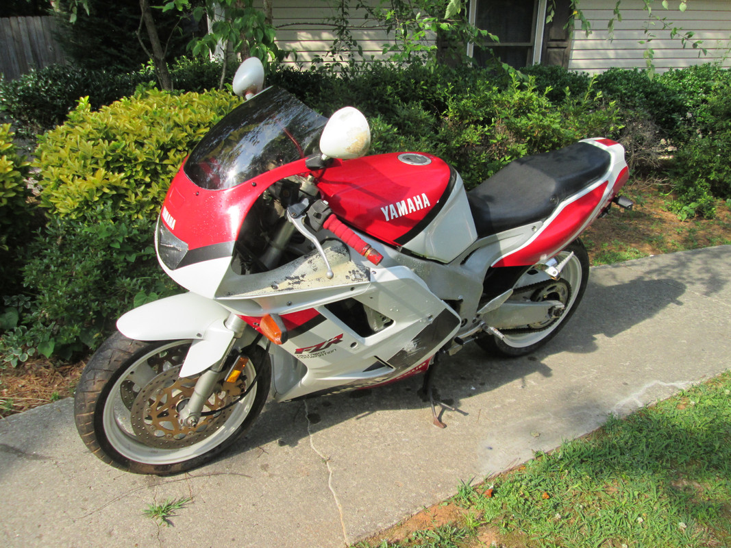

                          FZR Update: Parts, Parts, More Parts
                          Well I've got parts coming in from all over the place and the UPS & FedEx guys are going to be busy at my house.
                          • New Pirelli Diablos are on the way from California
                          • A new rear rotor is enroute from Taiwan ($50 vs. $250 Yamaha)
                          • The correct factory OEM ExUp Exhaust is coming from Minnesota.
                          • Still trying to find an OEM muffler/silencer (darn thing is WAY TOO LOUD)
                          • Fuel pump coming from Caltric....
                          • Proper Carb rebuild kits coming from China ($40 vs. >$200 here)
                          • Owners manual coming from somewhere in US.
                          What's been done:
                          • Petcock, Fuel sensor, all fuel lines and clamps & filter all replaced with OEM (Damaged with gas sitting over 5 years.... (See photo).
                          • OEM color added back to the gauges, supports, and grips.
                          • Front and rear brake pads replaced (needs a rotor thanks to metal on metal).
                          • Radiator hoses and OEM Yamaha temp sensor (OUCH! that one was pricey ). Hoses are long discontinued but Summit Racing had some 1" heater hose that has done the trick.
                          • Complete cooling flush too. Had some AUDI coolant handy....Yamaha doesn't seem to mind..... Might just replace the water pump haven't pulled it but being a little cautious can't hurt
                          • Oil & filter has been changed twice to assure all the muck is predominately gone.
                          • Replaced front badly damaged turn signals with re-pops
                          • Replaced rear tail lamp (badly melted by loose bulb) and installed LED bulbs.
                          • Replaced rear fender - MIA on purchase. Had been removed apparently to "Cool Up" the bike.....STUPID!
                          • New Battery - Maintenance Free Model
                          • Clutch Master & Slave completely rebuilt with new seal kits.
                          • Chain guard replaced (brackets found in Germany couldn't find here) was MIA on purchase.
                          • Tank completely cleaned, degreased, and liner installed.
                          • Repaired a couple fairing cracks and one decent size hole using 3M Structural Repair/Bond Kit.
                          • Cleaning, Cleaning, More Cleaning, and More Cleaning yet to do.
                          What I have even started on:
                          • Need some SS brake lines as these are all OEM 27 years old..... not so many options for these and it seems only folks in England sell them.
                          • Front calipers need a rebuild.
                          • Front forks need dust seals, a good cleaning and some new oil (hopefully that's it)
                          • Want to add the European style lamp they have on theirs. They refer to this as a "PARKING LAMP?" fits in the little hole above the main lamp. In the USA these just got a small filler panel. The European LEFT control also has a lamps off/on/PARK setting we don't have here.... Thought this would be cool to add an it is "OEM" (sort of).
                          • Gotta find control cables for the ExUp valve in the exhaust (once the header arrives from MN). I have the Servo motor it was left in the bike but the previous IDIOT removed the fancy OEM exhaust that helps produce more low end power in favor of a noisy a$$ D&D header... DUMB!
                          • Would like to buy the rear seat COWL? They offered in Europe for this model. Covers the rear seat section and looks pretty cool. I THINK this was an OEM option.
                          • Would like to figure out how the heck this fuel system is SUPPOSED to work (hence the purchase of the operators manual. Apparently, the switch on the left (On/Reserve) turns the fuel pump off after the sensor (see photo) says "None up here". Switch to reserve to suck the tank dry? I GUESS that is how it works. There is no fuel gauge. Guess this is why there guys are always popping the cap and sloshing the bike back & forth to look in and see. Come on Yamaha? Even my 40 year old XS11 special has a lamp to tell my dumb a$$ we're getting close to the bottom
                          • All the wheel bearings will need to be inspected (at least) lubricated and all the seals are going to need to be replaced as a safety measure.
                          • Gotta find a decal kit to replace all the damaged decals and repaint as needed.
                          • Chain and sprockets look good (for now) but the factory rubber guide for the swing arm is needing replacement as it is gone (OUCH! $$$ from Yamaha still available). That's the rattly noise heard in my videos. Gotta pull the swing arm to replace that so there are some more bearings that will need the once-over at least.
                          What is the cure for this disease of buying these old (and beautiful) machines only to spend countless hours and $$$$$$$ fixing some other idiots dumbness? Darn I LOVE this bike.... It does move like a scolded dog.
                          Before instruments have the KIDDY touch!
                          After instruments have the OEM look. New grips with just a touch of red rather than those big fuzzy red ones. Bar end weights and fairing support repainted the proper black rather than the KIDDY TOUCH red
                          Look at the damage gas did to the aluminum of this fuel sensor...
                          (old vs. NEW $$$$$)
                          Rear Brake Pads..... YEP! He ATE THE ROTOR!
                          This machine is REALLY COOL! Don't need to do more than pull a couple pins and replace the pads (front or rear) in like 5 minutes!!!! But instead, the previous "DUMMY" ground the brakes into the rotor!
                          This must be some sort of "Racing" set-up transferred to the street screamers as this quick change brake system is new to me. I'm GUESSING the racers change pads like they do their tires to meet road conditions and tracks etc.
                          That's it for now.... Any thoughts???

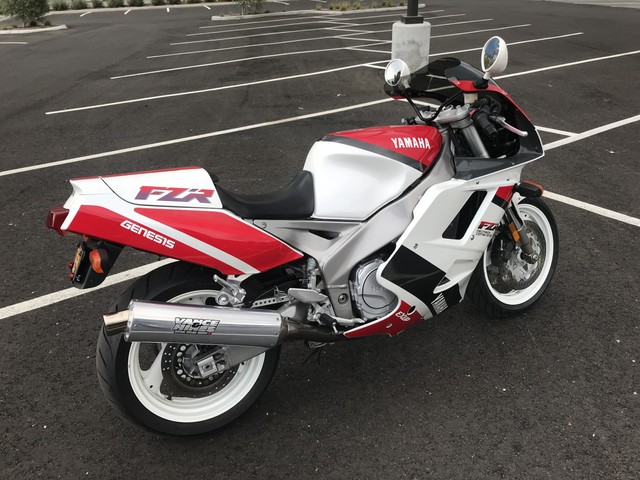

                                I'm hunting ENDLESSLY for a rear seat "COWL" like the one shown here. THIS IS NOT MY BIKE...... I WISH! This one has only 6500 miles and is the bike of a member from the FZR site I have joined...
                                I love the look of this as a single-seater. The seating configuration is questionable for anyone as a passenger and Nancy will certainly not "Fit" up there. So, the addition of the COWL is preferred....
