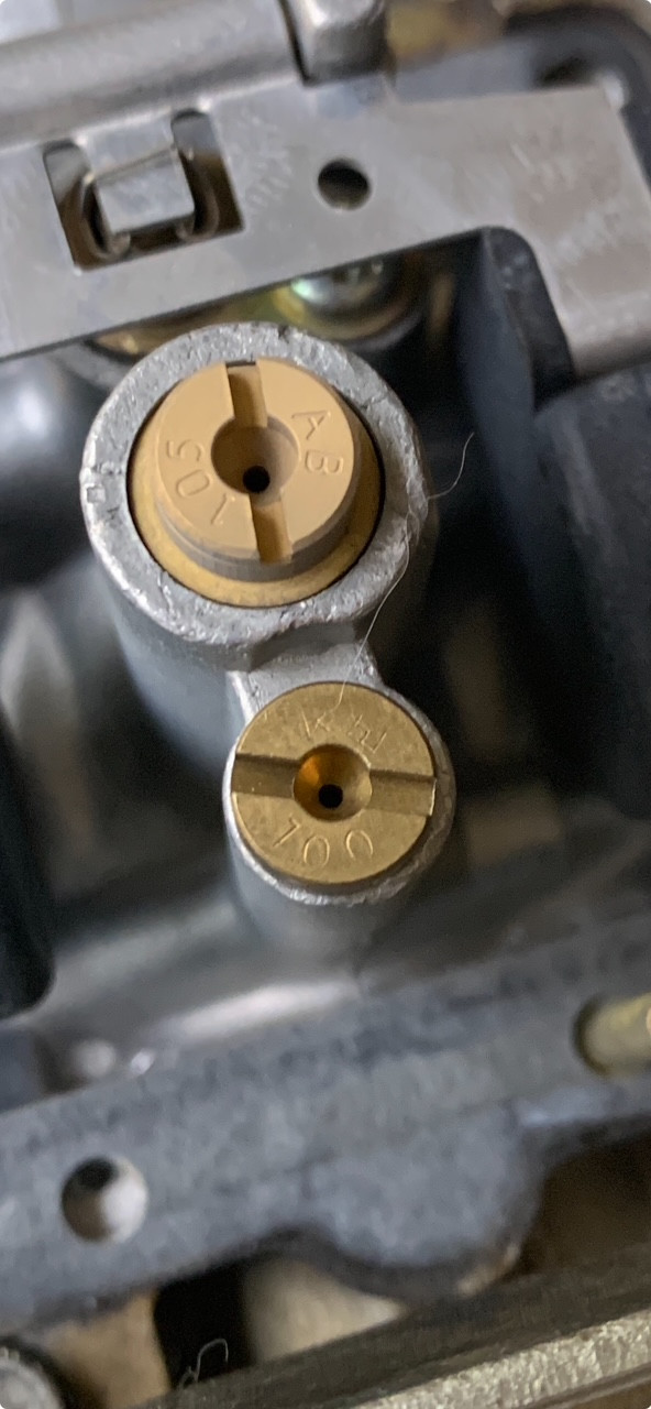

                            ...and wth? The mains I have ...that I thought I took out... are 100s? Nah, can't be. Maybe I bought 100s too!!!? Farkle! Now I'll have to dig deeper in my stored boxes of cr*p and see if there are 110s somewhere. For now I ain't gonna touch 'em.
ID:	883577 Click image for larger version

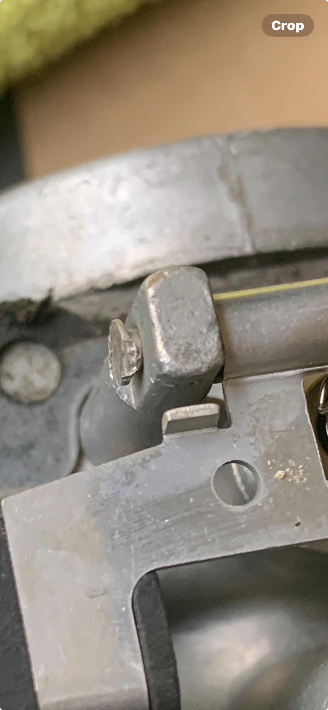

                                Hmm. The float posts on the left side of the bike ( I'm calling 1 and 2 ) look untouched...while 3&4 seem to have had a tool on 'em. #3 especially Click image for larger version
                                Number 3 Click image for larger version
