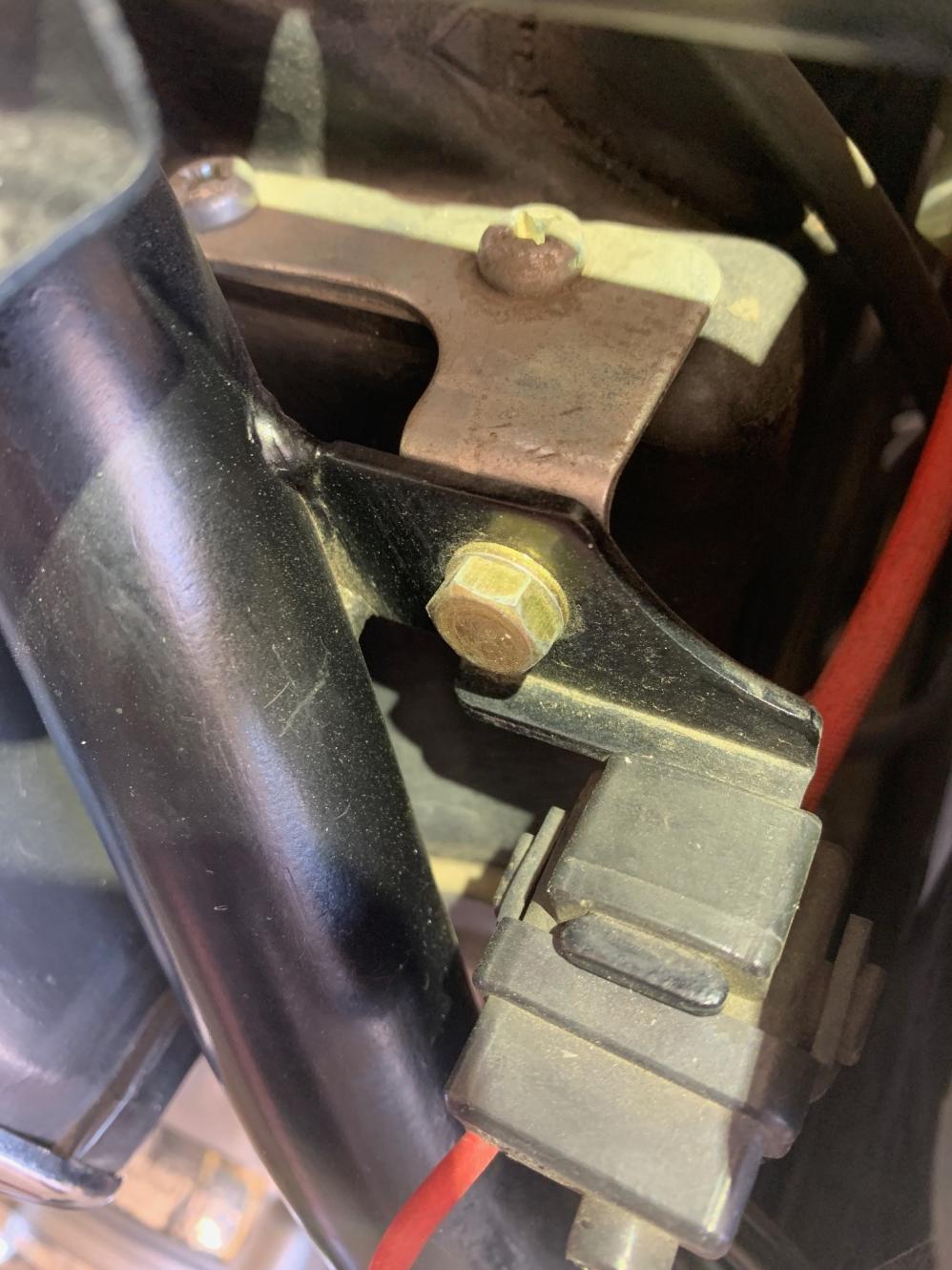

            YAY! Found two things-one, the rubber gasket I couldn't account for after spilling out all the screws and fasteners of the air box ( was laying on a rug behind the bike ) and two, a PICTURE of where I suspected it should go- under the brackets held in by the two philips head screws. For me, a major victory! Click image for larger version

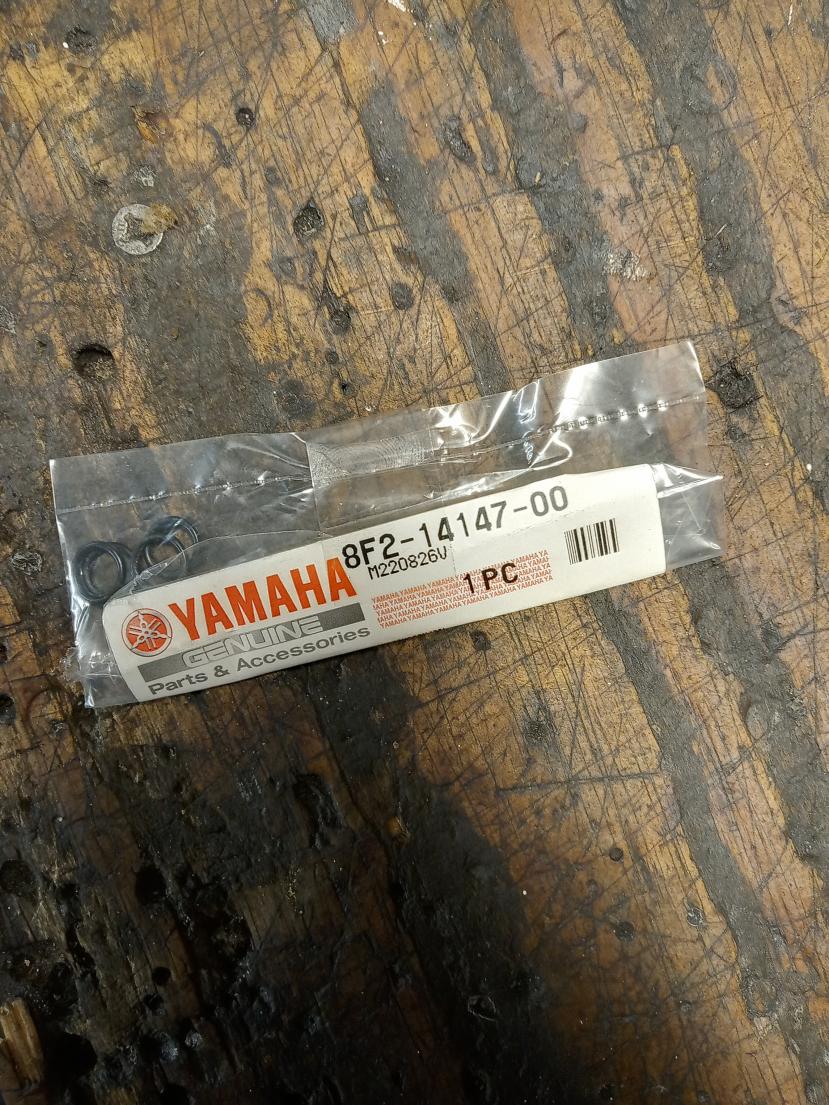

                  I only use the genuine Yamaha on those seat O-rings, P/N 8F2-14147
                  Soak the hell out of those seats with penetrating oil before trying to pull them out. I've even needed to heat them with a torch to remove them before. Be careful of the float posts.
                  So I've got Blaster and those seals ( Partzilla ) on the way...
                  "Hey Jonny, you can reuse the needle seats if you polish them. Cut a Q-tip in half, put it in your drill, apply chrome polish and buff the inside where the needle sits. Also clean any deposits off the needle itself and visually inspect. New ones aren't cheap (the good ones), but the o-rings are."
                  Is there a specific video tutorial on replacing those anywhere online...and polishing the seats? Just asking so I can get my box of Crayolas handy.
