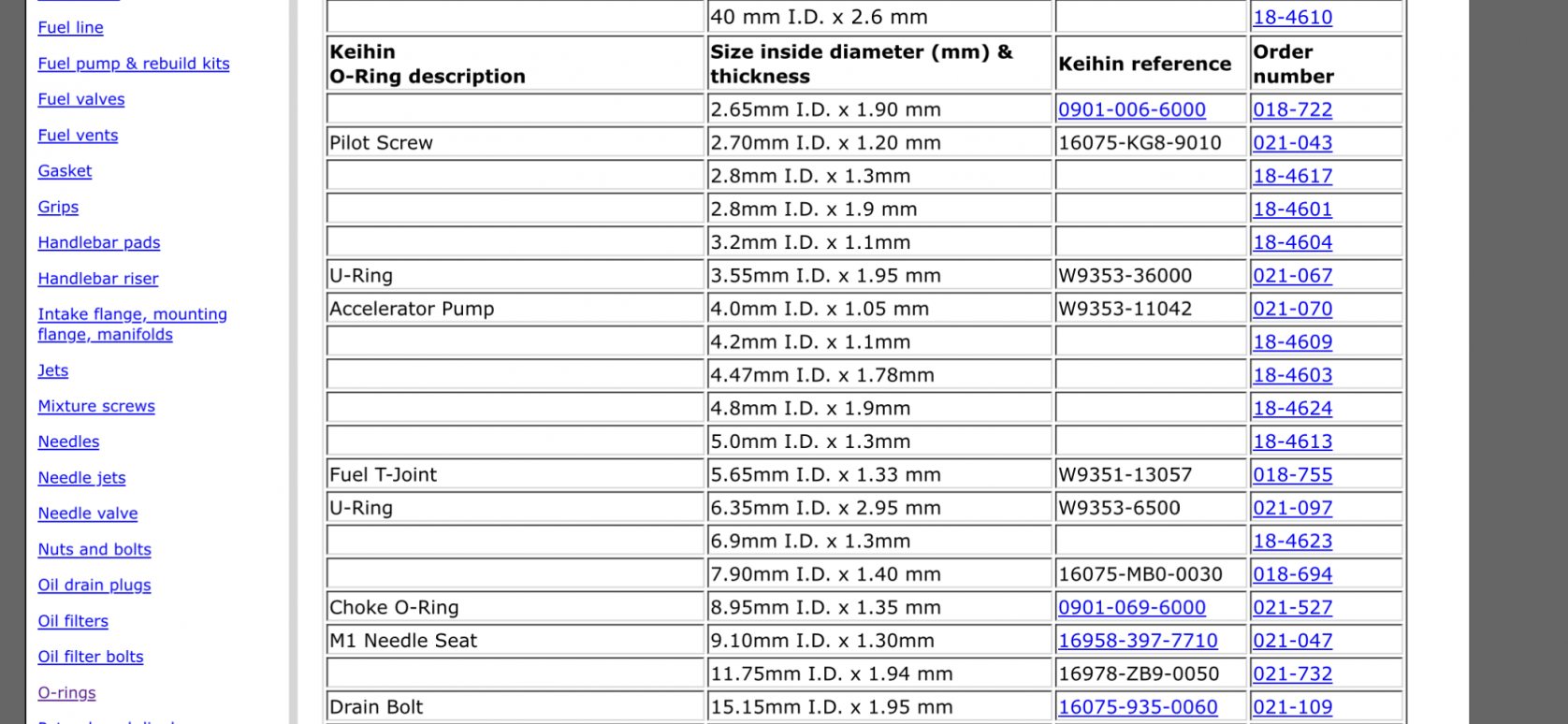

    Jonny I’m going through a carb rebuild for the same reason as you, leaking petrol into the airbox. Looking at jetsrus I’m unsure which is the correct O- ring for the main jet. Is 9.1x1.3 corrrect?

      Nope! I think this is the correct needle valve seat Oring?
      BSR-36 Float needle valve seat 7.5mm I.D. x 1.53 mm

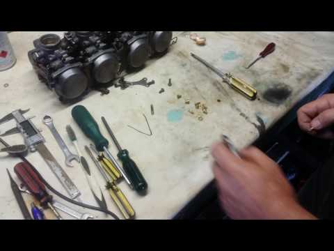

              Iffin yur feeling a bit reluctant to do a total tear down, clean, rebuild, adjust, install, and RE-adjust a set 4 (fower...) Mikuni BS-34 Constant Velcity CaburatatorZ??! ヾ(゚д゚)ノ゛
              Then imma gonna say there's prob'ly a good reason on yur side of thingz. (/。\)
              I means, ya don't R E A L L Y knows what yur in fOaR and wut to expect OaR DO as it's a "first time thru the Gate" scenario. Iffin that's the case then I heartily recommend you DON'T. Just DON'T. ε=┌(;・_・)┘
              There's only so many of these carb banks left and nobody wants to see the bank (and therefore the entire bike...) useless cuz of ruining one....just ONE carb body due to being HAMHANDED 'bout removing a float post, jamming the wrong size screwdriver into the pilot air jet hole and cracking the horn, OaR boogering up the idle fuel screw tip/hole. (-‸ ლ)
              I would totally support you taking NO action at all considering at this moment yur deciding NOT to do anything cuz you KNOW that you DON'T know wut you NEED to know. (︶︹︺)
              BefOaR making a final decision to act OaR not to act? (O_o)
              You might find the following useful-
              https://xs11.club/forum/repairs/carb...b-cleaning-101
              https://xs11.club/forum/repairs/carb...-1980-81-carbs
              This video channel has the mostest detailed and useful videos in this area that I've EVER seen and I've used them as my own guiding light.-
              Know befOaR you go.... ( ゚_ゝ`)
              OaR DON'T go if that ends up being the case. ¯\_(°_°)_/¯
                                That translates to a JIS (Japan Industry Standard) S8 o-ring, meaning it's a common standardized size (JIS S8) Many auto parts stores keep assortments of single orings behind the counter, they're all over the place in systems that use fuel injection and are labeled by they're standardized size.
                                Long and short of it, head to an auto parts store and ask if they have single orings and ask for a JIS S8 o-ring, probably won't cost more than some pocket change.
