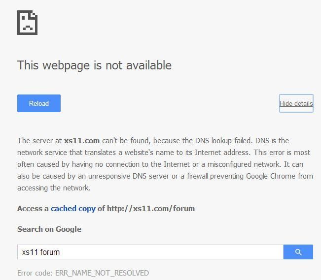

    About 9 out of 10 times when I try to get on this site, I get this...
    It happens to all 3 computers here at the house with 3 different operating systems on 4 different web browsers. Is it something with my router/modem or something with the internet company? It's done this with 2 different routers. I've not visited this website for weeks at a time due to this... which many may find nice. lol.

        The message is actually telling the problem in a subtle fashion.
        For the average XSive:
        There is a network problem and nothing you can do to fix it.
        It is not your computer or router or home connection.
        Oh and using the IP address previously posted will not work due to the method used by the provider to host the site.
        Why...
        When you browse to www.xs11.com, that address is translated to an IP address: 209.151.89.187
        This is DNS (Domain Name System)
        There is some geek stuff happening under the covers - worse than electrical carb issues :>)
        This site does not have a dedicated IP address so you can not just use the address.
        As an example, type this into your browser address bar:
        74.125.239.51
        These folks have a dedicated (static) IP address.
        This site has an issue with the way its DNS is configured and being updated.
        The failure you see is that www.xs11.com can not be looked up and consistently give an answer. The lookup fails and sends the error message to your browser.

          I have never had a DNS problem and I check in on the site almost every day. I suspect this may be an internet service provider (ISP) issue.
          As was mentioned before, many site hosting companies use a public IP such as 209.151.89.187 that get routed to an internal IP. In theory the public IP isolates the internal IP for security, but it also means the internal IP can change as long as the firewall routing (public to private ip) is modified. This happens quite often as servers undergo upgrades or new servers are created to replace old ones.
          However, the public IP should never change, or very rarely change. It is registered with the powers that be that control internet numbers, ICANN. If your browser cannot find the public IP it is probably not the fault of the hosting site.
          If your ISP has not updated the entries in their "forward lookup zones," or they are incorrect, the public IP numbers of the hosting service will not resolve correctly.
          There are also timing issues involved; a slow connection will "time out" before it can get an answer from the authoritative servers. This can give you a 404 (page not found) error.
          By the way, XS11.com uses the domain name services of a Denver-based company called Data 393. Web site is http://www.aboutus.org/Data393.net
          I would contact my ISP and tell them you are having a problem connecting to known active web sites and have them check their settings. You may also want to run a connection speed test just to verify your upload and download speeds; there are many free test available from the web. I use this one:

                        I understand where you're going, Jerry, but something has changed. I never got this message when I had even dial-up. I just don't think speed is the problem. If it were, it'd be a problem with other sites as well.
                        • ViperRon
                          • Feb 2011
                          • 1062
                          • Woodstock, VA
                          The problem is with the server supplying Domain Name Services to you. Typically when you have internet you either get primary and secondary DNS server ip addresses or the default router is used and that has a line to route you to their server. You can use the default configuration on your router or your PC and it will get the address for DNS from your ISP (internet service provider) the problem that often happens is the people who give you internet service are high demand networks and they have many things that can slow down response. They have different protocol's on how the information is routed and many tunable characteristics that can speed up or slow down service. They have programs to protect you from spam pop ups and viruses that have an effect on how fast you get response. If your response is delayed too long it times out and it is Not found.
                          A way around this on most networks is either get a good IP address and make an entry into the Host file on the PC but even this fails if the address of XS11.com changes. A different way is to cheat and use a high powered server on the internet to do your Name Services (Change name to physical IP address for the PC to find). To do this you go into your Adaptor settings TCP IP configuration for the network interface on your PC and where it asks about DNS services choose use preferred DNS and set primary and secondary to someone like Google Primary DNS 8.8.8.8 secondary 8.8.4.4. What this does is bypass your ISP (Internet service Provider) and get name to address service from Google. You can normally use any DNS servers that are accessible on the internet. Different releases of Windows use different screens for configuration of network adaptors you can use help to read up on procedure for your version by looking up (change DNS Settings and network) and it should give you the sequence of screens to go though. Hope this makes sense to at least some of you.
                          Do not USE a government or state DNS server address because if the network engineer at that site gets confused on why your PC is connecting to their network it may not be a good day!

                            It is an xs11.com issue
                            Folks have posted a lot of good information on DNS configuration and usage for the users PC etc. The changes suggested will improve overall performance, usage and stability but NOT this issue.
                            The issue is on how DNS is configured for the domain xs11.com.
                            The DNS lookup information is not being properly propagated across the internet. It still works correctly for some ISPs and the lookup techniques that they use.
                            This is an unusual scenario and may be a result of a change of the hosting provider.
                            The site admin needs to add an NS record.
                            Given the current records:
                            Code:
                            Source Of Authority (SOA)
                            SOA 	xs11.com 	ns1.neenernet.com
                            Nameserver records (NS)
                            Non-authoritative answer:
                             xs11.com	nameserver = ns3.vosn.net.
                             xs11.com	nameserver = ns4.vosn.net.
                            The server: ns1.neenernet.com
                            needs to be include in the NS records.
                            Some ISPs (internet providers) adhere to the standards and the current configuration is incomplete and may cause lookup problems. The SOA server should also be included as an Nameserver (NS) record.
                            PC configuration issues would affect all website look ups.
                            I see the problem when I use my Verizon 4G smart phone.
                            The phone has no ability for me to change network settings. The settings are all pushed from the Verfizon network.
                            I think Verizon would be strict on adhering to standards in their configuration.
