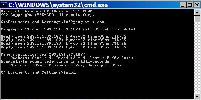

    There are several good TESTS that have been posted in this thread that you can try WHEN you can't access the site by just clicking on your browser's favorite XS11 link. Like the numerical IP address for our site....that you could save into a text/notepad file or even create a favorite link with it as the URL instead of the www version to click on.
    The other part....the PING test is also relatively simple. You just need to open a DOS prompt window.....in Windows 7, click on Start/Run, and then type cmd and hit enter to have the little window with the dos black screen pop up. Then type the "ping" command, a space and then first www.xs11.com as well as other sites, and hit enter.
    A longer report that can show you how many servers you are having to go thru to get to xs11.com is the Tracert command.
    And to save you a bunch of typing, you can have the Tracert program create a TEXT file of the results with this command:
    Be sure to put a space after the Tracert word, the www.xs11.com
    and make sure you have a C:\temp folder . And just change the name of the text file if you want to perform the same test with other websites for you to compare.
    tracert www.xs11.com >c:\temp\tracert.txt
    You can do the same thing with the PING command....I just did it with our site: What's interesting is the IP address is automatically resolves. I did the Tracert test last year when I was using Verizon, and before our site was put on it's separate server, and so the IP address is shows is different, I'll post that and a NEW Tracert report below this PING report.
    BTW, it takes about 30 seconds to perform the Tracert process...you can do it first WITHOUT the file creation portion to see how long it takes, and then repeat it with the file creation....when you get the same Dos prompt that you started with ...ie. C:\users\youraccount\_ with the blinking cursor, then you'll know it's done and you can then close the dos window.

      The text thing didn't work, but here's the tests.. for whatever it means. The 2nd half of your post seems to be some foreign language to me. And yes, Larrym and I still talk occasionally.
      • Jerry
        XS & TRUE XJ GURU
        • 3023
        • Elma, IA.
        Keep the tests handy when you call your ISP. It looks to me like the one time-out (Line #5 of the tracert) is when the connection is handed off from your provider (Cable0ne.net) into the wider web. There should not be a delay, or time out, in this handoff.
        Another piece of information your ISP may want is the IP of your PC. You can find this by opening a command prompt again (Start, type CMD, and press enter) and running this command: ipconfig /all and make sure there is a space between the ipconfig and the /all
        One of the numbers will probably begin with 192.168 but if you have more than 1 network type, including wireless, there may be more than 1 set of numbers. Look for the word "Primary" in the stuff that pops up. Your ISP may want to remotely log in and take a look at your settings. To do this they may need the IP number or they may want to start a remote session such as Webex. If so they will give you a site address to go to and won't need the IP. Keep us posted.
