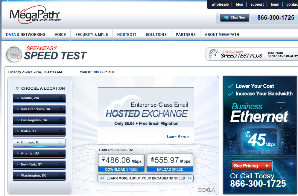

            Been trying all day to get back on here. Finally got on, did the speed test thing, and hit reply... "XS11 not available". (&*@%^$

                We have decent internet access speeds.
                Even at home I get near 100mbps (Usually upper 90s) download speeds and that is a cable modem line provided by Century Link. Trbig, it looks to me like your numbers are very low. I would contact my ISP and / or look at your contract to see what kind of throughput you are contracted for. I am not an expert on residential lines, but I've never seen a contract for less than 100mbps download speeds. Upload speeds are generally lower as ISP services are generally optimized for web browsing which requires higher download speeds. If you are contracted at a lower level I would find out how much more it would be to bump up your connection speed.
                I am guessing your connection is not receiving its DNS info fast enough and is timing out.
