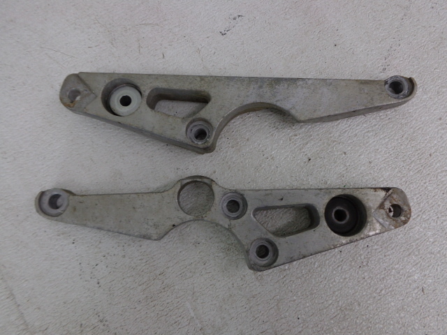

    Originally posted by BA80
    Don't know about the side cover thing but the peg brackets won't interchange. I tried it on the SF I had and the bolt holes don't line up. The standard frame is slightly longer and right there is where the extra length is.
    That's interesting. Thanks. How about interchange between a Special and a Sport? Anyone here tried that? Although I can already see the Sport bracket retains the higher foot rest position, just back a bit.
      Hi Marty,
      The US Specials and Venturer footrest brackets are the same as the Euro Sport 5K7, only difference is the SF's are plain without the decorative groove and, of course, the finish.
      The 5K7 Sport footrests are different than the 2H9 Euro Standard as they are more rearset.
      I'll be doing a well documented Euro conversion on my SF that will show how the Sport parts fit, starting a thread, in about a month or so.

        I look forward to following that. The reason I brought this up is because I recently rode an E. The pegs are lower than on my Special. At least, they sure feel lower. The seat might be up just a bit as well.

                  From the seat of my pants, to the sole of my shoe, and looking at the difference in appearance of the brackets, I'm convinced the Special foot rests are farther from the ground than the standard, and thus, closer to the seat. I'm sure the seat is lower as well.

                    The front footpeg brackets are all the same for the north America market XS/XJ bikes other than finish, and mount in the same place....

                      I know better than to doubt you. I was driven to my belief of lower standard foot position by the shape of the brackets.
                      E brackets
                      SF brackets
                        • 8083
