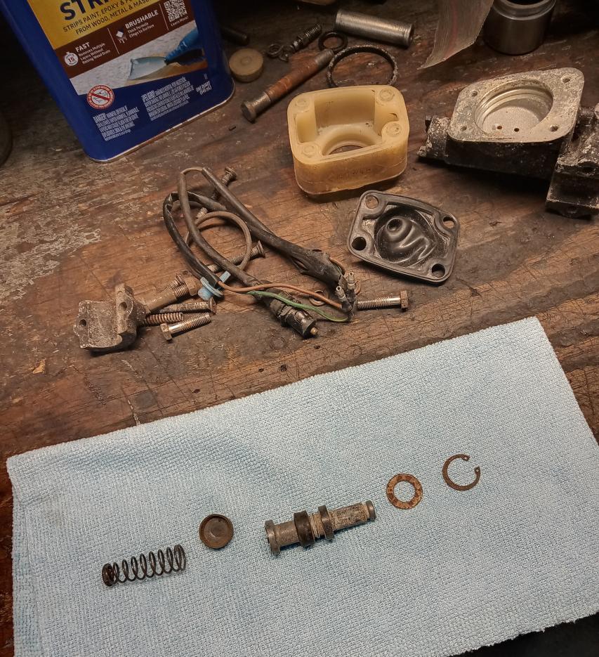

                    You can zoom in on this and it will give you some idea as to what order things go in. Yamaha Motorcycle 1980 OEM Parts Diagram for FRONT MASTER CYLINDER | partzilla.com
                      I'll see if I can take one apart and take a pic of it.
                      Front master cylinder M/C orientation...
                      Click image for larger version  Name:	IMG_20260705_221402~2.jpg Views:	0 Size:	201.2 KB ID:	890699
                      The cup faces the fluid side and missing from the far right of the pic is the rubber dust shield which goes on last. The rubber ring that is on the piston also goes cup side towards fluid.
                      • Ccitis
                        • Jun 2023
                        • 213
                        Thanks. Thats what mine looked like. I have a rebuild kit coming, although there does not appear to be much wrong with the stock stuff. Perhaps some new seals will help. I am quite stumped!

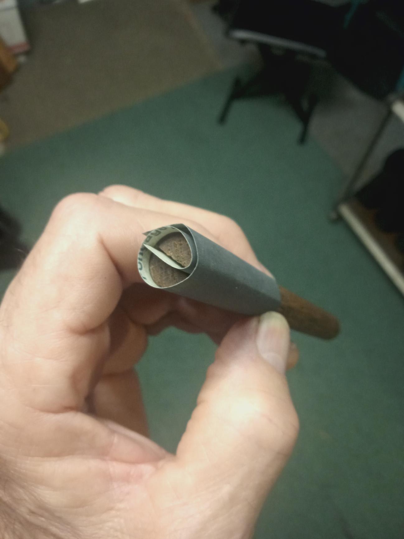

                          Look inside the bore where the piston goes and look for any kind of scratches or wear. I usually clean it up with some 600 grit wrapped around a wooden dowel. If the wear is too great, a replacement would be in order.
