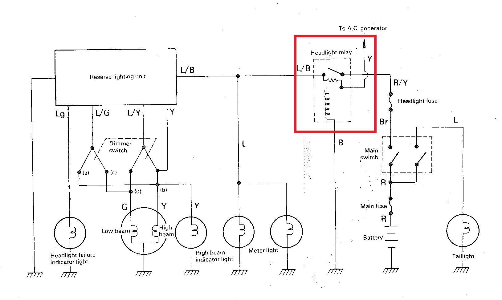

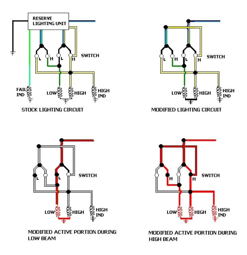

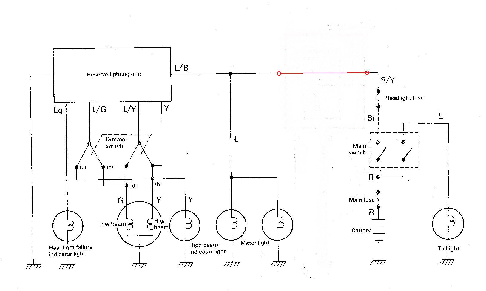

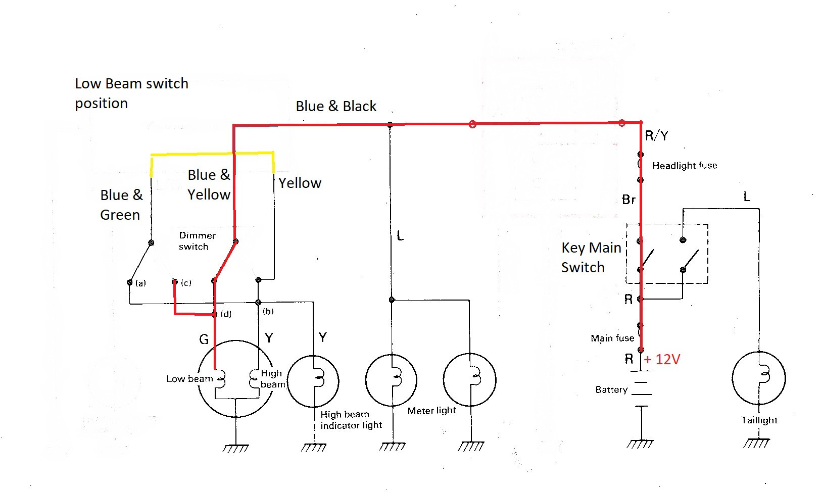

              To eliminate the reserve lighting unit (If you chose to do so).
              Click image for larger version  Name:	XS11 Lighting Device Mod.jpg Views:	0 Size:	108.5 KB ID:	889865 Click image for larger version  Name:	XS11 Lighting Device Mod A.jpg Views:	0 Size:	192.6 KB ID:	889866To eliminate the headlight relay:
              Click image for larger version  Name:	Headlight relay.jpg Views:	0 Size:	178.4 KB ID:	889868 Click image for larger version  Name:	Headlight relay Eliminate.jpg Views:	0 Size:	156.4 KB ID:	889867
                • 2009

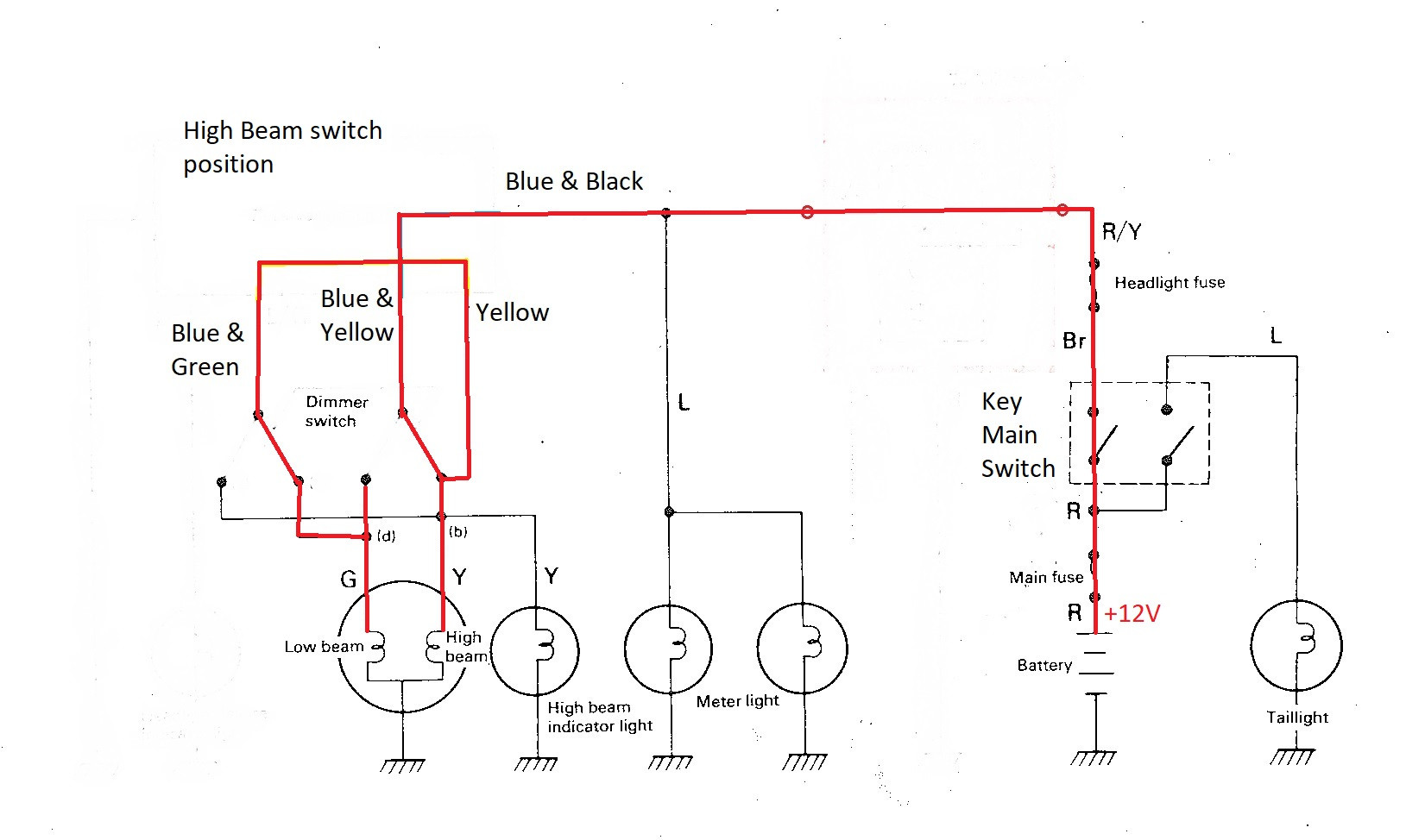

                This is how the modification works.
                Low beam: Click image for larger version
Name:	Reserve Lighting Eliminate Low.jpg
                High Beam:
Name:	Reserve Lighting Eliminate High.jpg

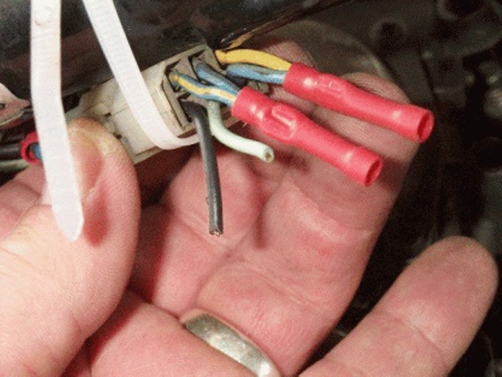

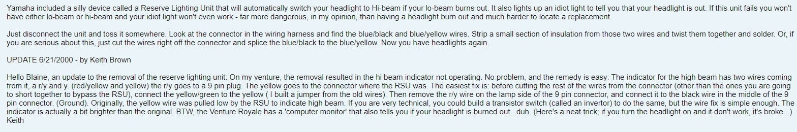

                  • 2009
                  I found this post. This guy used crimp connecters. I soldered mine with heat shrink tubing. Either way it works.
Name:	Reserve Lighting plug mod.jpg
