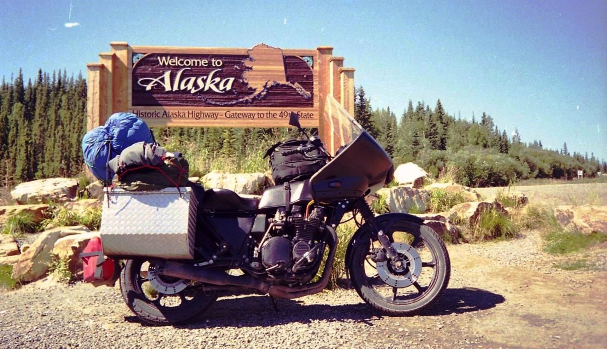

            I have used either Mobile 1 or Shell 15W/40 car oil in literally hundreds of motorcycles. I have also literally circled the planet with my personal bikes several times (mileage wise) with this oil and never had an issue. The "Oil online argument" is the oldest cult in the world and will continue to churn out B.S. long after we are dead. 😉
            Click image for larger version  Name:	Alaska021.jpg Views:	0 Size:	170.8 KB ID:	889563

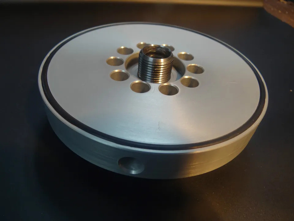

                also a Supertech 20/50 w...user,,,being low priced and always available,,,been using it for a long time with zero issues, change every 4000 and filter, just wish the filter was easier to change, I never had the spin on adapter, anybody chime in on that mod?? Mike in S.Diego and Pa.
                  Word has it the VMax spin on filter adapter kit works on the XS. The thing is with the XS you have a cast aluminum housing directly behind the front wheel to block whatever rocks or debris you might come across as opposed to a relatively thin piece of stamped steel with the spin on.
                    https://www.ebay.com/itm/26104538583...Bk9SR5S6gZC_Zw

                      I’ve been living with the OEM design since 2003. I decided a long time ago that for me, it wasn’t broken. I’ve been using Wix 24933 all this time. It really isn’t significantly more messy than the upside down filters on my cars.

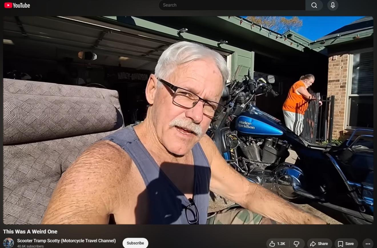

                        Here's a first hand account on having your oil filter getting penetrated by a rock when you're out on the road. Scotty has been wandering since 1995!
                              https://youtu.be/yftL_mFjnkI?si=UZueLZiRWhCNwkuM
                              LAB3, I am also a big fan of Scotty. Go figure. He is no Credit Card.
