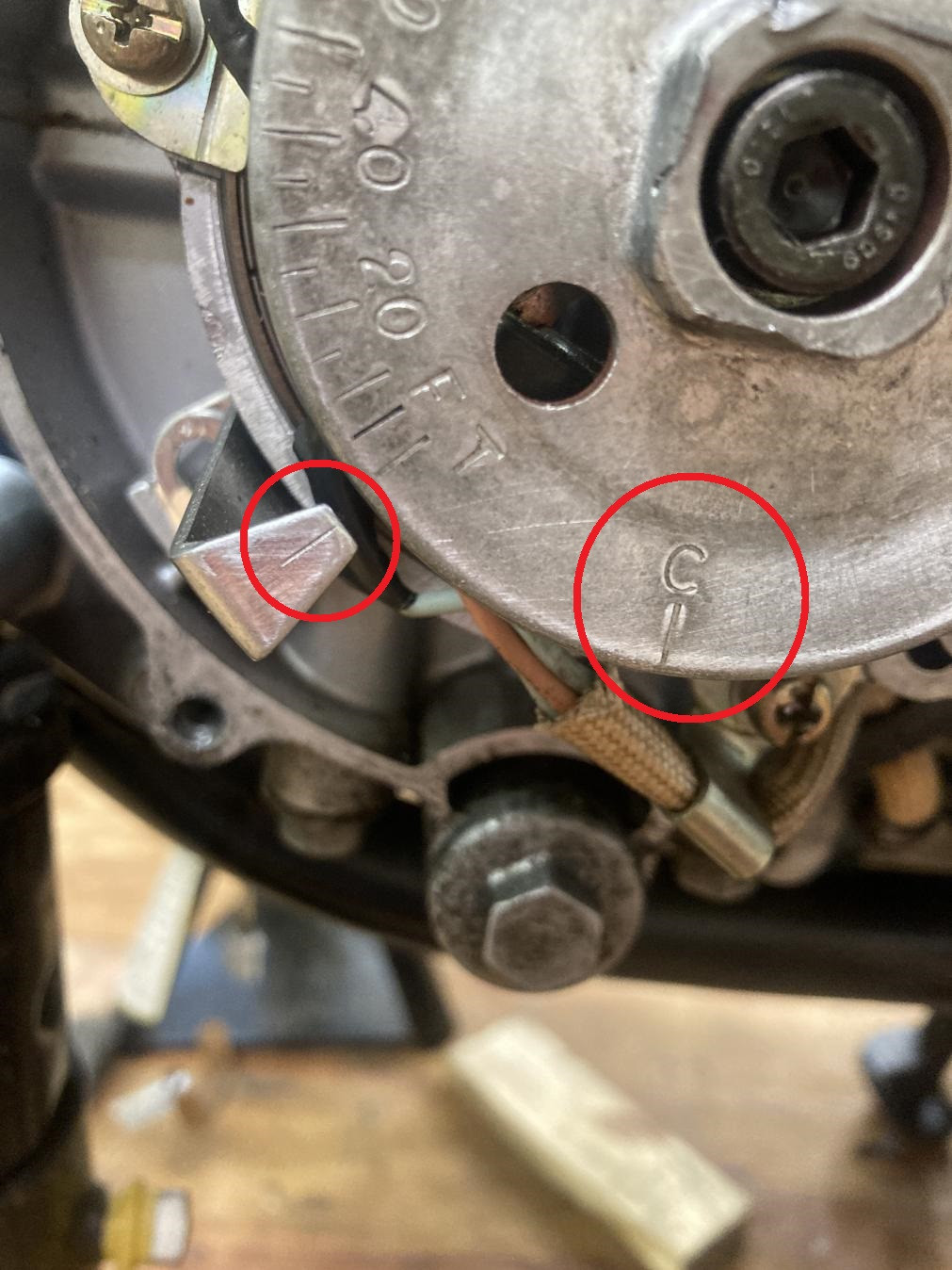

            Remove the left side crankshaft cover, turn the crankshaft so the pointer is pointing at "C"

              When your rotate the engine use a large wrench to turn it and make sure you turn it clockwise. When I was running the original tensioner before replacing it with the ACT as mentioned above I always rotated it around twice stopping at the C mark on the second go around. If you choose to buy and install an ACT (automatic cam chain tensioner) the procedure is basically the same as far as rotating the engine around to the C mark.

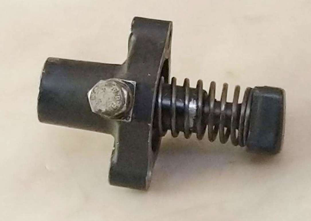

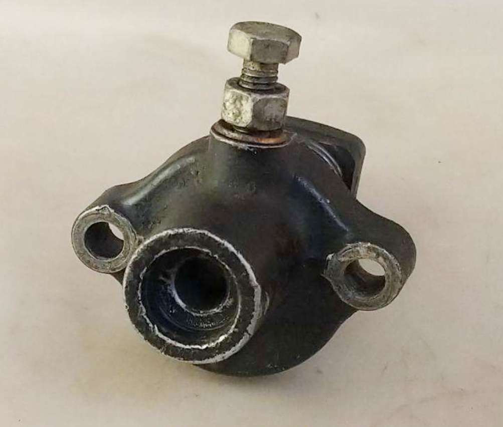

                    I run a stock tensioner unit and to keep it leak free it needed 3 parts. Gasket, O-ring, and "Special Shape Plug". As others have mentioned, the setting on the timing plate is "C" and you can remove the unit to work on the bench. Clean it up and install the parts. Push the plunger all the way in and lock it with the side bolt (not too tight, you will distort the shaft). The seal plug must be installed with a good hi temp sealant. Let it cure overnight or it will leak. You can install the O-ring and gasket dry. When you install the unit, make sure you release the lock bolt and then re-secure it which will return tension to the chain. Mine has remained leak free for several years.
