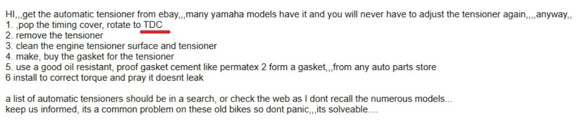

    I agree with soccer4m and the process he described. I don't see it as being the gloom and doom that is being made out to be. Back on the old forum, I couldn't begin to count the number of guys that successfully did it. Yes, there were a few that had problems. Imo and from experience, with an ACCT from the multitude of Yamaha bikes/ATV's that can be found on ebay, the ACCT is the ticket. The confirmation bias strongly favors those who have been successful.
    With that...
    Can you explain more how to R&R without removing? That could be a very helpful process.
    The leaking was the genesis of putting on an ACCT. I don't recall reports of leaking once installed properly. And did I say, never need to adjust again?
    Bonz, are you saying you agree that the procedure should be done at TDC instead of C? I think we corrected this that the setting is "C" and not TDC.
      • 3352
      Click image for larger version  Name:	TDC.jpg Views:	0 Size:	80.3 KB ID:	889295
      "C" is correct. I have edited my post to reflect that.
      TDC versus C had already been corrected before I posted but I see where the confusion could come from. I should have made the note that while agreeing with the process, C is correct with respect to the manual.

        I stand corrected, use C for the install of the ACCT,, according to the manuals,,however I have used TDC for a few ACCT installs and zero issues, I just make sure the engine does not rotate as the cam chain is corrected to exact tension by the ACCT.....have fun,,,,Mike in S.Diego and Pa
