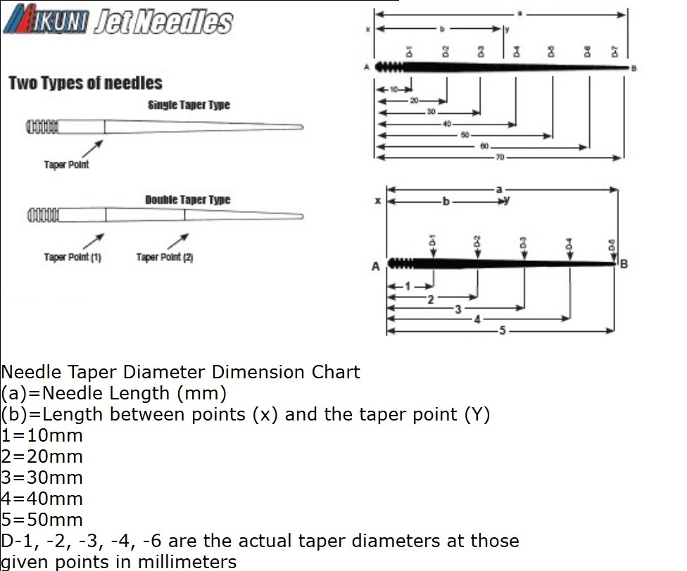

Anybody have the part number for the slide needles for the '78/'79 carbs? They don't make it easy to find. Looks like you have to take several measurements of the taper.

The part number is 2H7-14116-06-00. There are several for sale on Ebay. Yamaha 2h7-14116-06-00 for sale | eBay

Yeah. I was looking for the Jets 'R Us part number. Thanks!The part number is 2H7-14116-06-00. There are several for sale on Ebay. Yamaha 2h7-14116-06-00 for sale | eBay1979 XS1100F

If you want the correct needle jets and needles, Len over at XJbikes has the exact ones for our BS34's. They are aftermarket copies of Mikuni but they work just fine.2H7 (79) owned since '89
