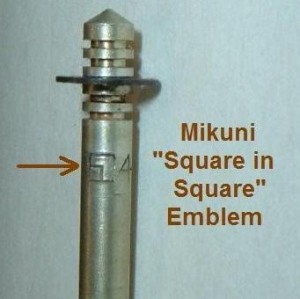

                    Hi, Rob -
                    Here is another really good pic of the Genuine Mikuni "square within a square" logo/stamp:

                        Generally speaking if it is made by Mikuni it will have a square within a square stamped on it. Unfortunately not all mikuni parts get the stamping, I don't know why, that's just the way it is. In addition sometimes in the manufacturing process the part will miss the stamping operation and will not have the mark. If anyone wants to know if a part we sell is genuine or not just email us with our part number and we will let you know. Have a little patience with us because we sometimes have to check with our supplier to verify.

                            Just for grins I dug through my stash of old pilot jets and found a set of Genuine Mikuni's. They do have the logo stamped on them, and it's on the barrel underneath the threads. That's also where the size is stamped - right next to the logo.

                              WOW, it looks like this thread went sideways LOL. Thanks for posting this info. This was all I wanted. With a magnifying glass I can see this mark even if not fully embossed on some of the jets.
