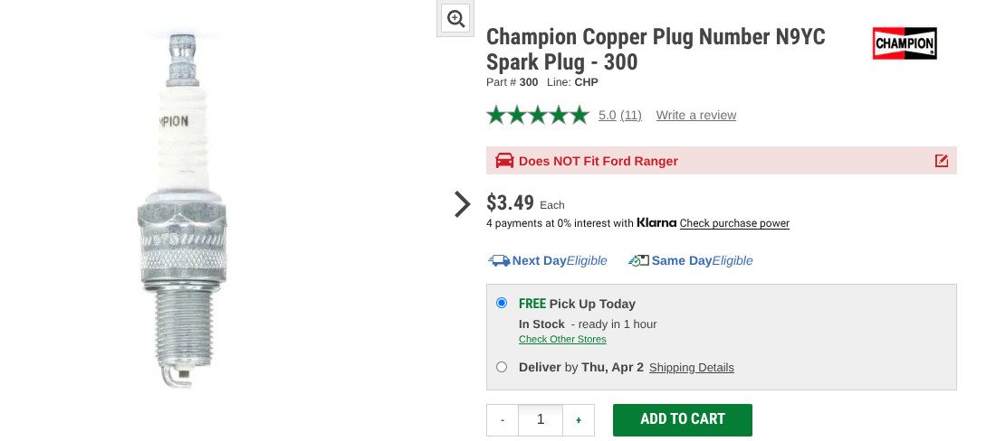

                      It's one heat range hotter than the Champion N-8Y, totally NON-Resistor, relatively cheap, and most importantly... still AVAILABLE. (°◡°♡)
                      I mean... here's what AI sez bout it iff you're gonna give AI any credit at ALL.....
                      AI Overview-
                      The primary difference between Champion N8Y and N9Y spark plugs is their heat range:
                      N8Y is a colder plug, while N9Y is hotter. N8Y is better suited for higher-speed/load conditions, while N9Y works better for normal driving. Both feature a 14mm thread and a projected core nose, commonly replacing NGK BP6ES.
                      It's what I'm running for my "normal" drives which lately have been just to run to Dairy Queen and get soft serve Ice cream. ( ◜◡‾)

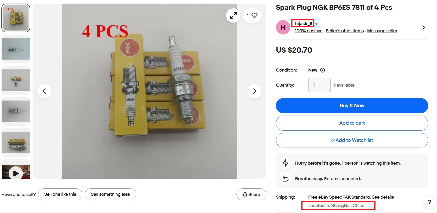

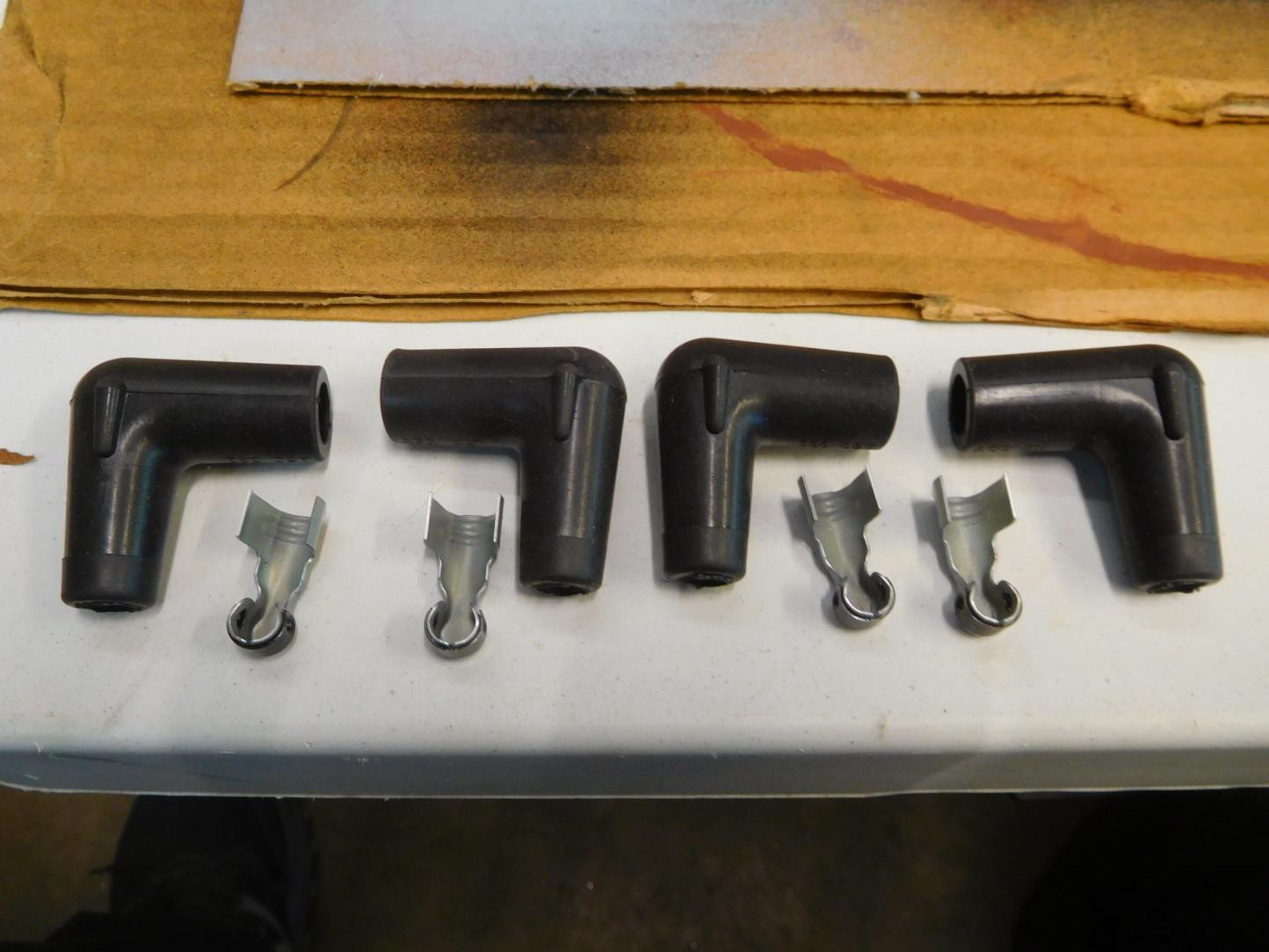

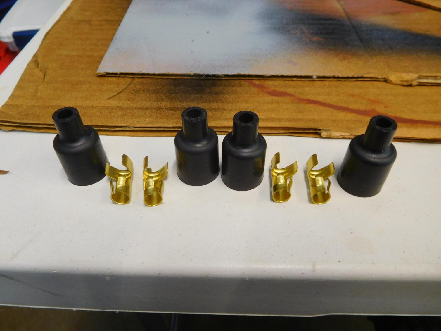

                            I still find genuine BP6ES spark plugs at swap meets (in old boxes from the 80's) & from a small amount of reputable Ebay vendors. Been stock piling genuine plugs for years for all my antique bikes when I first caught wind of the fake, destructive parts. Non of my old bikes have 5K plugs or 5K cap ends. I make all my own wires & caps.
ID:	888945 Click image for larger version
                              Fake Chinese Crap
Name:	Fake Chinese Crap.jpg
