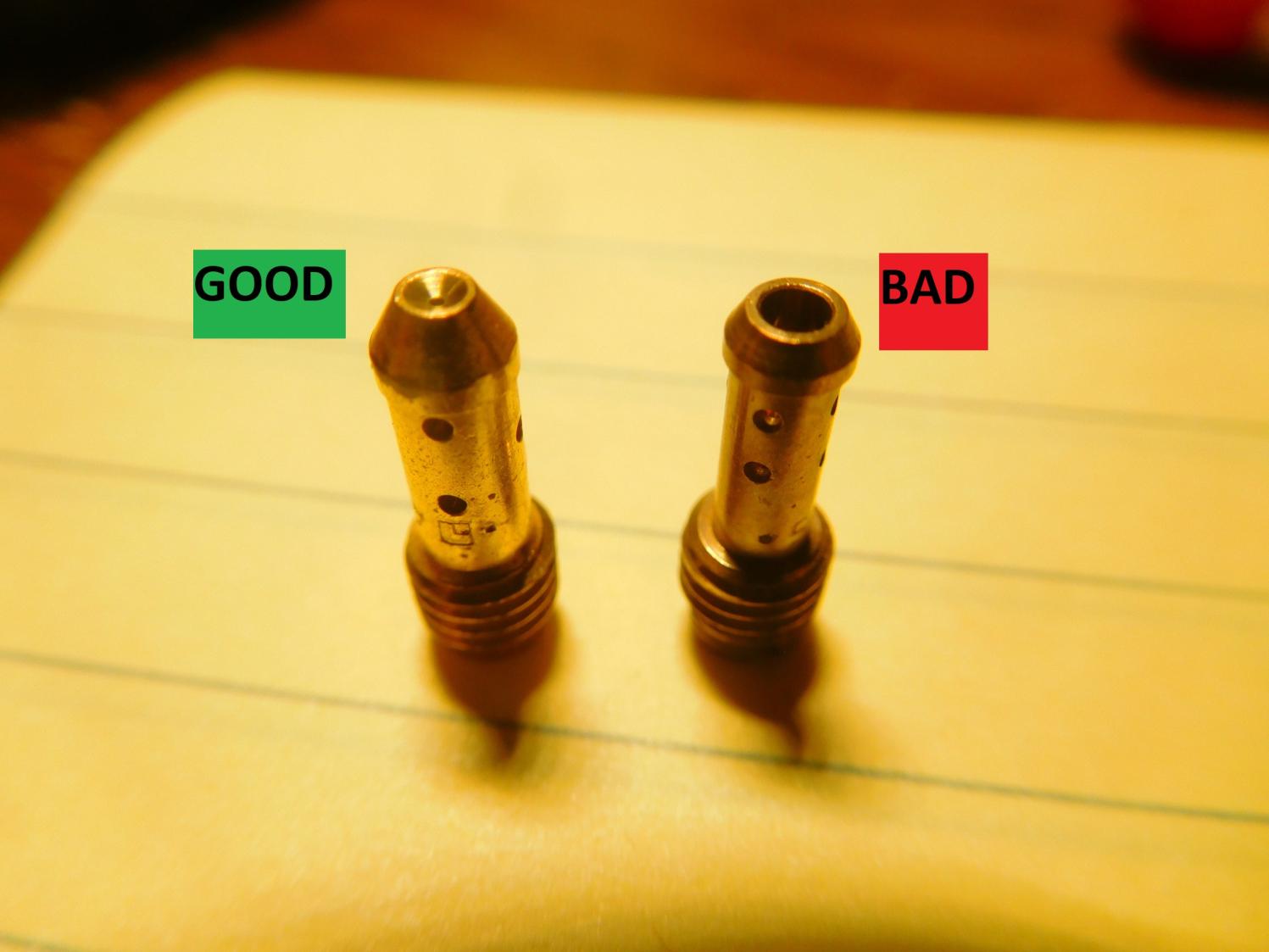

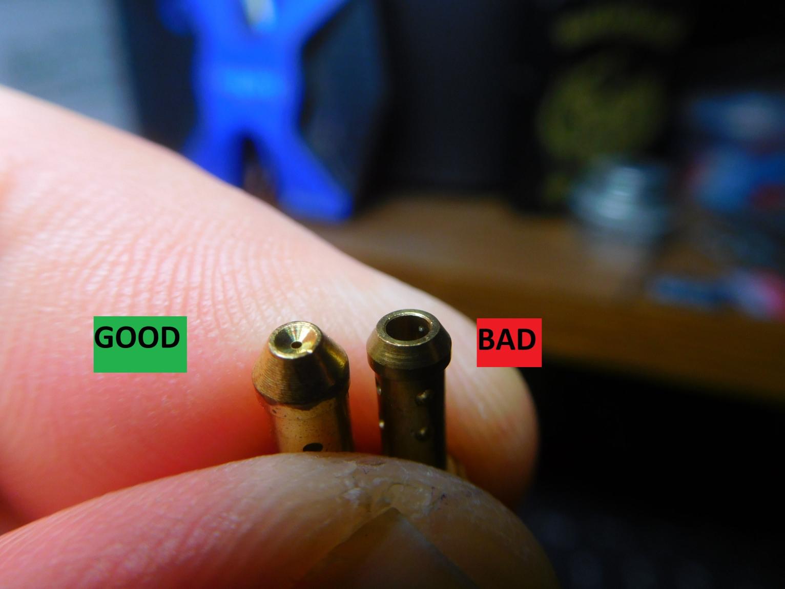

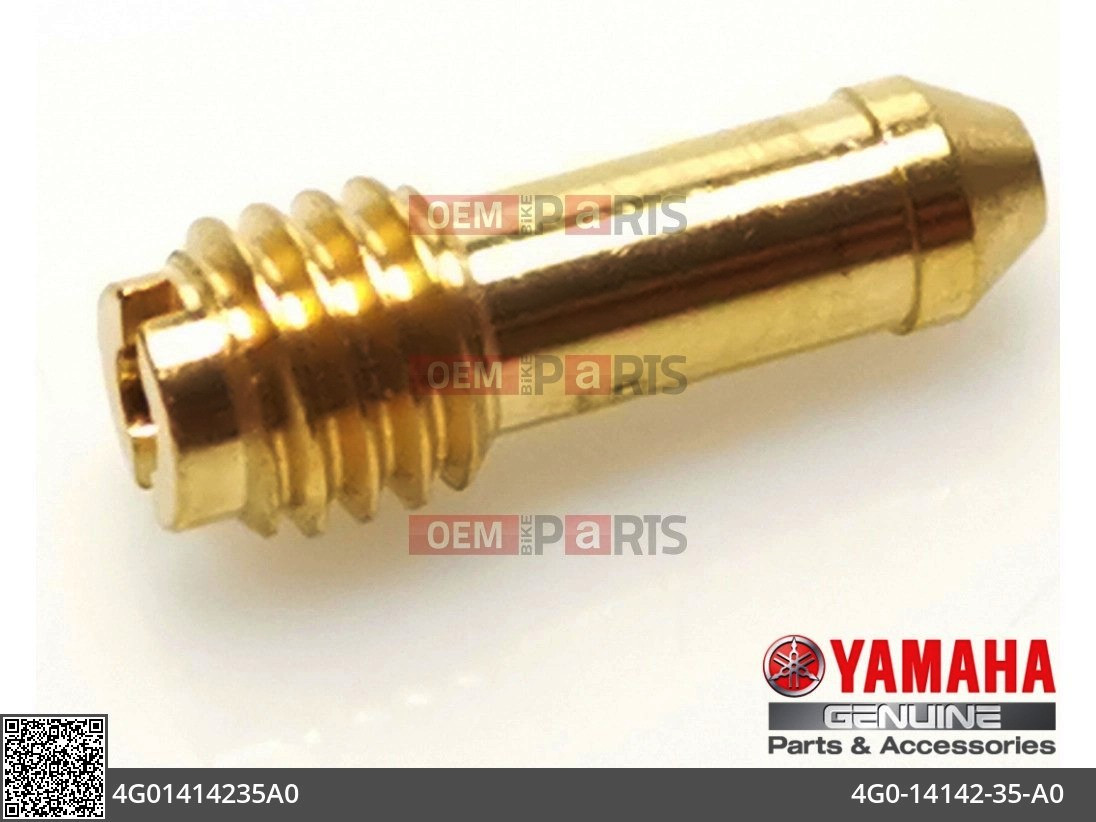

    The pilot jet should look like this. It's the hole at the end that you should be concerned with. It should have a small hole at the tip with a shallow divot. The incorrect jet has a deep recess. If I remember correctly the holes in the side (holes or no holes) work either way.

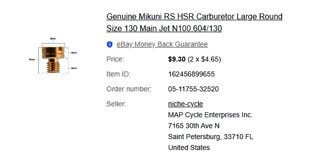

        Repost about the jets I run in my bike (aftermarket exhaust and pod filters @ sea level.
Name:	45 XS11 Pilot Jet.jpg
ID:	888437 Click image for larger version
Name:	Mikuni 130 mian jets.jpg
