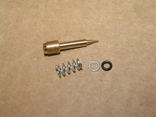

                            When you removed the pilot screws did you get all the parts out? There should have been the screw, a spring, a small washer and a rubber o ring. The reason I ask is sometimes that o ring doesn't come out by just falling out and sometimes if it is really hard and old it can actually attach itself at the bottom of the tunnel. I fashioned a pick with a little hook on the end to be able to reach down in there to remove them. By the way if those o rings are not still somewhat soft and pliable then they will need to be replaced.
