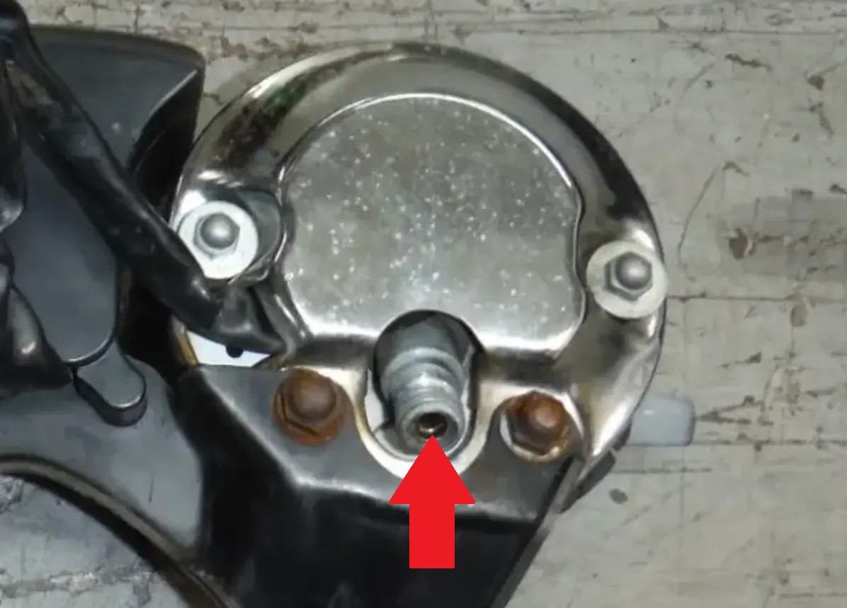

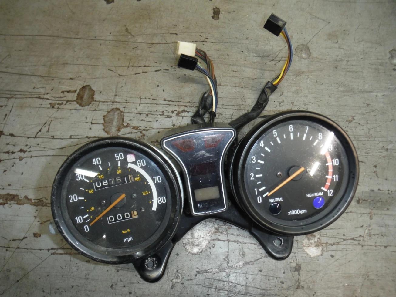

    Click image for larger version  Name:	ezgif-1b606c78760f4cb2.jpg Views:	0 Size:	158.6 KB ID:	886755 Click image for larger version  Name:	s-l1200 (1).jpg Views:	0 Size:	223.0 KB ID:	886756
      The noise in your speedometer is a lubrication problem. First start with lubing the speedometer cable. If the noise persists, then the speedo needs to be removed from the bike and set it down with the cable input pointed up. Use a light (sewing machine oil not WD40) and add a few drops. Let it sit overnight to soak in. This was an issue with my 78 and it cured it.

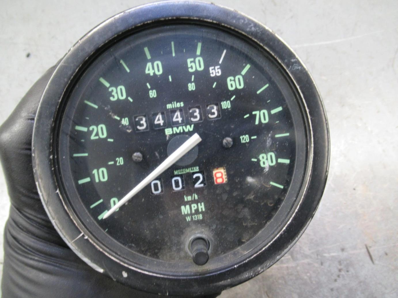

      Click image for larger version  Name:	ezgif-14f9022ee103739c.jpg Views:	0 Size:	147.4 KB ID:	886758
        Here is another example with 1980 BMW speedometer with the 55/80 MPH markings.

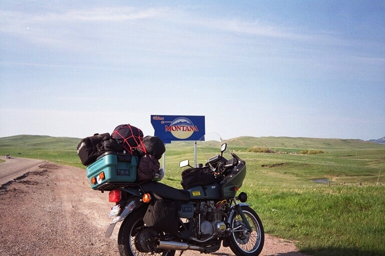

          In 1996 I rode my KZ650 from Connecticut to Seattle and I remember they lifted the 55MPH limit in Montana. There was actually no specific speed limit. It was pretty cool. I did about 80MPH the whole time without issues and it was good.

                    I had the speedometer issue with my bike. It sounds like an RC car screech when the cable turns fast enough. It's actually the sound of a small galling bronze bearing in the speedometer. They do this when they sit for a long time. Had a 900 Honda do it also and it was repaired the same way.
                    Disconnect the speedometer cable from the back of the unit and take it for a ride. No noise? Speedometer. Still makes the noise? Keep looking.
