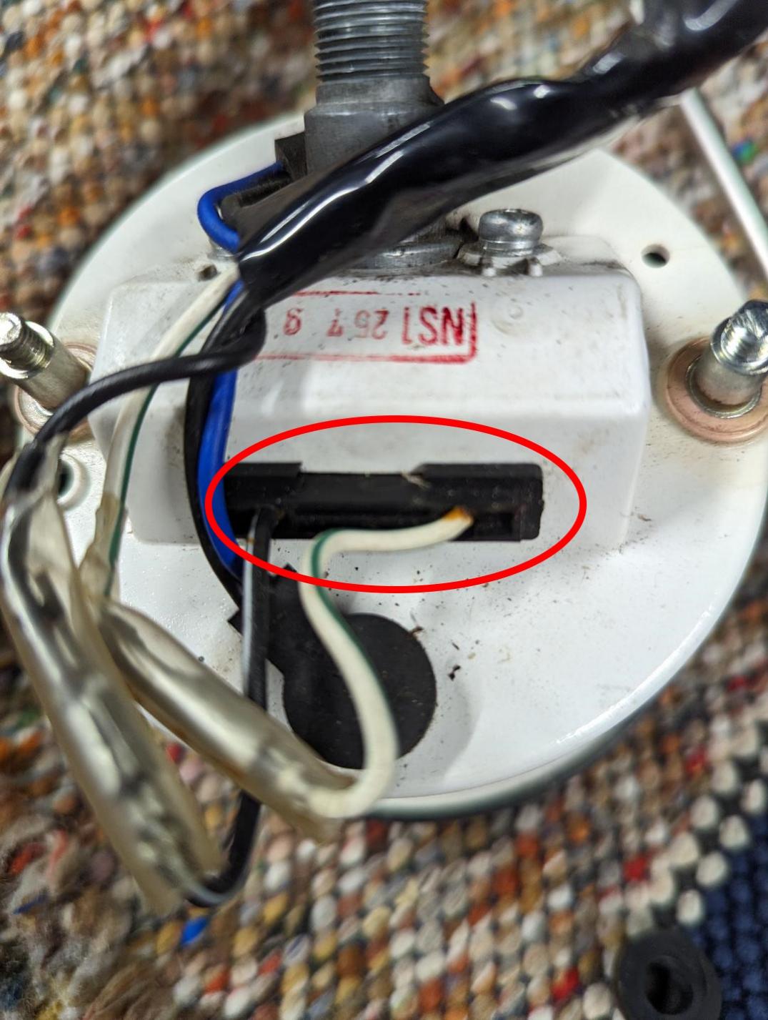

    My 79 SF speedometer is making mild but annoying squeaking sound. It is RPM variable. Mostly noticeable when coasting to a stop. When I remove the black square thing that I have circled in red, the squeak goes away. Has anyone had this problem and if so, found a fix for it? In the meantime, am going to swap out that black rectangular thing, whatever it is. Thanks.

    That is the reed switch for the self cancelling turn signals. You can omit it if you don't use/like that feature. Just remove and put a piece of tape over the hole.

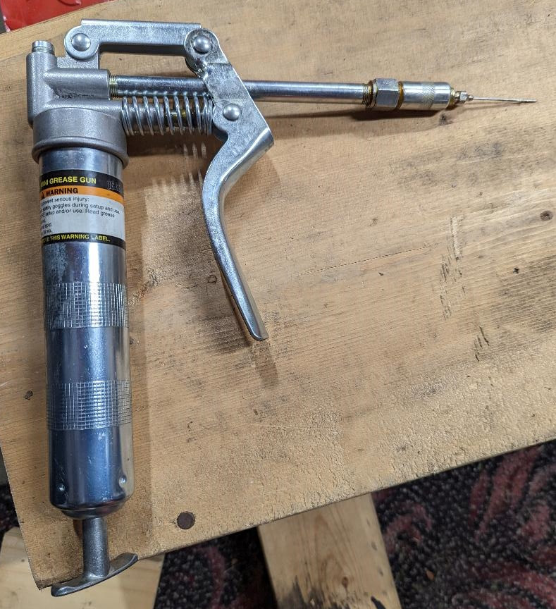

                  Thanks auxtian. Interesting video. I did grease the speedo as well, using this nifty needle tip on the grease gun. So it could have been either or both the sender and the speedo that was causing the annoying noise.
