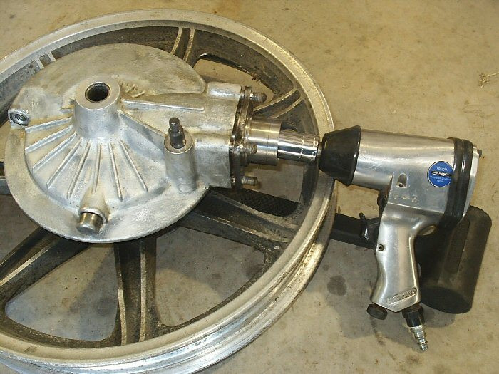

    Click image for larger version  Name:	01_750drive.jpeg Views:	0 Size:	104.2 KB ID:	861662

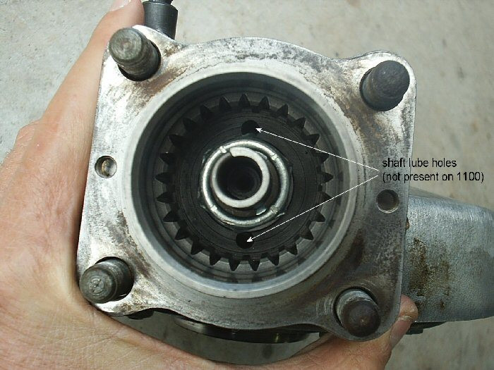

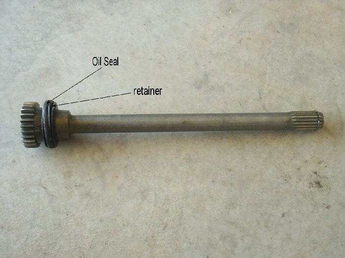

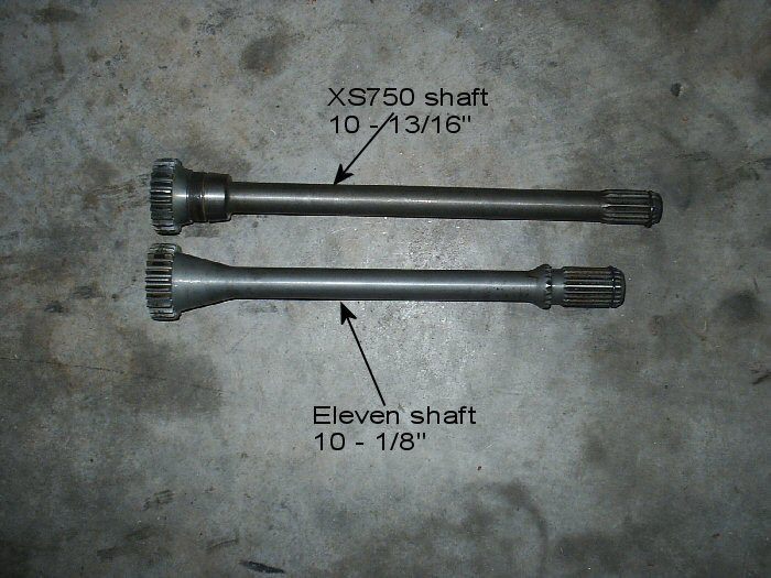

    I stripped all the old paint (silver) off the unit as I will paint it black to match the oem drive. Notice the XS750 has lubrication (spooge) holes in the base of the gear coupling. The 750 shaft also incorporates an oil seal that allows oil to circulate into the coupling house and lube the drive spline. The seal on the 750 shaft contains the oil in the gear coupling.

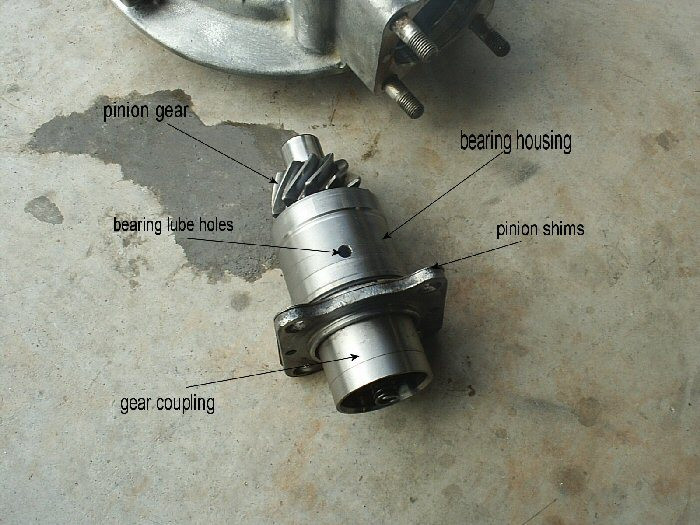

    Click image for larger version  Name:	02_750shaft.jpeg Views:	0 Size:	74.0 KB ID:	861663
    Click image for larger version  Name:	03_bothshafts.jpeg Views:	0 Size:	106.5 KB ID:	861664
    Click image for larger version  Name:	04_spoogeholes.jpeg Views:	0 Size:	113.0 KB ID:	861665
    Also notice how the spline are recessed into the gear coupling. This recession is where the shaft seal seats to retain gear oil. The Eleven does not employ this style of lube system. The Eleven has no “spooge” hole and uses instead grease. Personally I think the Eleven is a superior system. With the Eleven there is no possibility of oil seal failure and thus leaks. So I sealed the spooge holes in the 750 drive with liquid gasket and covered them with a standard

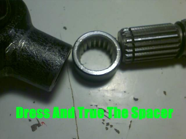

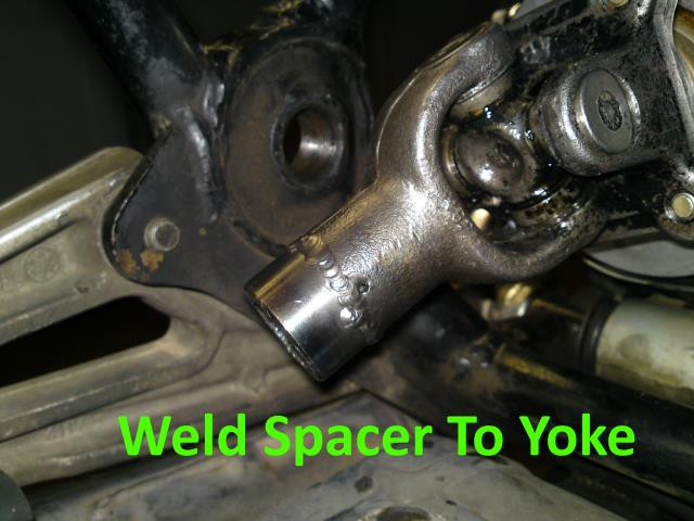

      T.C.,
      When I first did the '750 mod I bought all the recommended parts but I didn't trust the spacer idea so I cut the barrel off the yoke from a bad u-joint and extended the splines the full length of the driveshaft again.
      At the time I wanted it to be stronger than just the spacer but I also wanted to be able to undo the mod. I used the driveshaft to hold the parts together and aligned while I drilled and pinned both pieces with a couple of broken 1/8" drill bits, then covered them with JB Weld. The JB Weld crackled off like I thought it would but you can still see one of the holes in the yoke and it still has the pin in it.
      When I decided it was time to make it permanent I brought the driveshaft along to the welder's shop so the parts would stay lined up through the heating and cooling.
      However it turns out it uses up two XS11 yokes so don't mess up.

      Dress And True The Spacer

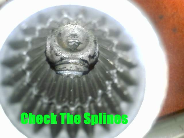

      Check The Splines

      Extended Yoke vs Spacer
      XS1100 U-Joint Yoke Extended
