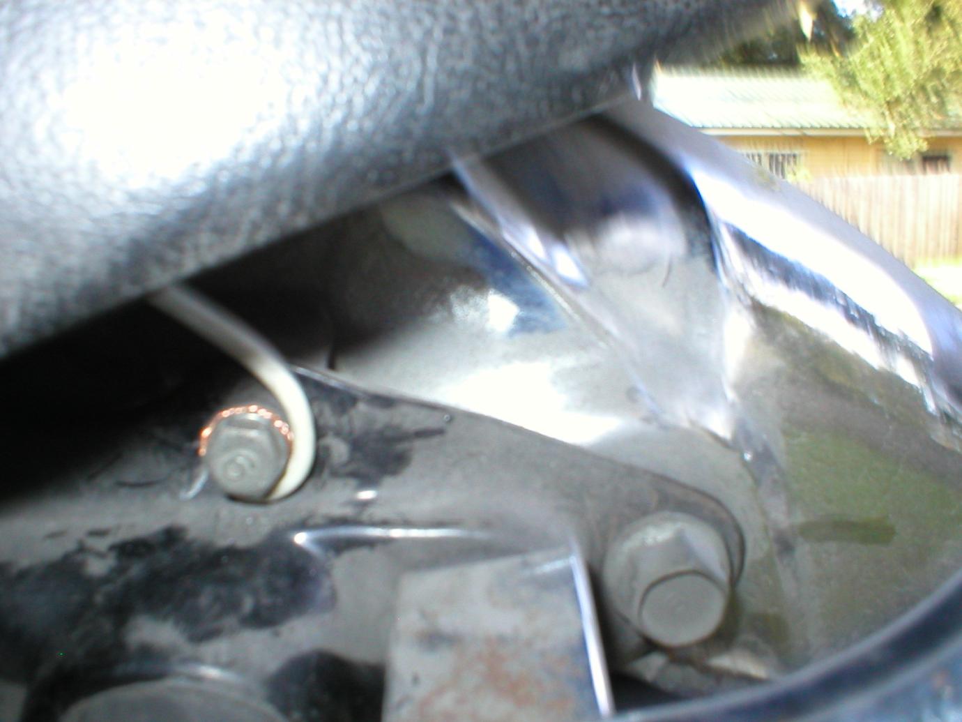

            Alright ..got to the grounds under the fender 14mm even added a ground. Click image for larger version
ID:	886051 Left will blink now but slower than right.
