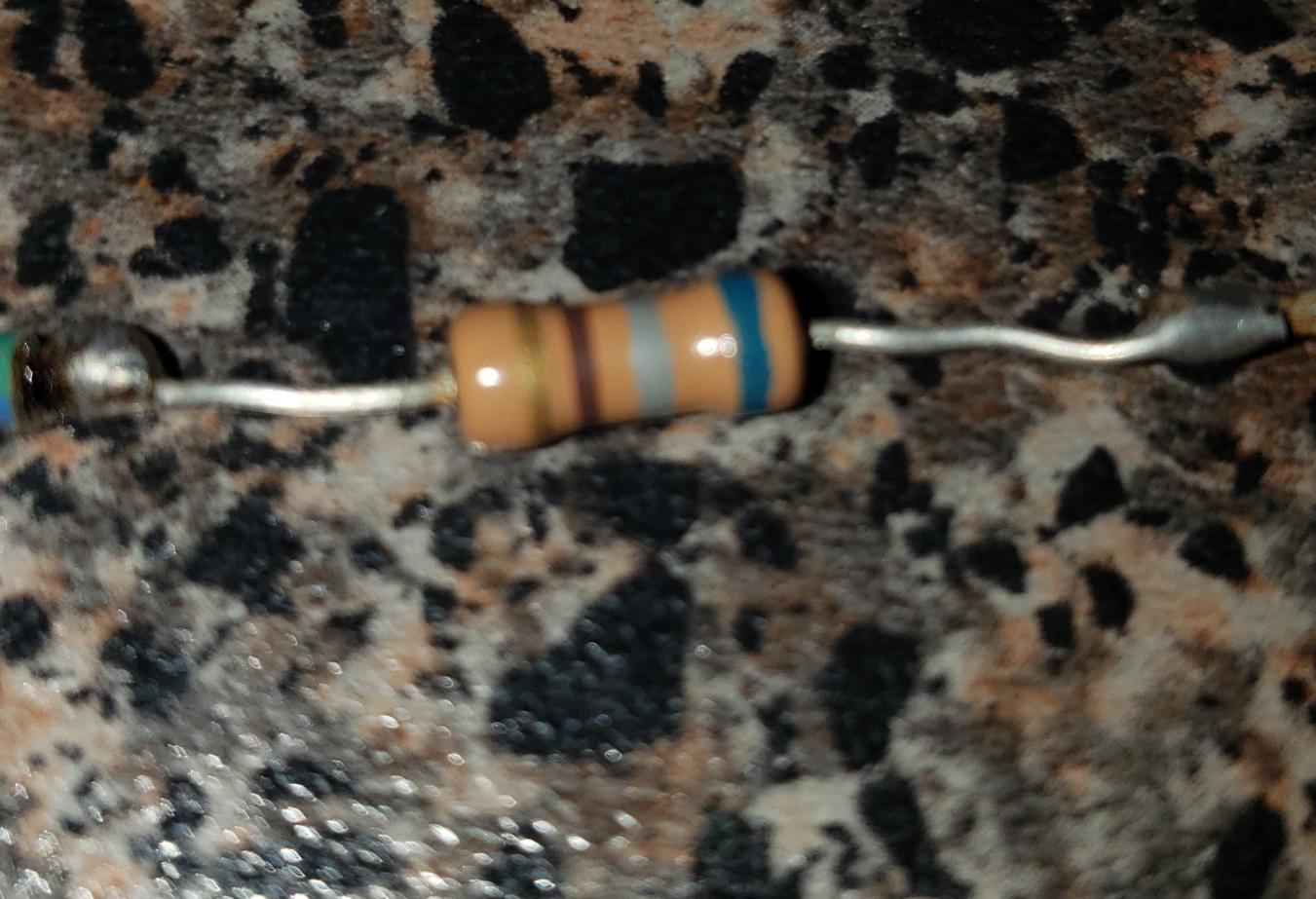

                    A little update , finally got back to this bike today I have a 2k resistor ready , while I was pulling the old ,not connected wire out , spotted a section with a resistor . going by the photos posted by you folks , this looks like original, I suspect previous owner replaced battery and just cut off the sensor section , anyway this was the resistor , if I'm correct is a 68k ohm.
                      Look like 680 Ohms +/- 5% to me (that is blue-gray-brown isn't it?).
                        So, the 680 ohm was used by the factory to pad the current on 3 x 2V cells equaling 6V at the sensor. If you are using 12V switched (which is all you have available) the resistance would have to be at least 1360 ohms. 2K should work fine.

                            Yes:
                            Bad = Black = 0
                            Boys = Brown = 1
                            Raped = Red = 2
                            Our = Orange = 3
                            Young = Yellow = 4
                            Girls = Green = 5
                            But = Blue = 6
                            Violet = Purple = 7
                            Gave = Grey = 8
                            Willingly = White = 9

                              thanks , yes a closer look is brown
