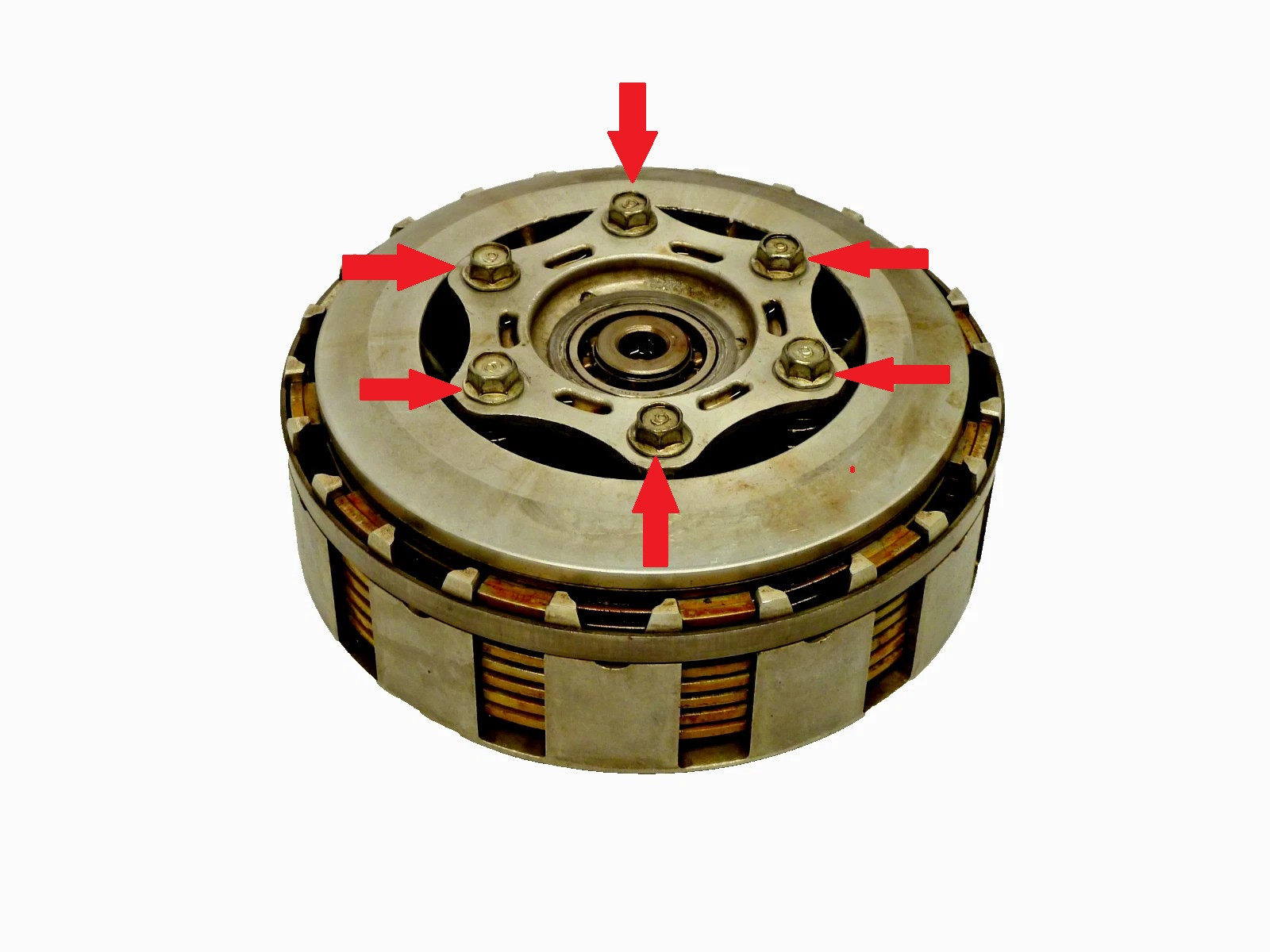

        • 1982
        Your problem could be here. Not installed correctly and binding. Sometimes they can crack.
Name:	Clutch springs.jpg
