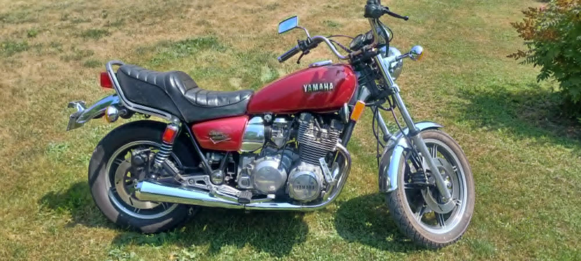

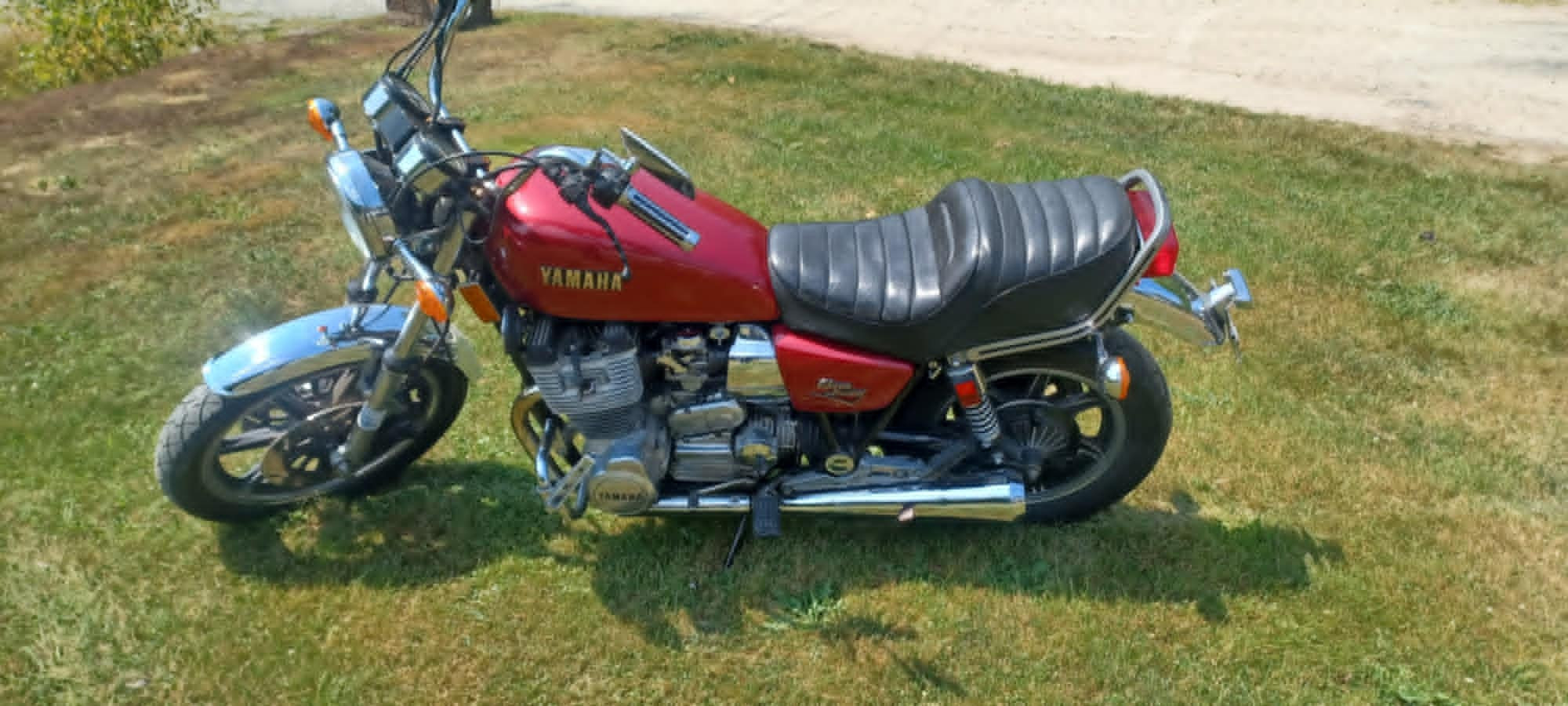

              Here is the bike, I took the original bars off the bike, did not like them, those are off my 1980, I have a new set ordered for it though
                Beautiful bike. You should be proud. Very nice condition. Blowing up the pictures it looks like those are the 81 carbs. You can tell from the tops. With that said the needles in those should not be adjustable. At least from what I know they weren't. Someone else may chime in with a correction. The 110 jets are what came in them so that is fine. If the bike is running right I wouldn't be concerned with anything else. The service manuals on these bikes are all basically the 78 to 80 main text and most of what was in those areas is geared towards the standards. Then they would include supplemental information for the specific year bike you might have. I bought the service manual for my 1980 MNS when I bought it new and most of that manual is written for just that bike. All the other manuals I have seen were as I stated previously. You might want to get your hands on the SH supplement as it addresses specifics to your bike.
                    Thanks man appreciate it, I'm very happy with the bike. when I found it I jumped on it, actually my son found it, he's a bike geek lol , but for up here in Canada a lot of bike don't make it 44 years, at least in this shape, and this original, so i'm assuming, but could very wrong, but I bet there is not to many in Canada this original and in the shape it is. I plan on Keeping it this way. it also had a windshield and backrest on it, I took them off too, I know the windshield is not from factor, but I never asked about the backrest, I doubt it was originally on the bike when purchase,maybe added at that time or added at a later date. The hwy pegs on it are cool though, on the top side of them there gold plated, with Yamaha on them, I never seen a set like that before in the style they are. Did the special addition come factory with those, or would they have been added later?
                    As far as the jets, you know way more about that then me, maybe he forgot at some point they were changed, maybe they came from factory like that as a mistake, or used in place of the other ones due to inventory issues. who knows, the only there thing I can think of, but not sure if this apply way back in 81, did they use different parts etc in the carbs for different countries.
