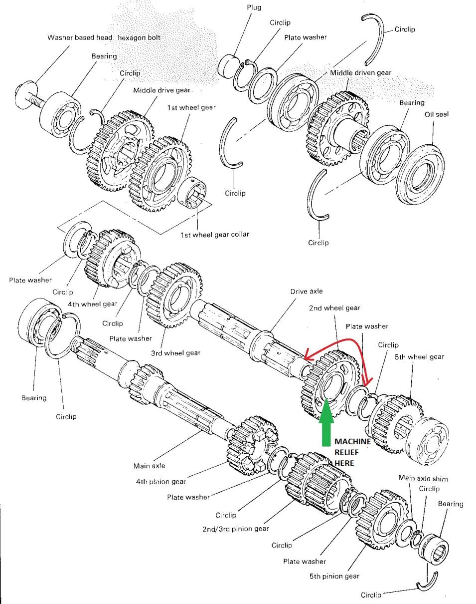

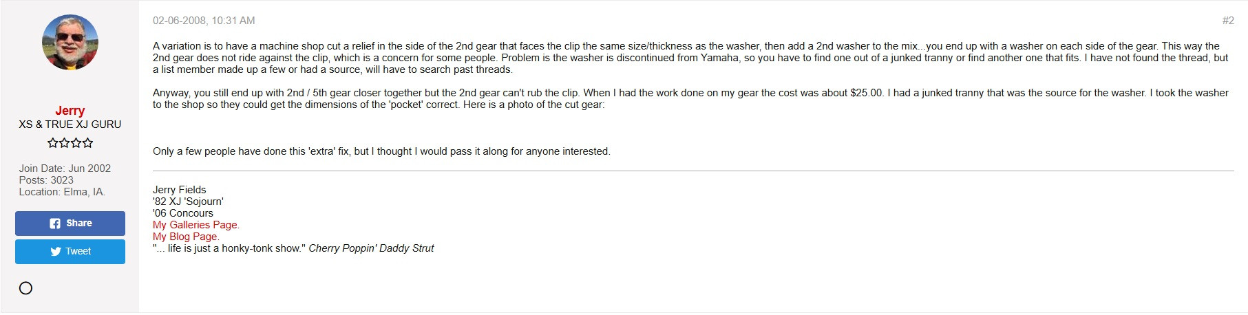

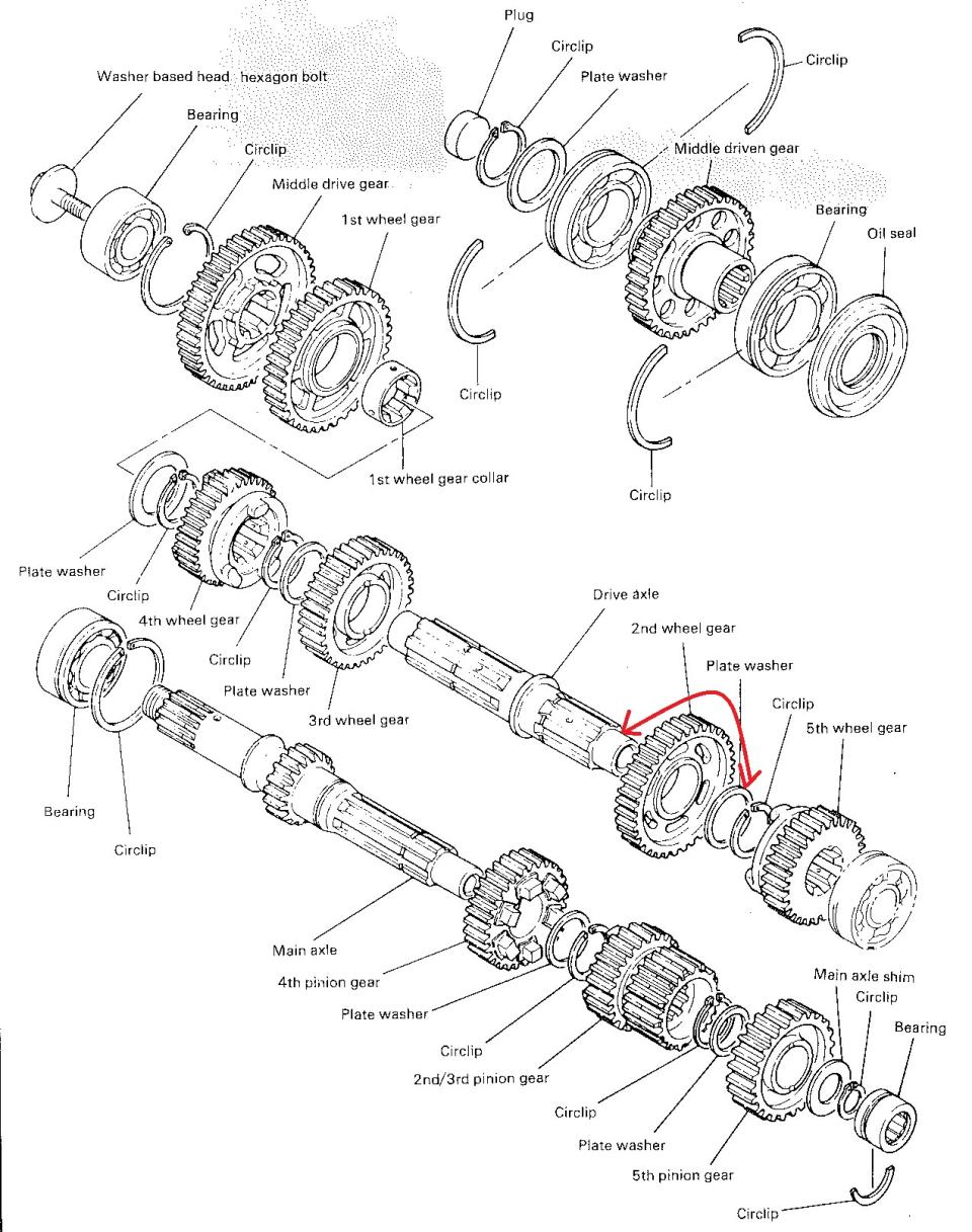

    There is also a “washer move” covered extensively. It should keep the issue from ever happening. You will avoid failure by shifting deliberately/firmly.
    When I ruined my 2nd gear, new gear wheels were available and I accomplished the “washer move” when I replaced them.

            Hey guys thanks again for the info, I asked my son about what he fixed in the 1980's bike, he something something must have let go in the tranny as the teeth were broke in 2nd, 3rd and 4th gear lol.
            jetmechmarty Yes I am finding that I have to shifting deliberately/firmly. even on a smooth shift it clunks, but if its an easy or slow shift if it catches the gears, that's not just in second but all, but if its a deliberately/firmly shift its generally pretty good. I'm going to try just tightening up the clutch a bit.
