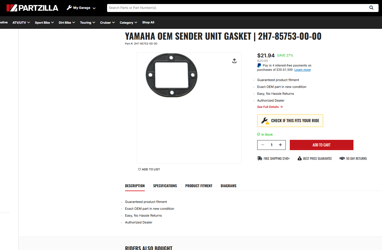

    Well, looks like my XS is going to stick around in my garage for awhile... it doesn't want to leave! Started to mark its territory leaking from the fuel sender area on the bottom of the tank. I previously used some fuel tank JB weld to try and stop this, replaced the sealing washers for the unit... no bueno. Back to the table. Also, seems the front calipers are hanging up. Tried clearing the splooge hole. No dice. Will have to pull the caliper and see whats going on with the pistons. I just put a new caliper kit and pads on both the fronts.

        Yes, got one on order! Cheers. I will pull the caliper. It seems over night the pressure releases. As soon as I pump the lever up it stays rigid and locked.

                Seems to have fixed it, although waiting on the mail for my tank gasket. Bike was for sale... I think I will keep it kicking around. Nobody wanted it for little money. It is low mileage in good shape. No harm having it for awhile. As you all know, they are as solid as an old bike comes. Hopefully 2nd gear holds. Always my concern in the back of my head. Then again, I enjoy the wrenching too. I noticed lately when the bike is hot I need to blip the throttle start it. Not when cold. Cold on choke and half choke it runs well. But needs a little help to start hot. What do you think that is about. I don't think I am lean on idle....

                              Brakes are fixed, although they are pulsing with heavy braking. Gas tank is not. Very frustrated on that one... got the new rubber gasket in there... still weeping. I used copper sealing washers for the screws... perhaps I need a fuel resistant nylon. Its very hard to tell where the fuel is coming from. It may be coming from the area where the one lead attachs.
