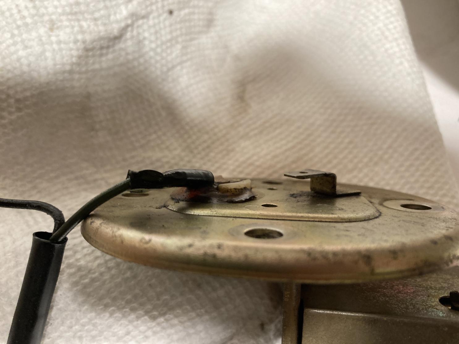

    Jetmechmarty and I have have had the gas level sender itself leaking.
    See how the old glue is failing?:
    I scraped out the old sealer and globbed over it with this stuff:
    Can't find an "after" picture at the moment.

      Brakes are fixed, although they are pulsing with heavy braking. Gas tank is not. Very frustrated on that one... got the new rubber gasket in there... still weeping. I used copper sealing washers for the screws... perhaps I need a fuel resistant nylon. Its very hard to tell where the fuel is coming from. It may be coming from the area where the one lead attachs.
      Use baby powder to pinpoint that leak.
        I am sure it is coming from there. Before it was coming from both the actual rubber sealed surface and there. Now it is a very small leak from there. I will do what you did. Thanks.

          You can buy a fuel tank sealer from most auto parts stores. It should be about the same as the POR 15 patch if you cannot find it.
