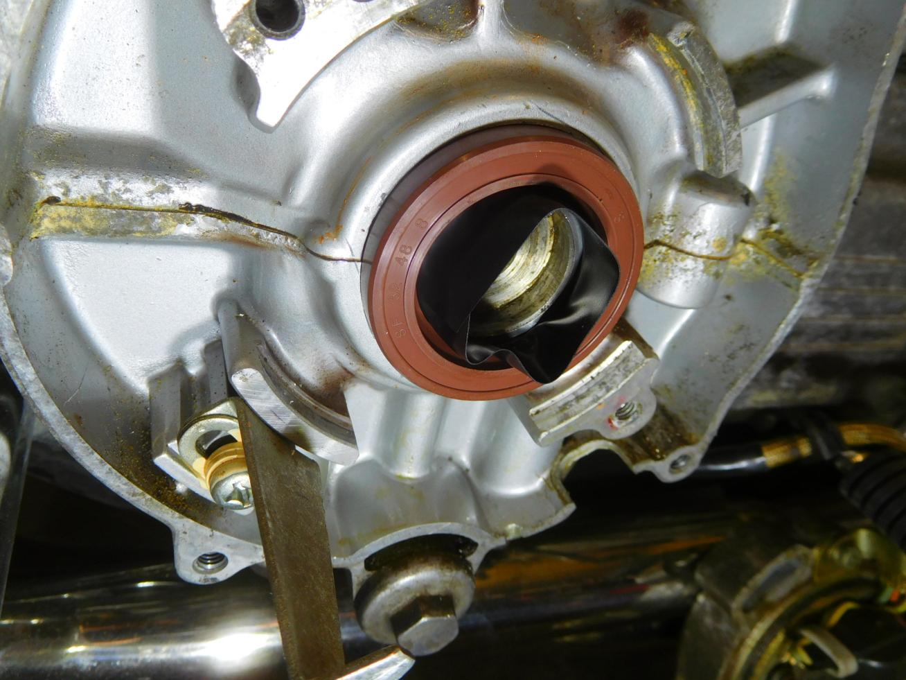

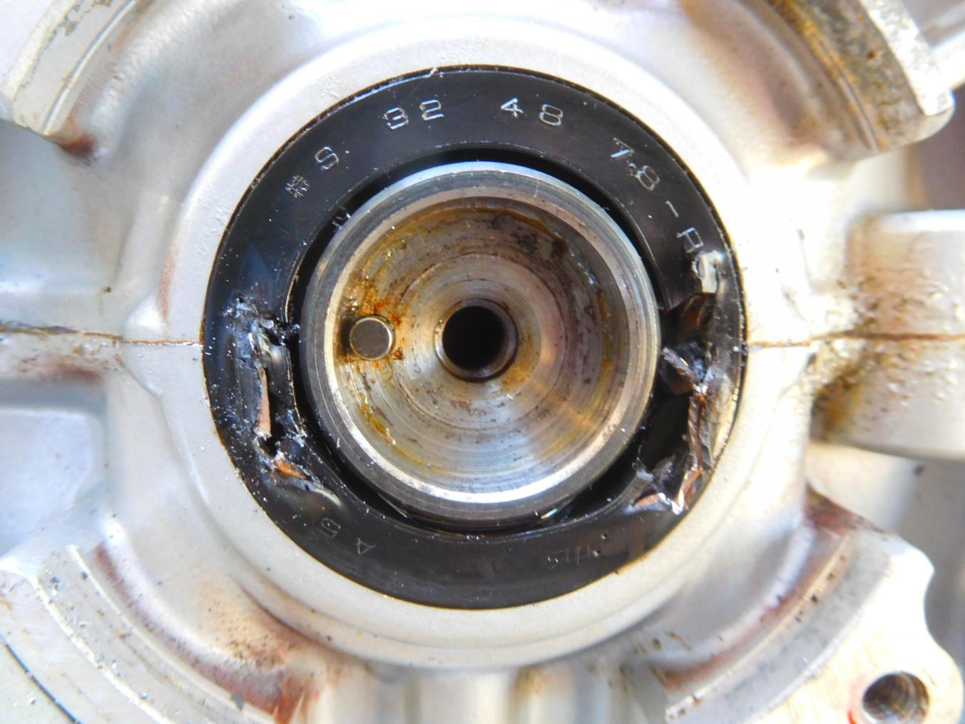

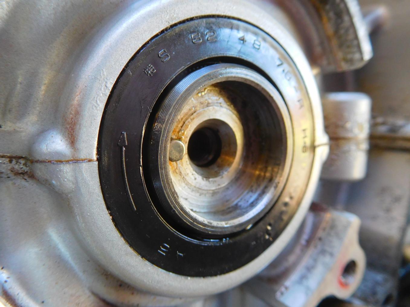

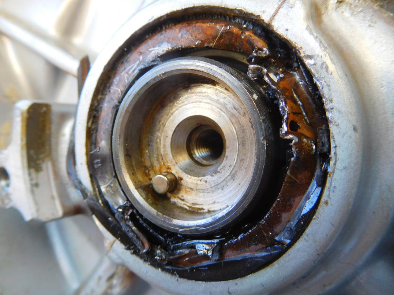

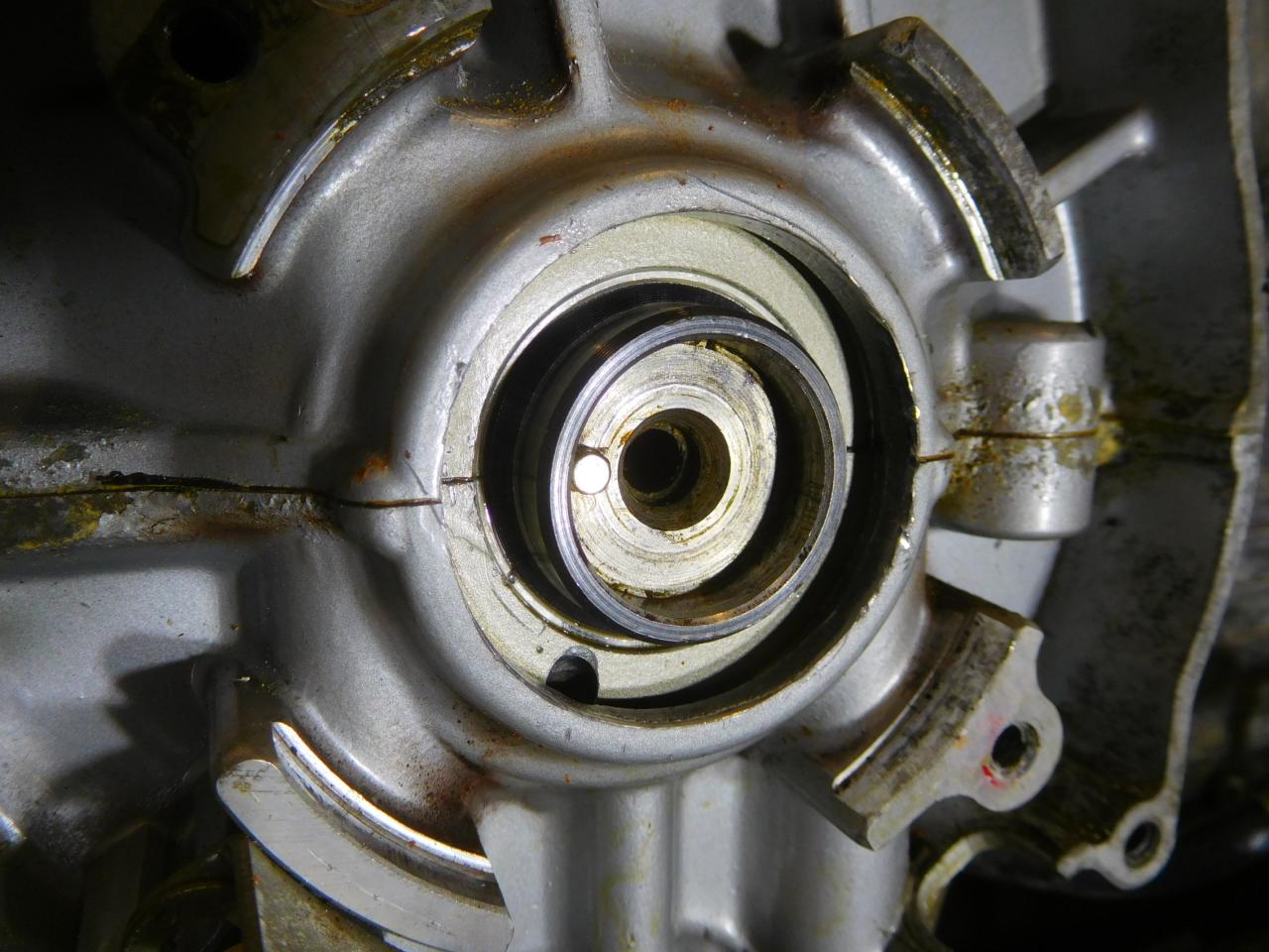

                    Originally posted by Appie
                    I was reading that the crankcase needs to be split to replace the original seal anyway which is beyond my pay grade at this stage.
                    I have yet to replace that seal, but I don’t believe splitting the cases is necessary, particularly with an aftermarket seal.

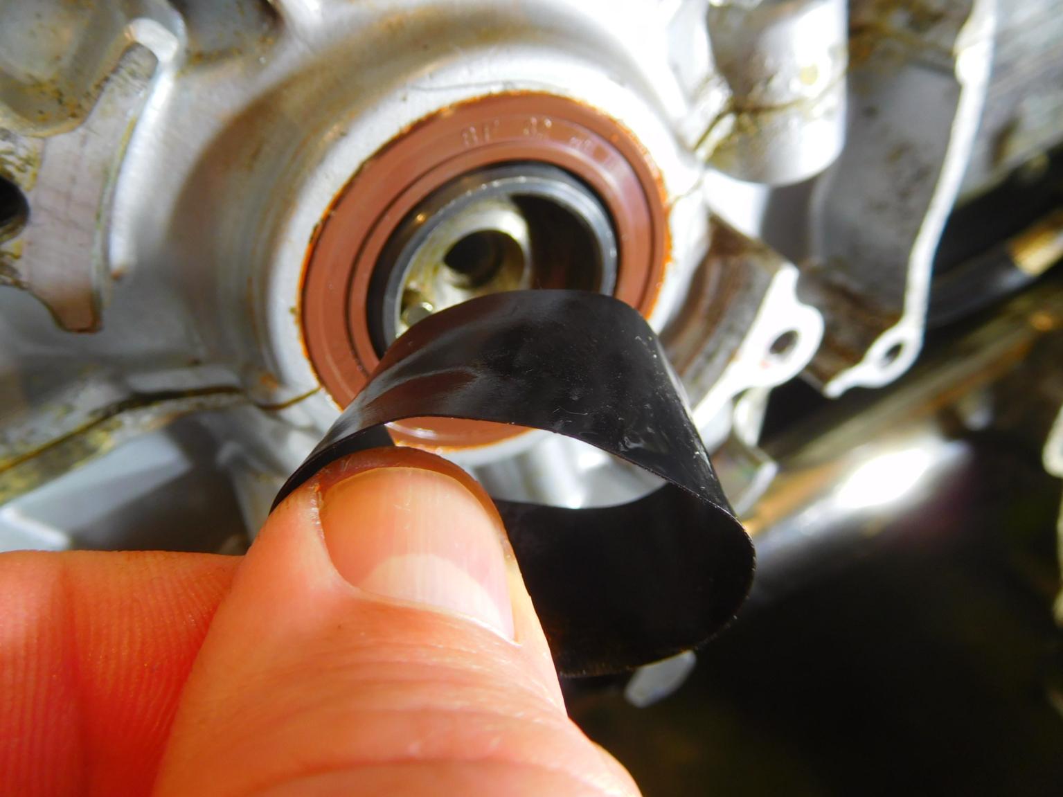

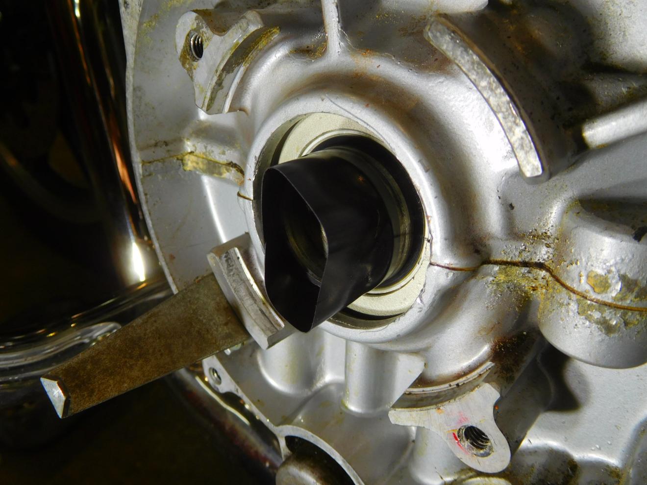

                      The OEM seals are no longer available, so you CAN replace it without splitting the cases. The hard part is getting the old seal out as you will need to remove the lip that is "locked" in the case, but it is doable. Just be careful of the crank as you work the old seal out.
                        Perhaps a sheet metal screw and a Vise Grip plier is appropriate for that job?
                          Removal....

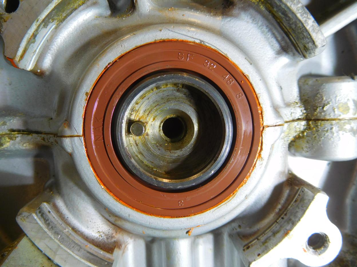

                            Installation. Use a Viton seal.
