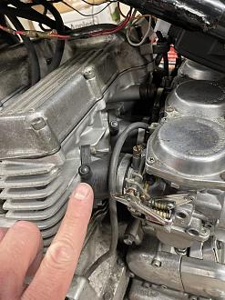

    Looking at this pic-where is the vacuum cap? Bike will run like crap with this missing.

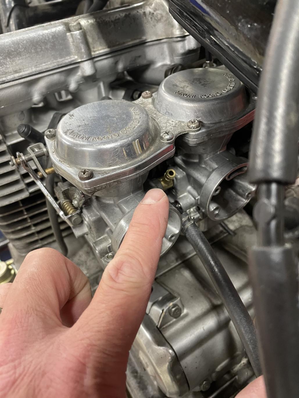

      Original carbs, I assume the vents lines are the ports just to the right of my index finger in the 2nd pic. Open and no hoses on them.
      Correct. (^_^)
      Usual to put some kinda short line wit'a filter on'em but that's down the road a ways? (O_o)

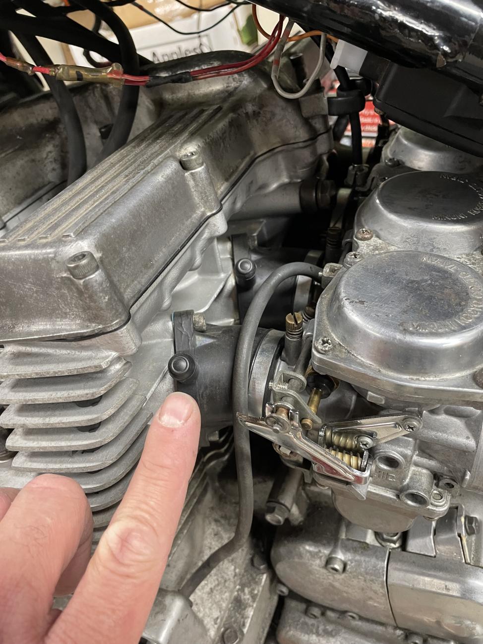

                    Sorry guys, I've been really busy. I finally got some time to work on it and I ran the bike as best I could by myself (one hand on half throttle, and the other playing with the wires) and I couldn't get anything to change. So I thought I would try and check the system from the ignition coils to the P/U coils. I tested the ignition coil as per manual and I got resistance between the primary side (little wires), but none on the secondary side (plug wire side). The coils wires are very hard and seem brittle. My thought is that the coils wires aren't good and made contact at certain times and not most of the time. Thoughts there? Does anyone have suggestions on where to get a coil? Places to stay away from on getting a coil?
                    oldyam80sg asked about the vacuum cap. My thought was it was this Click image for larger version

ID:	884740 or is it this? Click image for larger version
ID:	884741 Or am I completely off base? If it is different than these could you send a pic so I can address it?

                          The foist pic showing the Vac port on the intake boot between the carb(s) and the engine covered wit' a female black plug lookey just fine. (´ ᴗ`)
                          Iffin theres a plug missing or even slightly cracked (and a vacuum leak...) at any of the 4 (four) caps then you'd be surprized at how crappy these engines will run. (◕_ゝ ◕)
