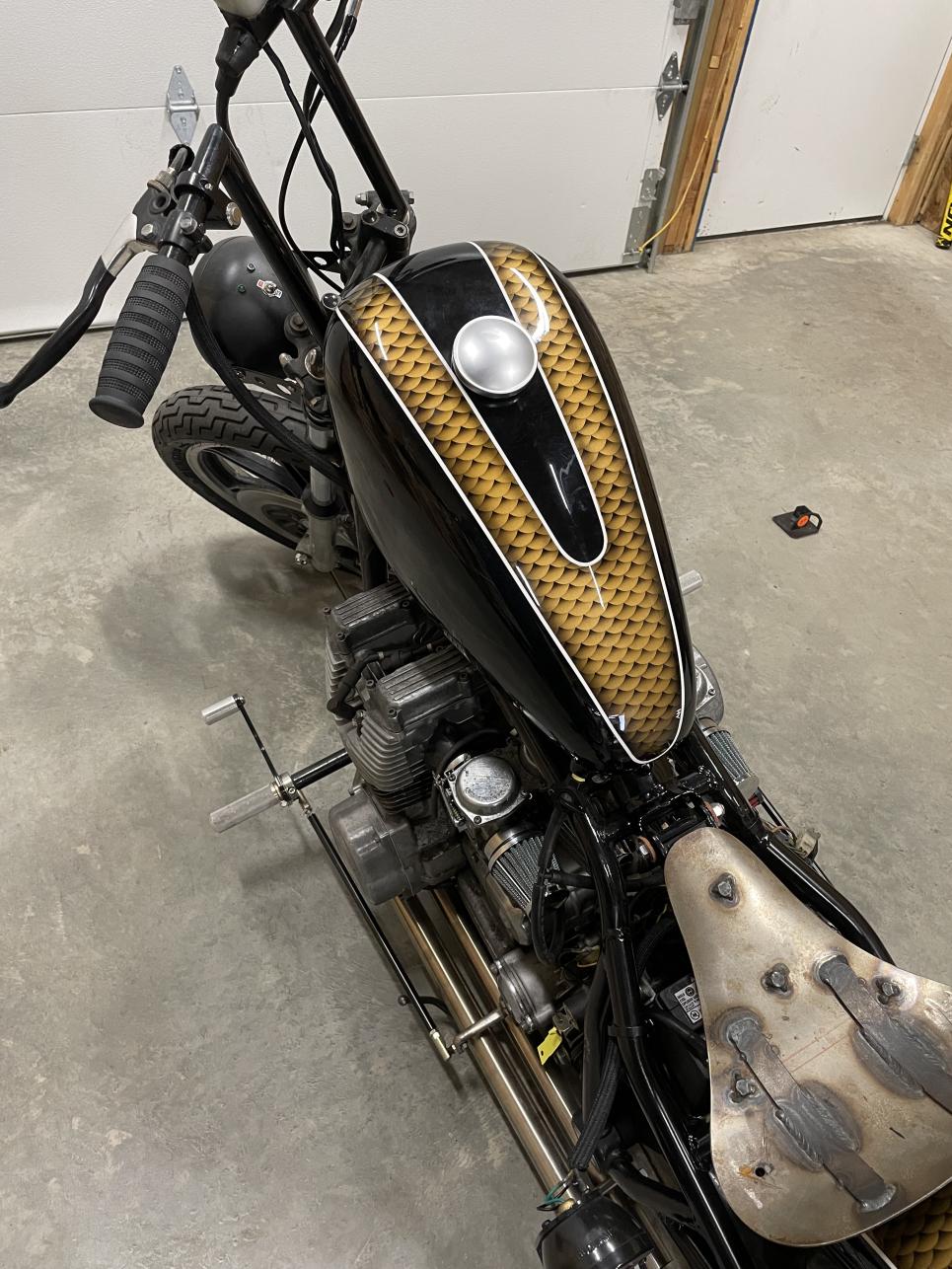

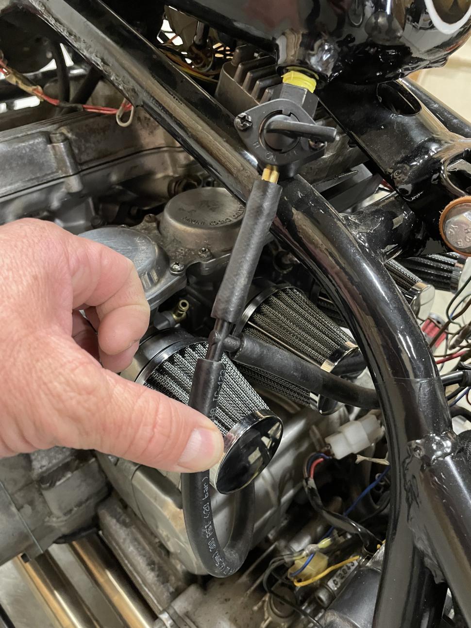

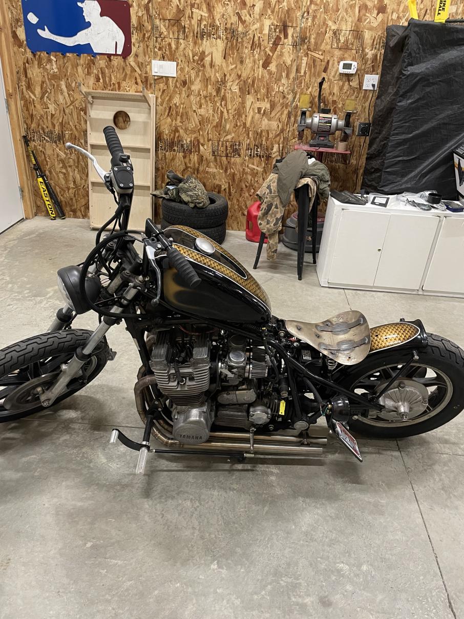

    I have a 1979 XS1100 special. I hardtailed the rear and made a chopper out of it and put a harley tank on it. I have pods and custom 4 tube exhaust with no mufflers. I had Sigma get a jet kit for me and I installed it. I also put in new diaphragms and the bike still isn't running right. I currently have a on/off/RES petcock on it (not factory) into a 1/4" hose into a T into two 1/4" fuel lines and then into the carbs. Could it be the way I have the fuel lines running? I bought a Y to try, but I figured I would ask here first to see if anyone has run into this before. Do I need a different pitcock? Two petcocks into two fuel lines? I really don't want to do that, because I have a sick paint job on the tank. At times, like twice run pretty good so not sure if the fuel lines get air in them or don't flow very well. Here is a pic of the tank. You can see the petcock down on the left side. I will try and upload some pics of the fuel line situation tonight. I gotta think some of you have run different tanks and have a fix. Please help. So close to having this project ready to ride. Click image for larger version
    It would be HELPFUL if you could provide some detail on "Still isn't running right".
    Start OK? Idle OK? Takes throttle OK? Revs up OK? All 4 pipes heat up equally?
    What about the Vacuum ports? They capped or open?
    A bit more detail would be helpful to get started. If pooping out on the highway it could be Tank Venting but if it barely runs that wouldn't do it.
      So many modifications. So many opportunities for issues. Could be carb problems (most likely). Could be ignition. Could be off a tooth on a cam. Who knows. Is that gas cap vented? Does gas flow freely from the petcock?

            I typically don't get too involved with modified bikes. As Deebs stated so many modifications it is very hard to give creditable advice. Just looking at what you have it raises a few questions. Once of which Deebs pointed out. Is the gas cap vented? You have the original carbs on the bike so the second question is they vent to the atmosphere so am assuming you know that but where are the vent lines routing too? You are running pods. Are they blocking the air intakes on the backside of the carbs. Many do. You mentioned you got a jet kit. What exactly was included and assuming they accounted for all the mods when selecting the jet sizes. Last but not least you are running straight pipes. Are they baffled or open. These bikes from the factory with stock pipes were balanced. Meaning the backflow had a lot to do with how they run. Minus that can cause issues and jetting change requirements. We need to know more in order to help.

                Original carbs, I assume the vents lines are the ports just to the right of my index finger in the 2nd pic. Open and no hoses on them. Pipes are straight with no baffling. I told Sigma that when they sent the jet kit.
                  Correct. (^_^)
                  Usual to put some kinda short line wit'a filter on'em but that's down the road a ways? (O_o)

                  You SURE that the lips of the pod filter(s) ain't fully or partially obstructing any of the CRITICAL air holes around the outside of the carb inlet bell? (O_o)

                    This possibly sounds like classic vapor lock perhaps caused by that suspicious looking gas cap. Try (carefully) riding it around without the cap installed. If it runs well, you have a simple gas cap issue.
                    Also, those filters look like "blocking" cheap Chinese filters. Take them off and try riding around without them for a test.
