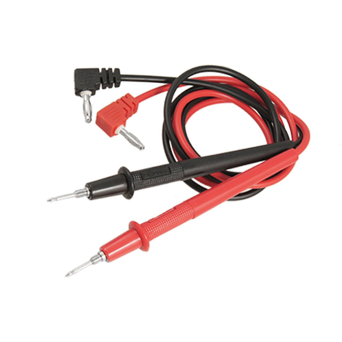

    Imma not sure what the gauge of the wires is, but I, myself, plan on using flexible silicone stranded wire. (°‿°)
    Search THAT on Amazon and you'll get tons of results but they's all in large 30 foot/60 foot spools like you's operatin' a rewiring sweatshop bidness.... ヽ(~~~ )ノ
    So? (O_o)
    Click image for larger version  Name:	Best wire.jpg Views:	0 Size:	102.6 KB ID:	884591
    Imma gonna cut the ends off of a spare test of test leads like shown above and solder them in. MUCH mOaR flexible and bendy. (〜^∇^)〜

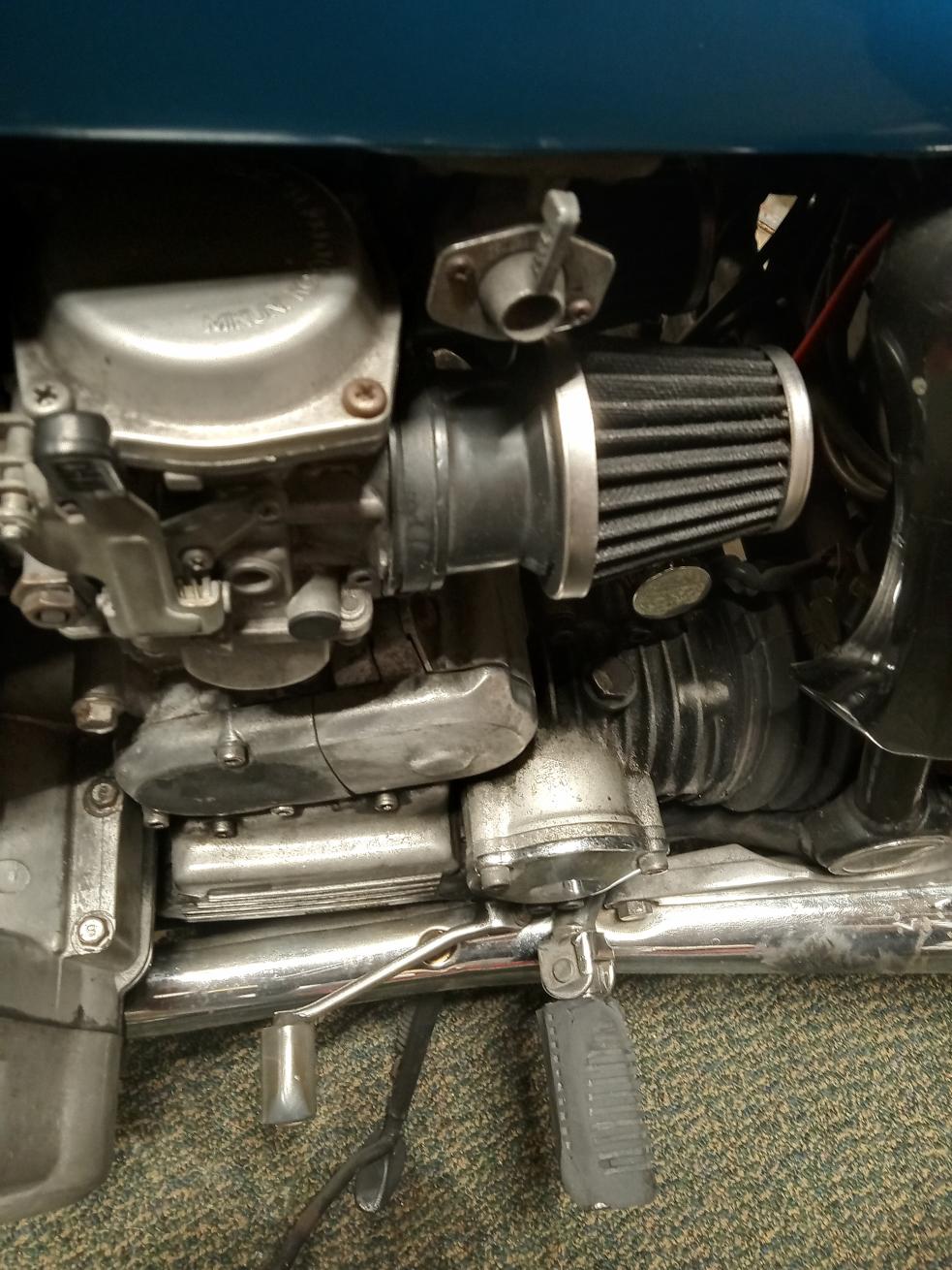

      Yes. Cheap filters plugging the air jet for the mixture. Running with the choke on only made it worse (rich).

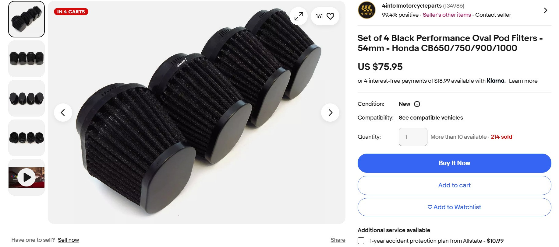

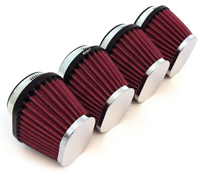

        Do you guys have suggestions as to what and where to get the correct pod filters?

            https://www.ebay.com/itm/182441474639
              Before you buy filters please try to remove your filters and take the bike for a short ride.
                Some of us make velocity stacks out of the old air box inlet tubes in order to use the cheap pod filters. No blockage that way.

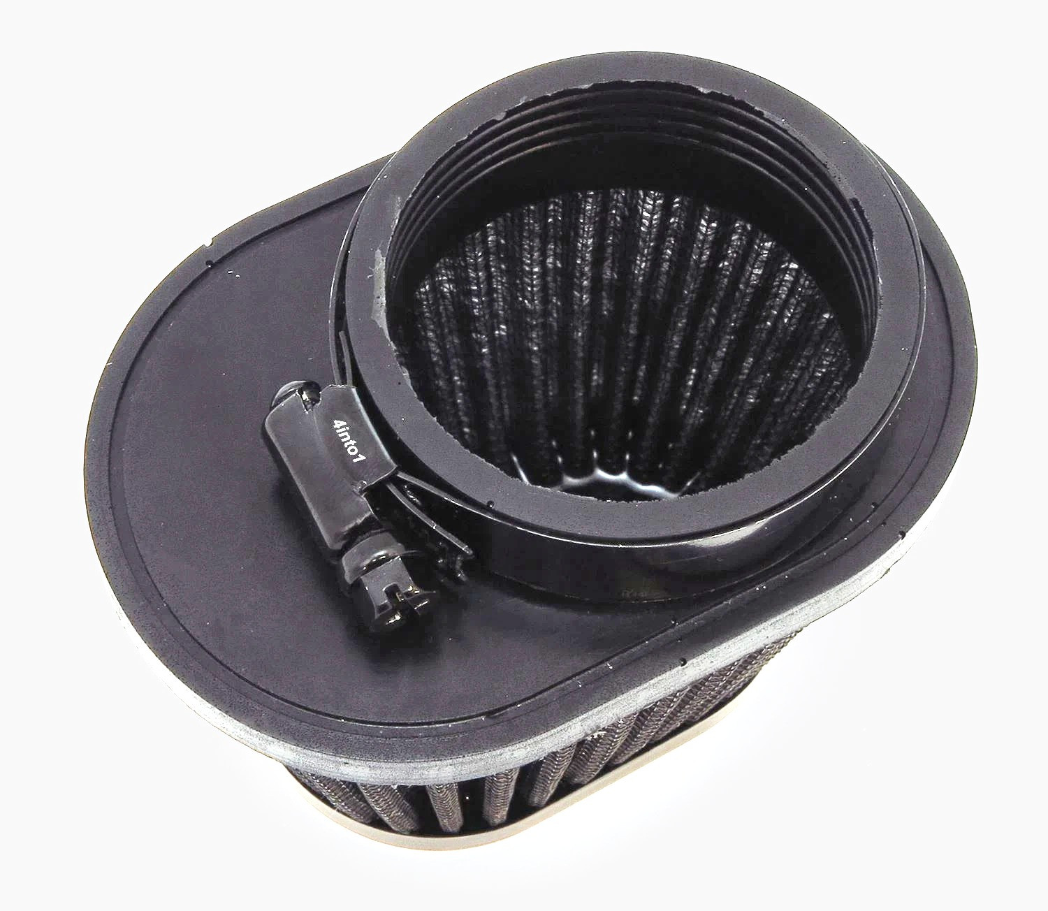

                  Note: You may want black filters instead of red. These also do not block the air holes.
Name:	Blak filters 54mm.jpg
                    No block design.
Name:	Black filter no block.jpg
                      I've seen videos of people modifying the cheap pods by taking a Stanley knife or similar sharp instrument and cutting away the lip on the filter to keep it from blocking those small ports, might be worth trying!

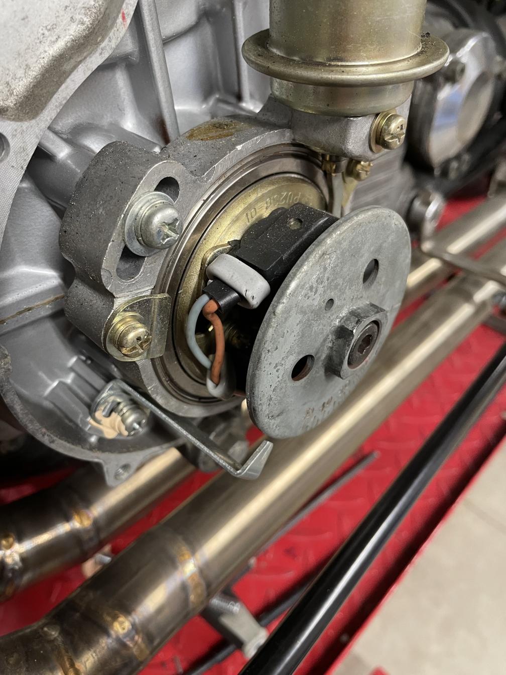

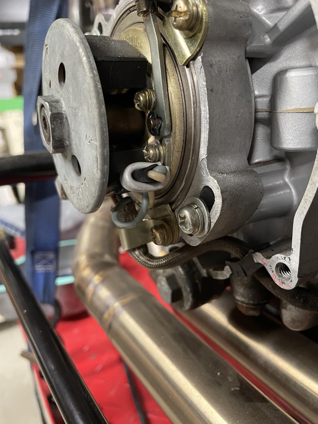

                        I took the cover off last night and looked at the wires gave them a stretch and they seemed fine. Can you guy tell me which of the P/U wires runs the coil on the left side (the one that runs the 2 outside cylinders) of the bike? There are 2 wires at the front top Click image for larger version
ID:	884605 and 2 at the bottom rear Click image for larger version
ID:	884606 of the P/U coil. I was going to chase the wire up from the P/U coil to the main coil. I am thinking it is a wire problem to the coil or the main coil itself. This weekend I am also going to take the main coil off and check it as well. I do have a manual and will check the ohms on both sides.
                          Umm....but did you do this whilst the engine wuz running? (O_o)
                          I do this while running but alls the poking/pulling ain't done wit my fingers. I use a crochet hook fOaR safety. (^_^)
                          Working theory is that iffin' the wire strands are making/breaking contact INSIDE the insulation where's you can't see? (O_o)
                          Yoinking the wires this way and that will cause the two cylinders affected by that wire to drop out/drop in. (O_O)
                          Suggestion- RETEST whilst RUNNING....... and do it CAREFULLY whilst the "questionable" Pod filters are removed. (_Oo)
                          AND iffin there's a hard failure of either ignition coil, P/U coil (or wires...)? (O_o)
                          RUN it and spray the exhaust pipes. If it's the left side coil then #1+#4 will be COLD. Right side coil then #2+#3 will be cold. AND on the opposite coils/cylinders that be working right they'll be Hot....EXTRA hot. (´_`)

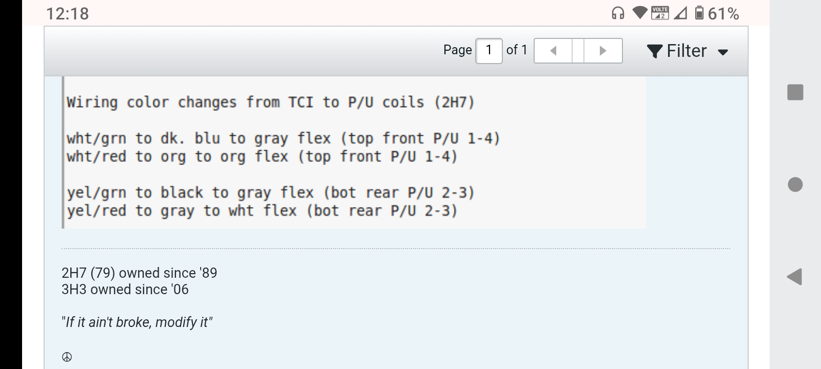

                            The top P/U coil is cylinders 1+4, the bottom is 2+3.
                            This is the path of the harness starting at the TCI and ending at the P/U coils...

                              Do not remove the pickup coils. You will not be able to just bolt them back in. They do not wire to the main coil. They wire to the ignition module who then sends grounding signals to the coils (the coils always have +12v when the key is on).
