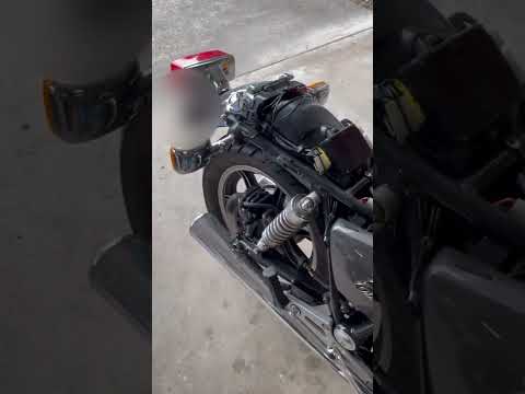

            EG: Level is too high in #3 and so's the fuel just splatters in/over thu the needle jet/emulsion tube hole when engine is running. (╯°□°)
            Imma sure you set the float heights correctly. But the point is that SO.... DID... I... and the fuel levels were at the levels shown in the photos. AND the engine ran similarly/like THIS-
