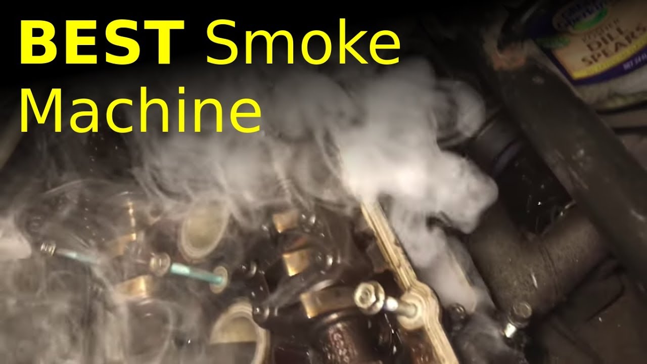

        IMHO, wrong method to ID or locate "vacuum leaks." ( •_•)
        Dunno how many farking times I've heard this from peoples and then I've gone over IRL wit' my own DIY smoker and SHOWN them MULTIPLE vac leaks.... (-‸ ლ)
        Sumpthin' like shown here-
        Not sayin' yur prob actually IS a vacuum leak but iffin' we's gonna move forward we GOTS to be sure... ( •_•)
