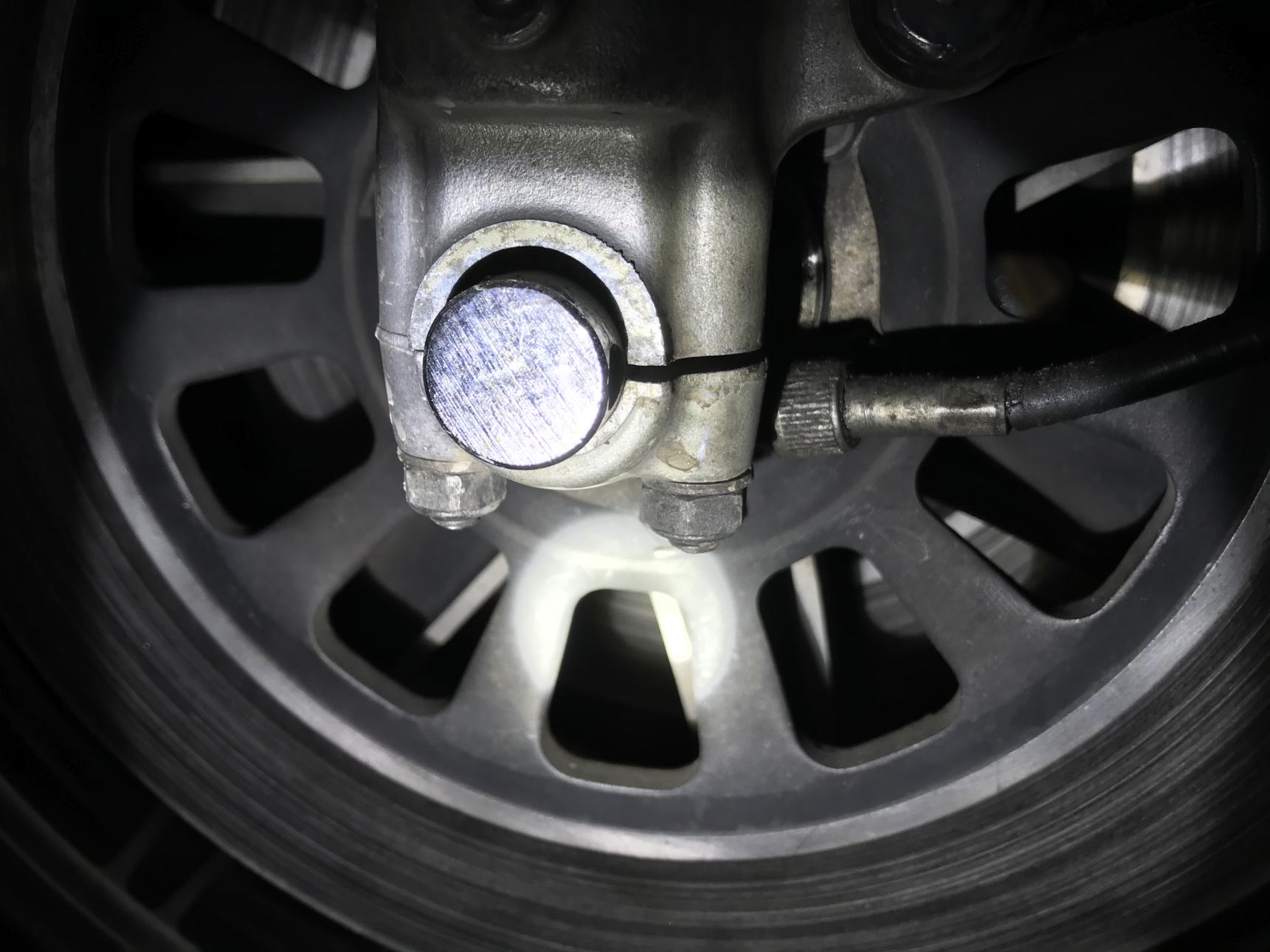

        Ccitis - you're likely on top of this, but I'll just mention it anyway. Be sure your front axle clamp is tight to the base of the fork slider at the front and the gap is at the rear. This slight variation can really mess up your front end by throwing off your handling, possibly having and effect on gyroscopic precession at high speeds.
          I am trying to understand this... all advice is welcome. You are saying on the left side where the clamp is, there should be a gap?

            What LenB wrote has merit. Take a look at where the fork clamp meets the axle. The front edge of the clamp should sit directly in contact with bottom of the fork leg, there should be a gap left on the rear side of that. The front nut gets tightened down first and the rear nut after that.

                Originally posted by LAB3
                I've used it on tube tires
                Got it. Will check and torque appropriately

                  Just like this....
