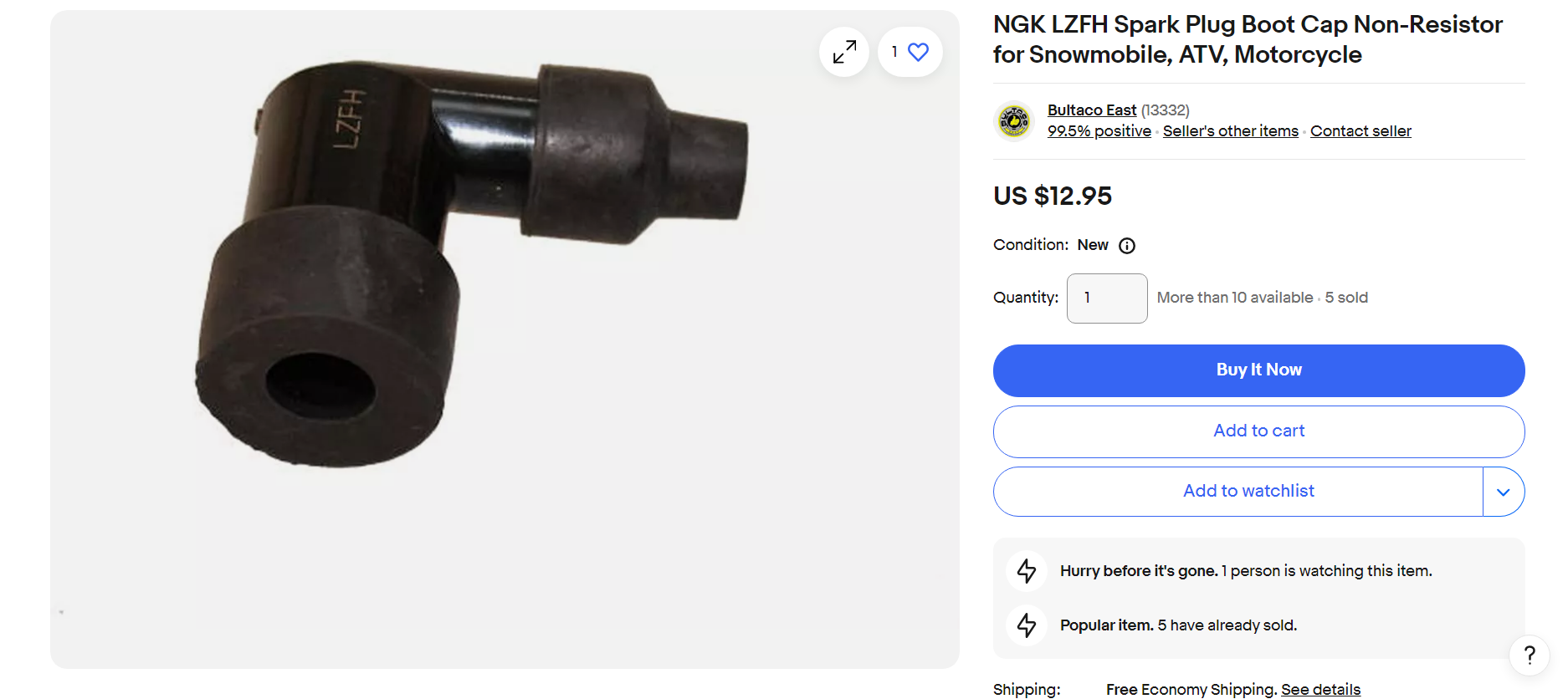

    My 6k miles bike has new NGK BPR6ES plugs and the caps have resistance of aprox 4k ohms on outer 2 and 8k on inner 2. Is there an alternative to those spark plugs that aren't resistor? I did cut back on the wires for new core connection. Bike runs fine but would like to get non resistor plugs if possible.
    Thanks!
    8k is too far out of spec
    Champion still makes non resistor plugs but the part number escapes me at the moment
      4 of these would take care of the problem. Zero ohms. No resistor.

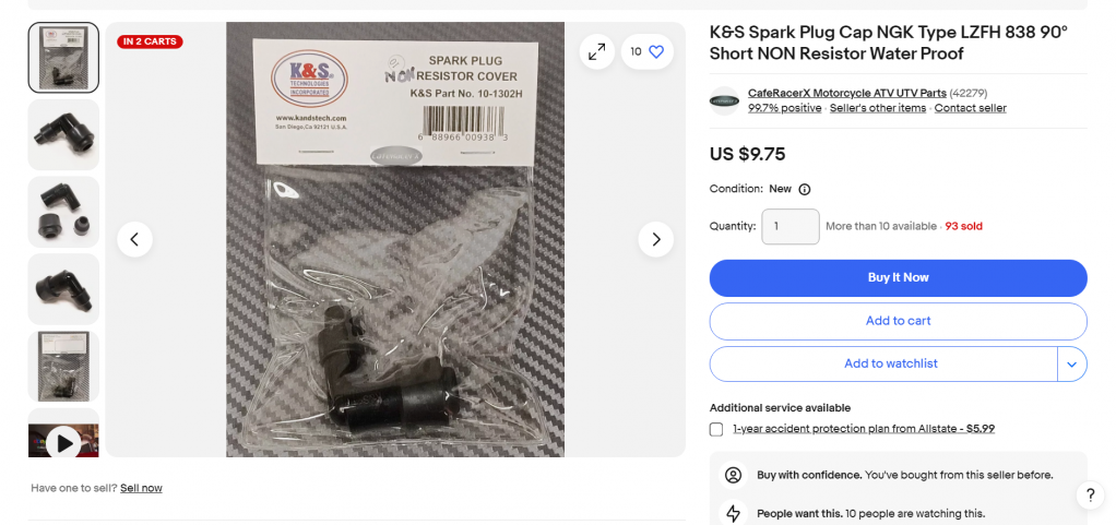

          You can also buy the NGK non resistor caps at most auto parts stores. You may need to order them, but it's only a few days.
            The NGK would be better quality.
            https://www.ebay.com/itm/16707219539...Bk9SR577jYGFZQ
Name:	Opera Snapshot_2025-01-02_123307_www.ebay.com.png

              Agh! I already ordered!
                They will still be good. Will last for many years. I have used those on a few jobs and they work great.
