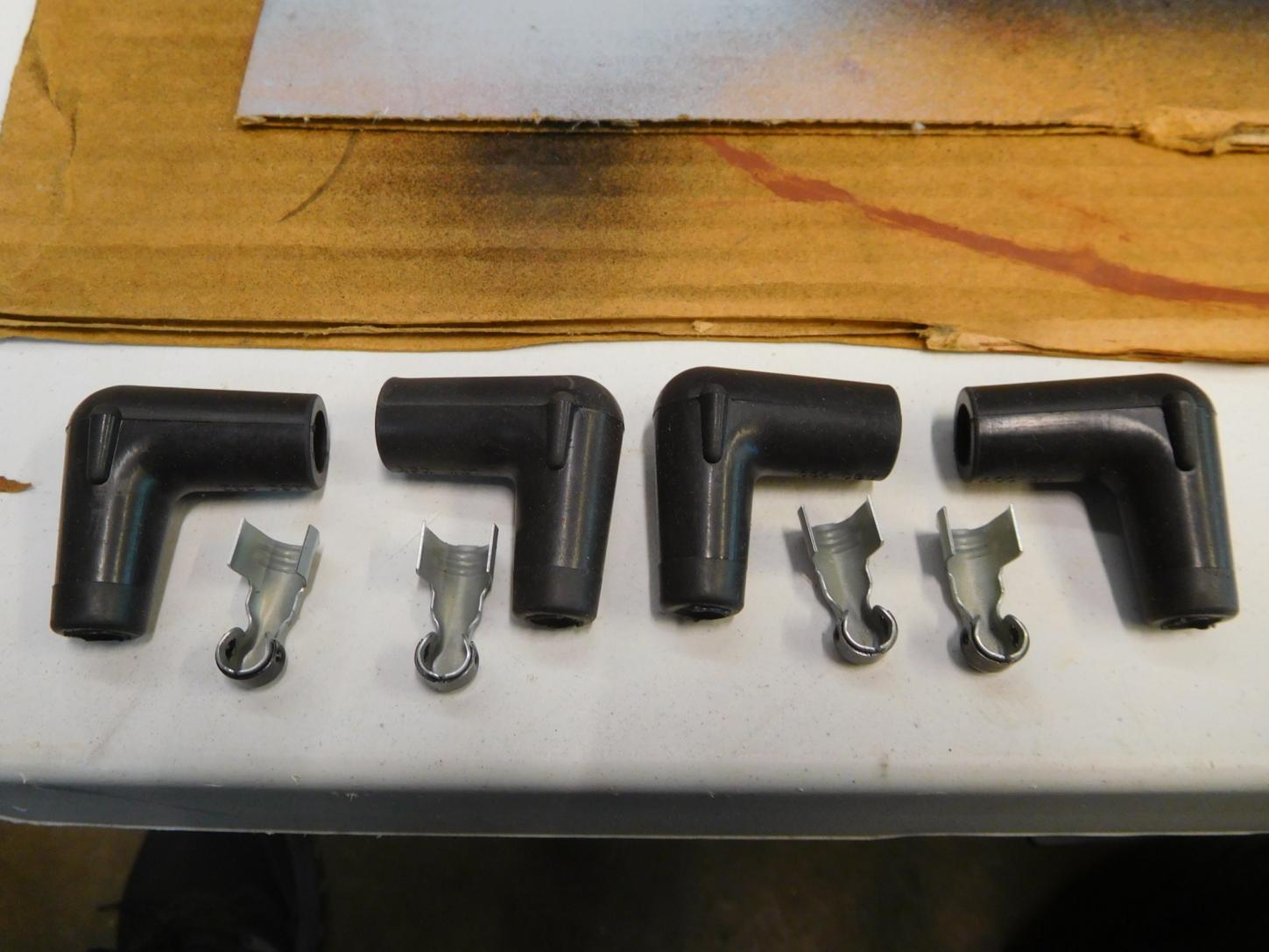

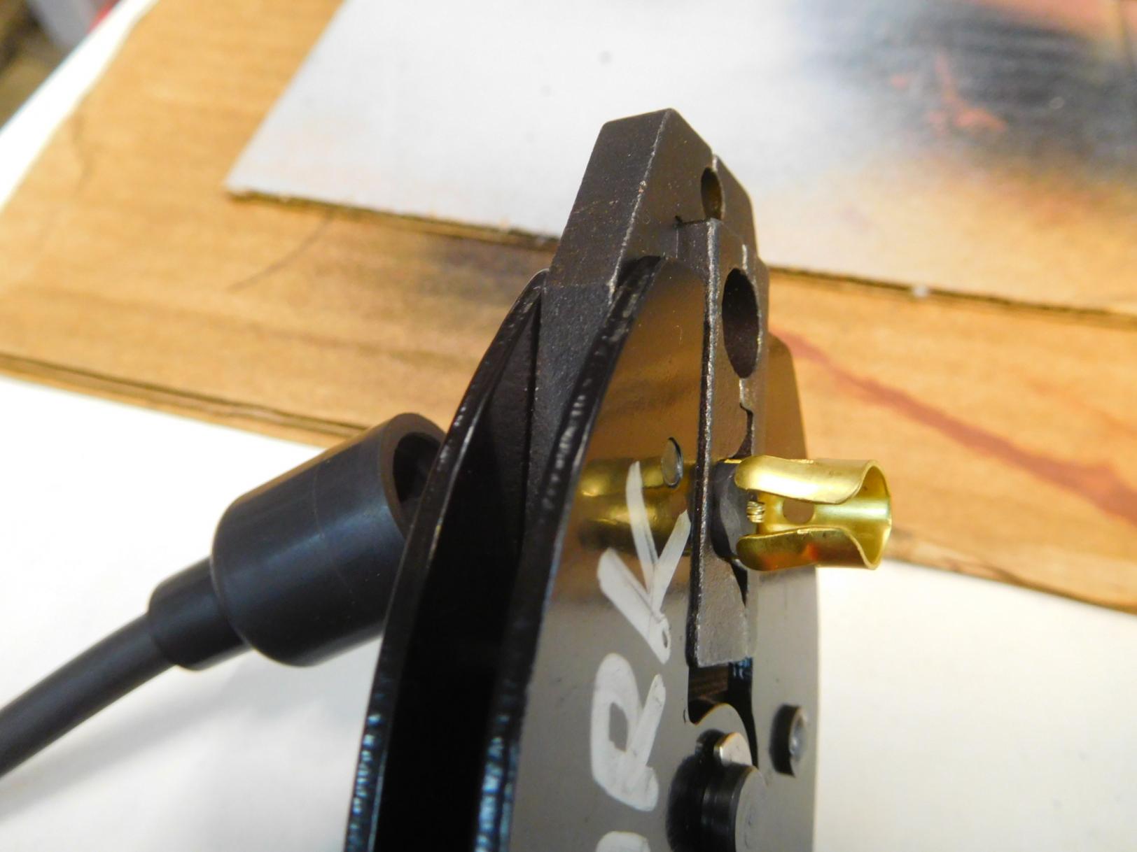

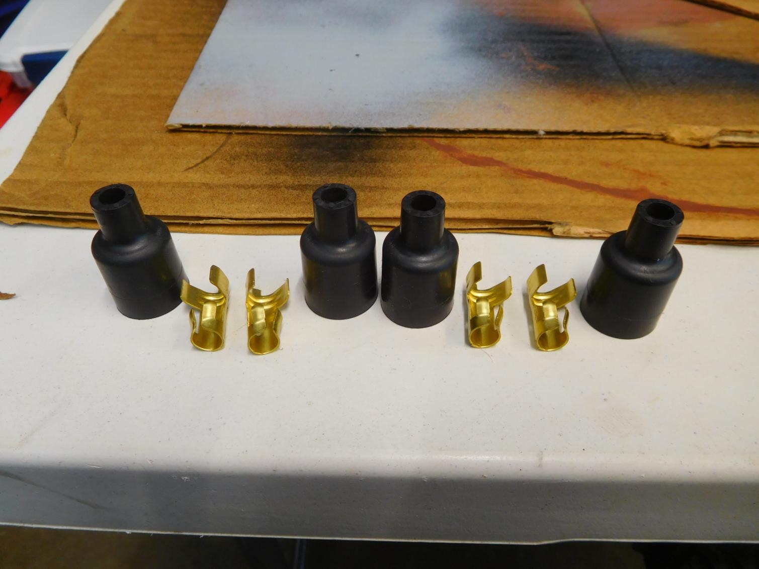

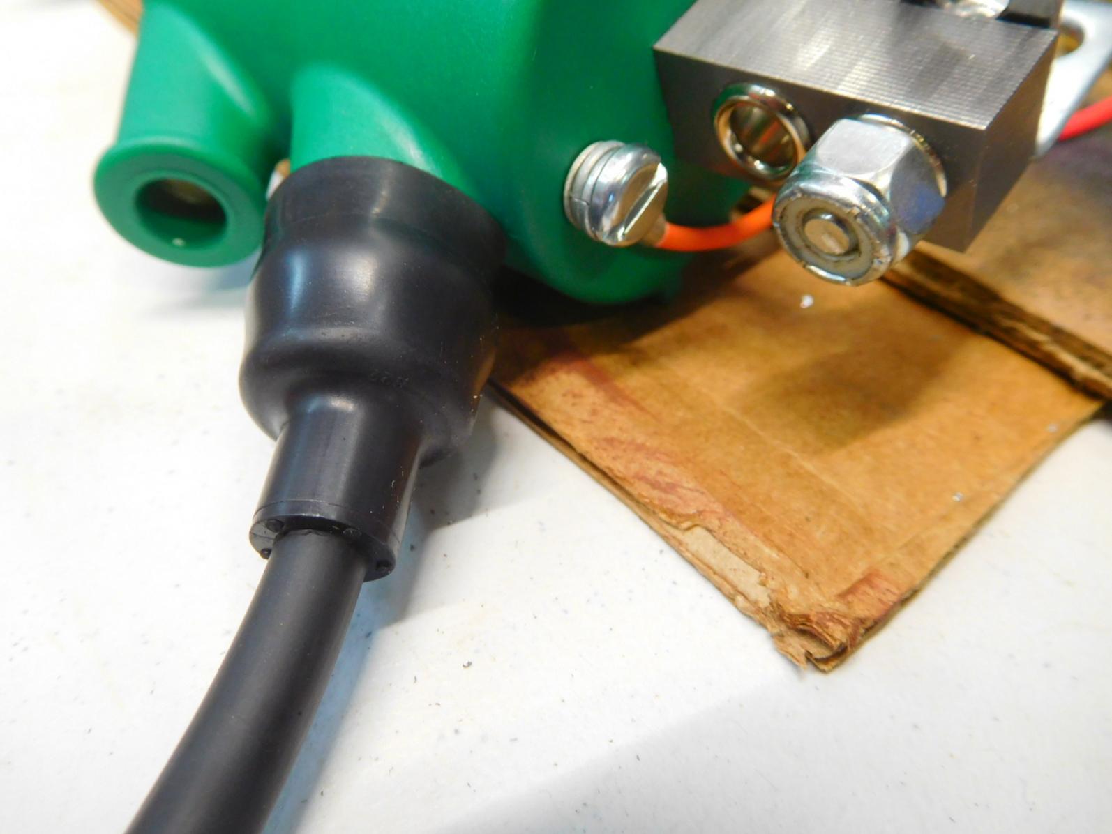

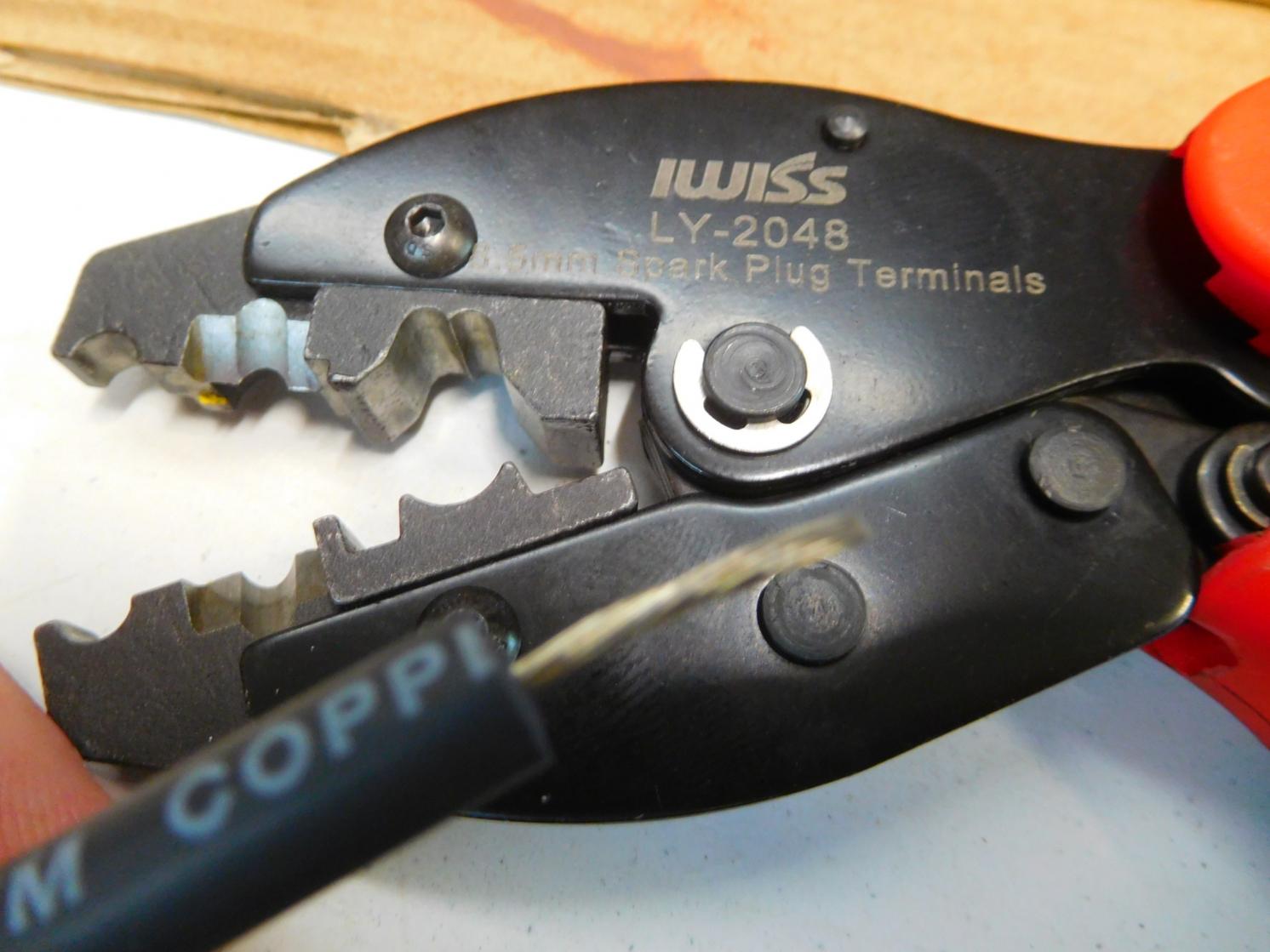

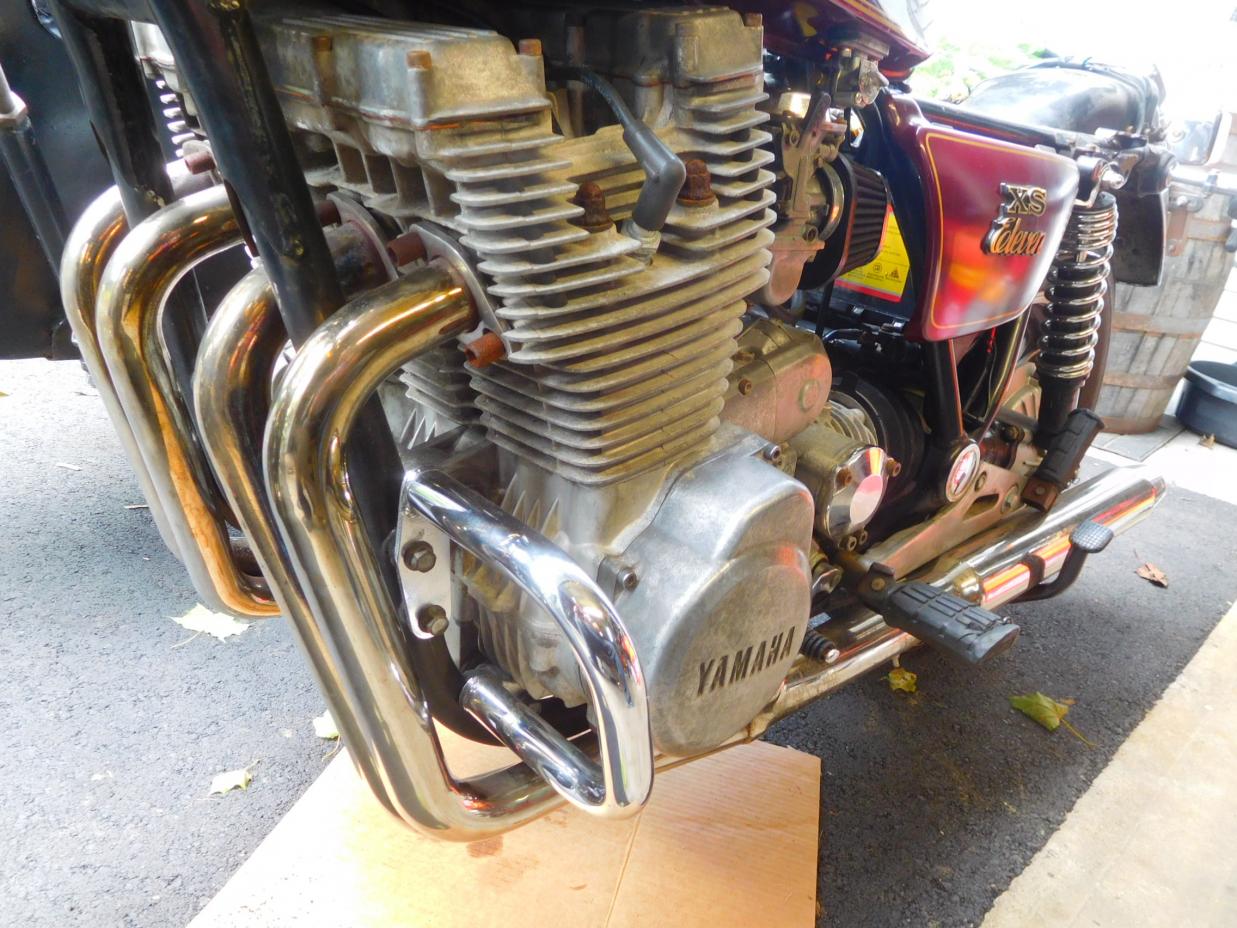

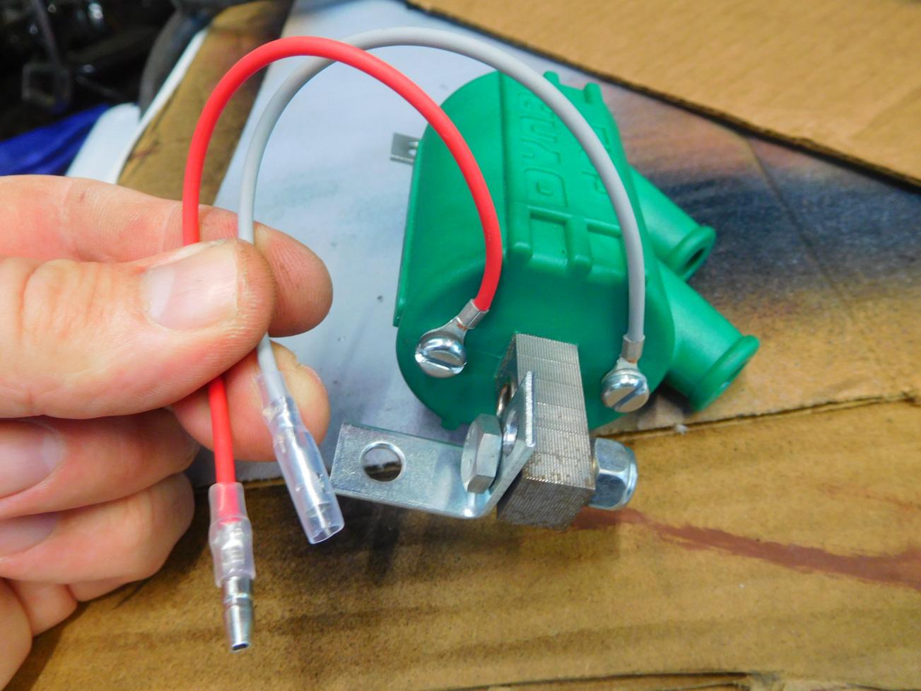

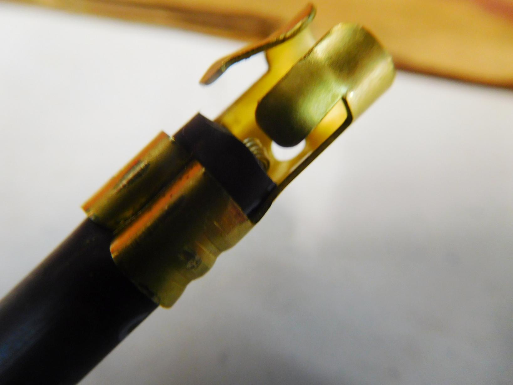

      I use this type. No resistor. If you make it yourself you know it's quality. Ton's is the vendor for parts.
ID:	882765 Click image for larger version
ID:	882766 Click image for larger version
ID:	882767 Click image for larger version
ID:	882768 Click image for larger version

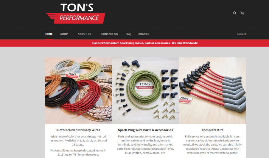

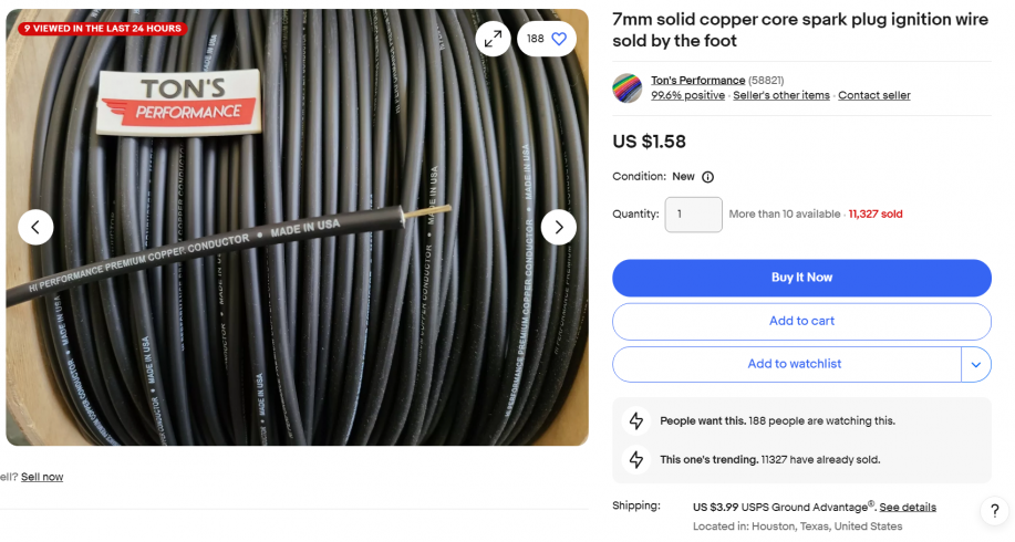

        Various aftermarket parts and accessories for the automotive industry. Parts include spark plug wire sold by the foot, vintage cloth braided primary wire, motorcycle handlebars, Harley Davidson relocation kits, and more!
Name:	Opera Snapshot_2025-01-08_162538_tonsperformance.com.png

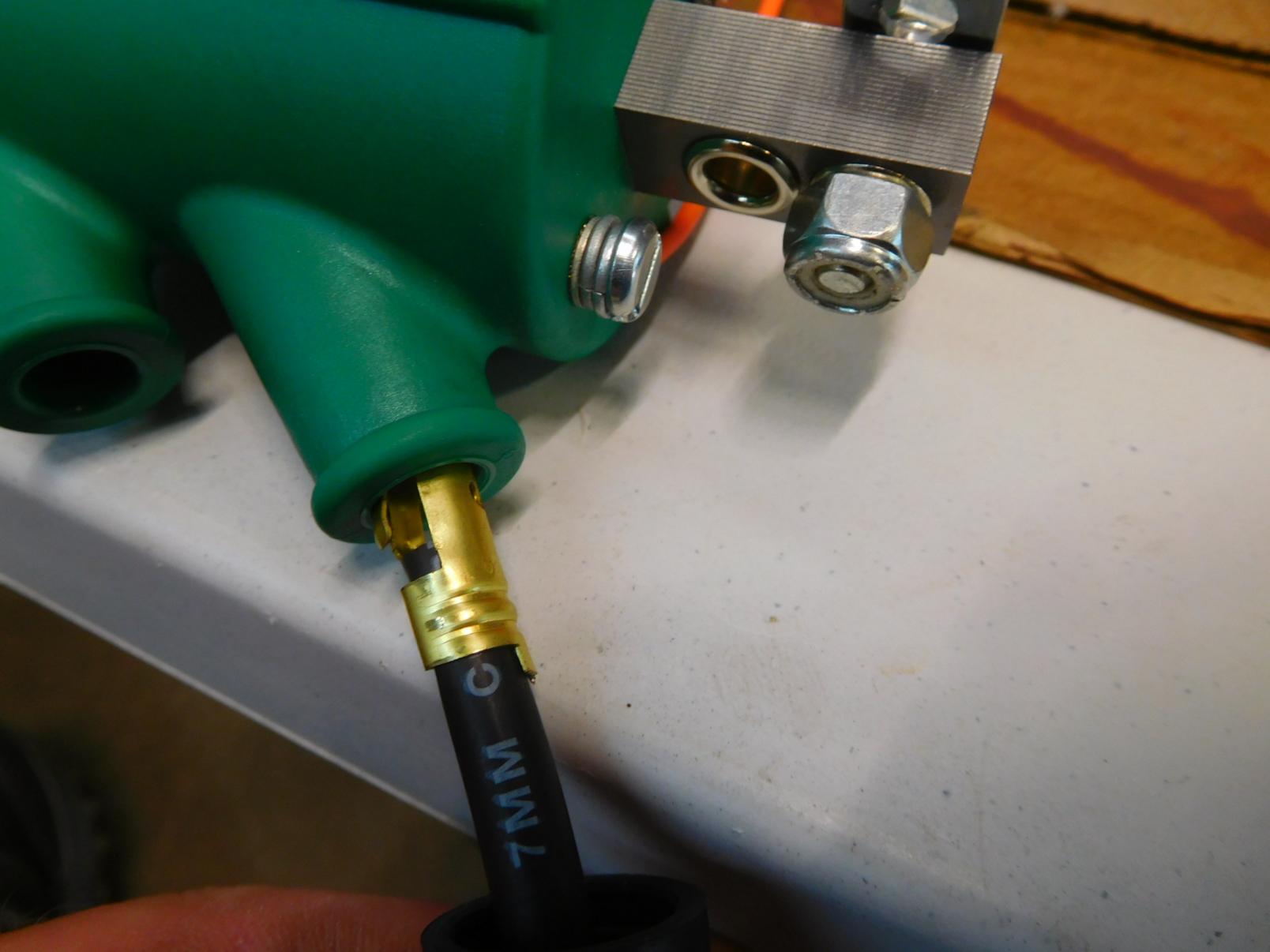

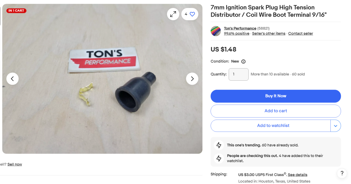

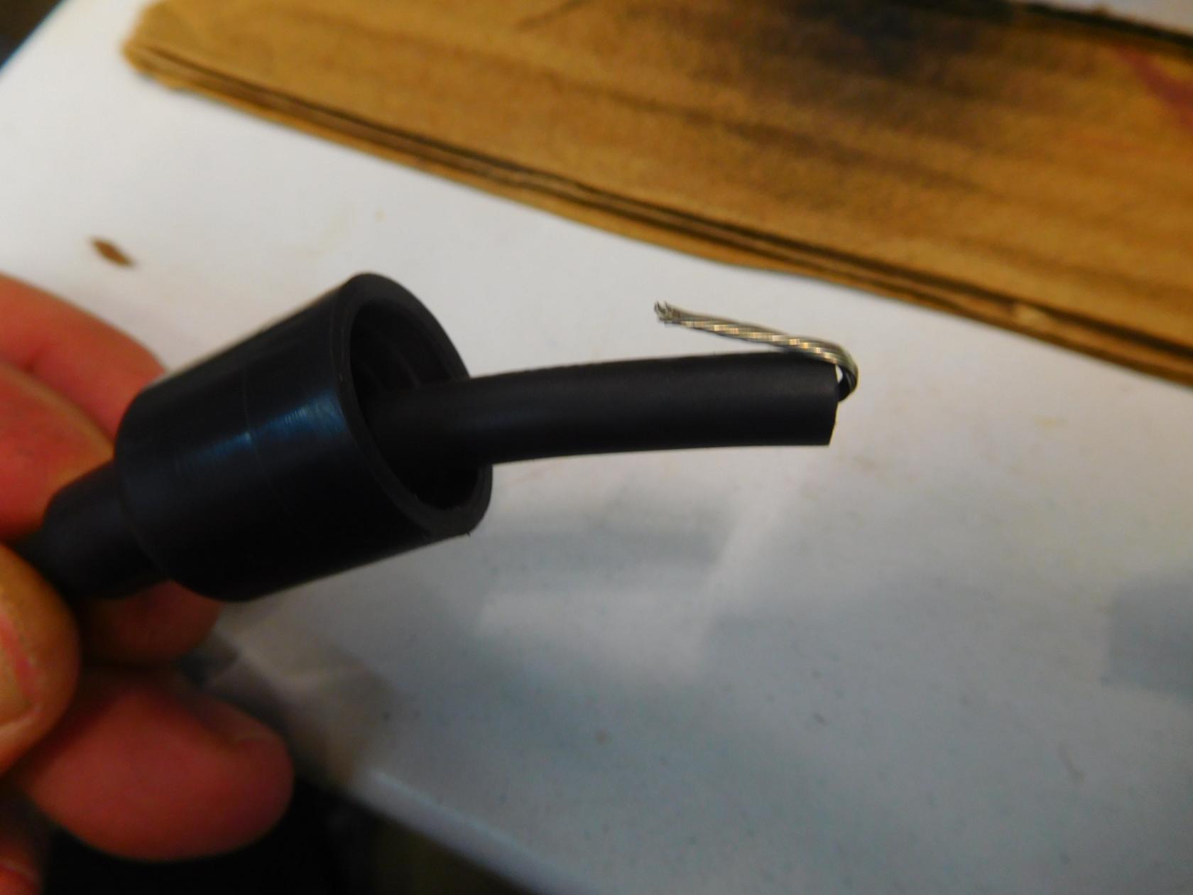

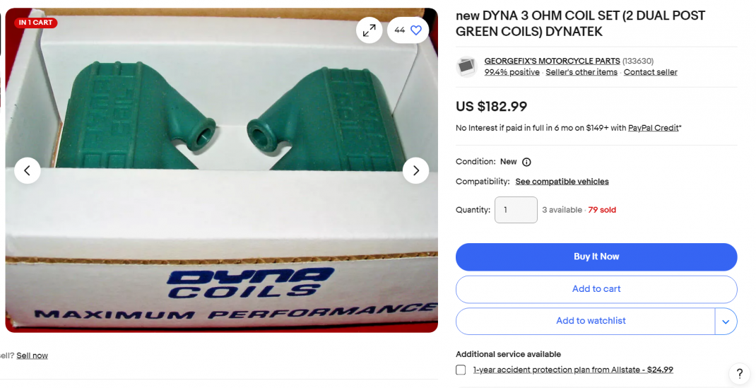

          Here are parts from eBay to do the job. You could use your stock coils if you solder the high tension wire to about 1/2" of clean wire sticking out of your coil. The bad parts of old wires are obviously the ends that screw into the caps which get corroded and can be cut back slightly until you see clean wire but the real culprit is cracked insulation which you sometimes can't see with your eyes. All you need is about a 1/2" of clean wire sticking out of the coil. Make sure the repair is wrapped with insulation and heat shrink for a professional repair. The cutting into the coil stuff is unnecessary. I did this type repair (actually many old bikes) to a CB550 about 25 years ago and he brought it in last year for leaky top end gaskets and to this day the wires are still like new. However, the 3 ohm Dyna coils with no ballast resistor is the way to go for top performance on an XS11.
          Click image for larger version  Name:	Opera Snapshot_2025-01-09_120543_www.ebay.com.png Views:	0 Size:	395.5 KB ID:	882796 Click image for larger version  Name:	Opera Snapshot_2025-01-09_120013_www.ebay.com.png Views:	0 Size:	533.3 KB ID:	882797 Click image for larger version  Name:	Opera Snapshot_2025-01-09_120244_www.ebay.com.png Views:	0 Size:	465.5 KB ID:	882798 Click image for larger version  Name:	Opera Snapshot_2025-01-09_121253_www.ebay.com.png Views:	0 Size:	225.0 KB ID:	882799 Click image for larger version  Name:	Opera Snapshot_2025-01-09_120644_www.ebay.com.png Views:	0 Size:	408.1 KB ID:	882800
ID:	882803 Click image for larger version
ID:	882807 Click image for larger version
ID:	882804 Click image for larger version

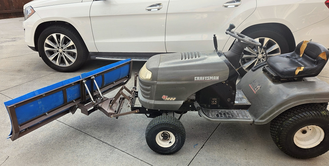

                  cajun, like ALL things, moderation! I usually just smear a thin film on the lip of the boot, and it makes it easier to remove a few years later on things like the riding lawn mower/snow plow I have. Click image for larger version

                    I love that LT1000. I have a green one. Mine would smoke a little on start and I traced it to the head gasket. There was a breech right here. It's a common problem with lawn tractor motors.
