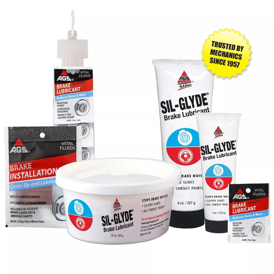

                      Cajun31 I also use Sil-Glyde. Great stuff.

                        Great stuff too. I have a tube of that too. Just don't let it get on the rubber parts.
