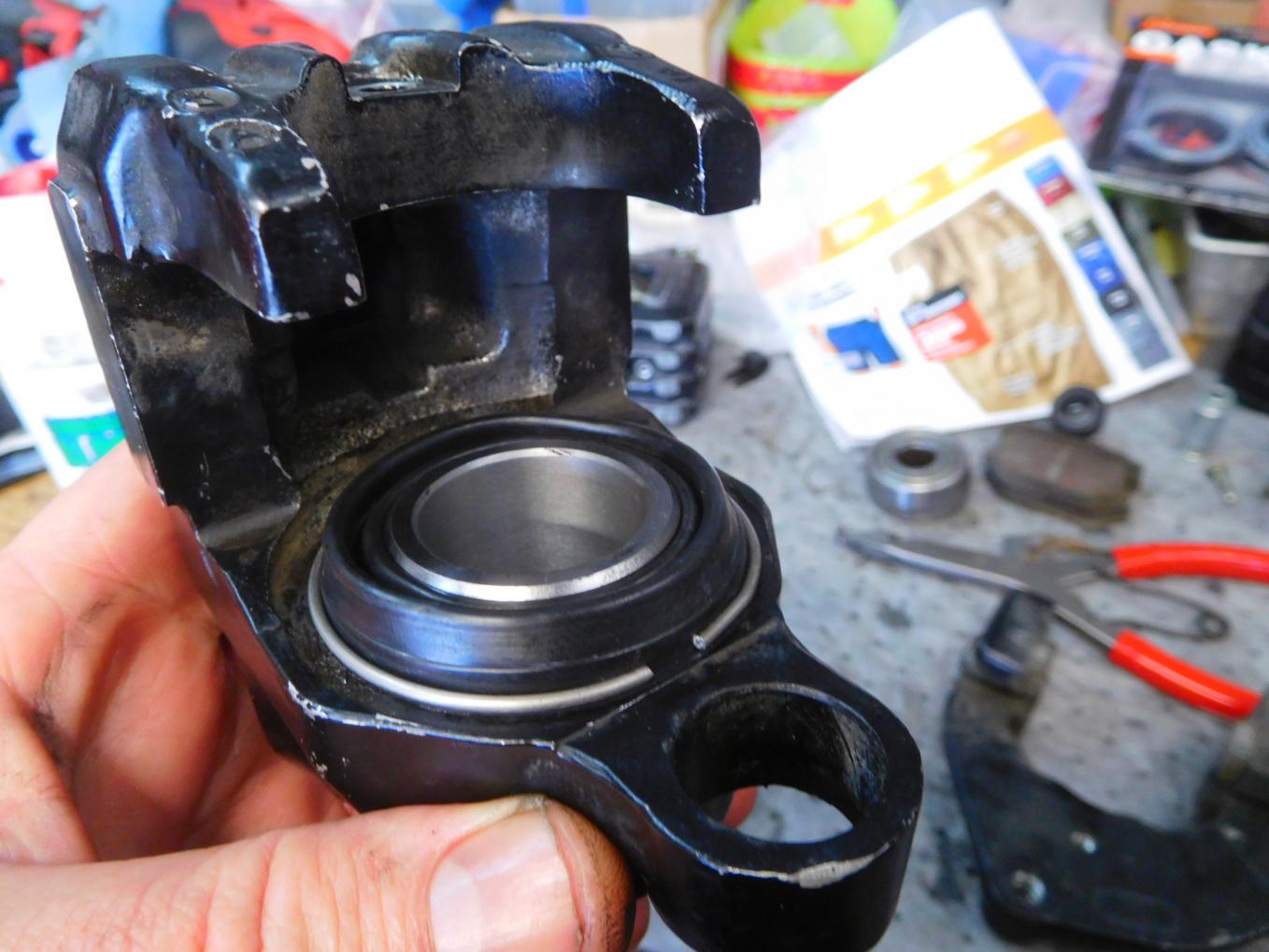

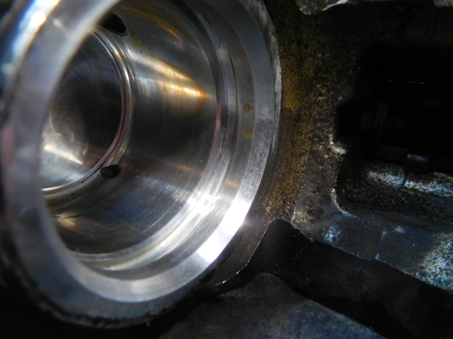

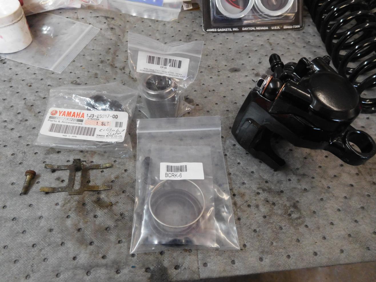

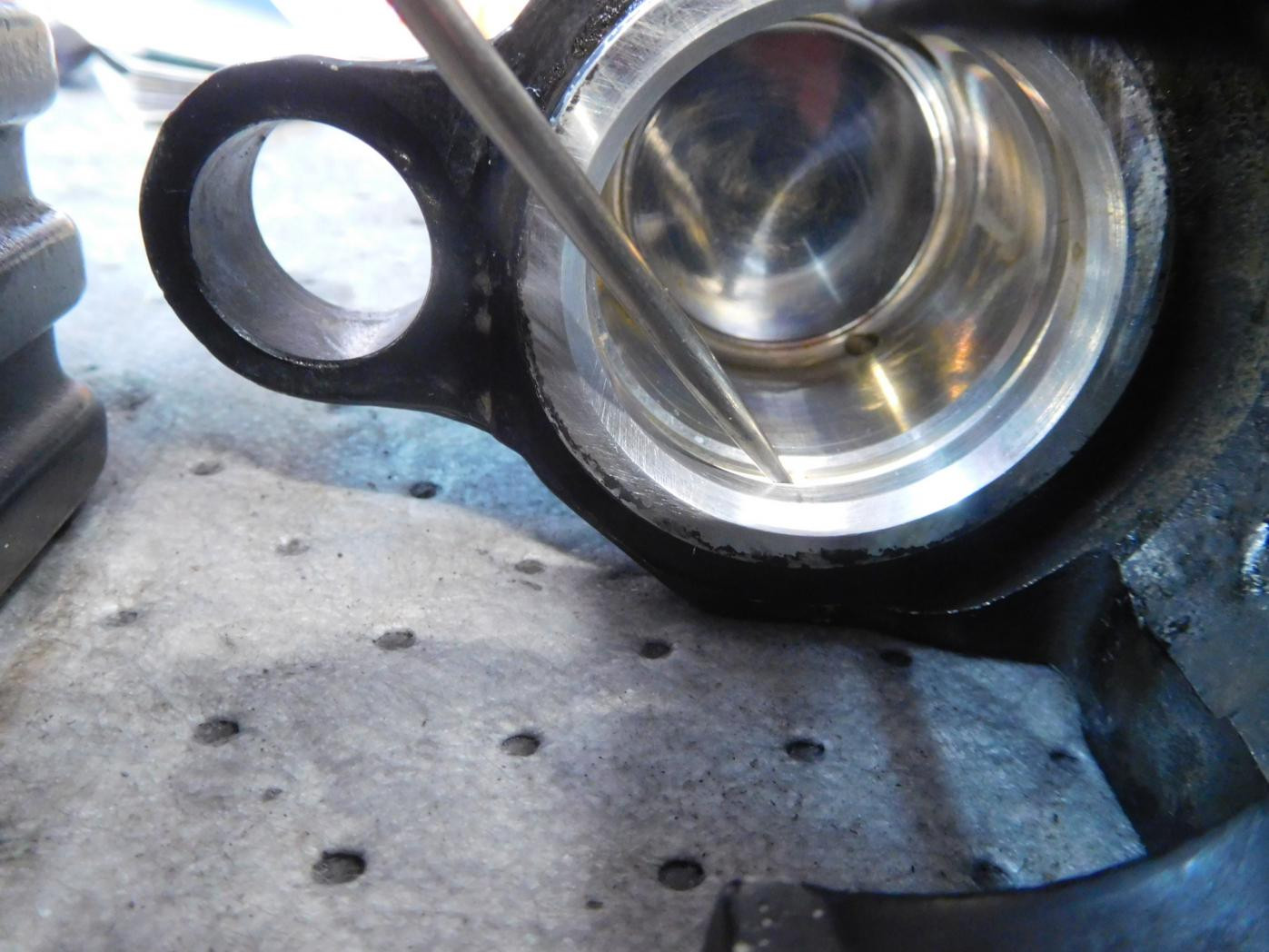

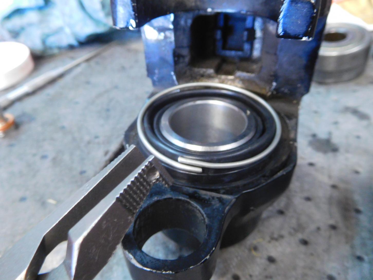

                    I must have done a hundred bike calipers over the years. It's as common a problem as gummed up carbs. Moisture forms (from years of not changing the brake fluid) under the caliper piston seal and caused aluminum oxide. It's white and powdery. It reduces the inner diameter of the bore and squeezes the piston. You grab the brakes and the hydraulic pressure is strong enough to push the piston out but it will not return.
                    You can take the seal out and clean out the corrosion with a pick and the re-assemble. It always works.

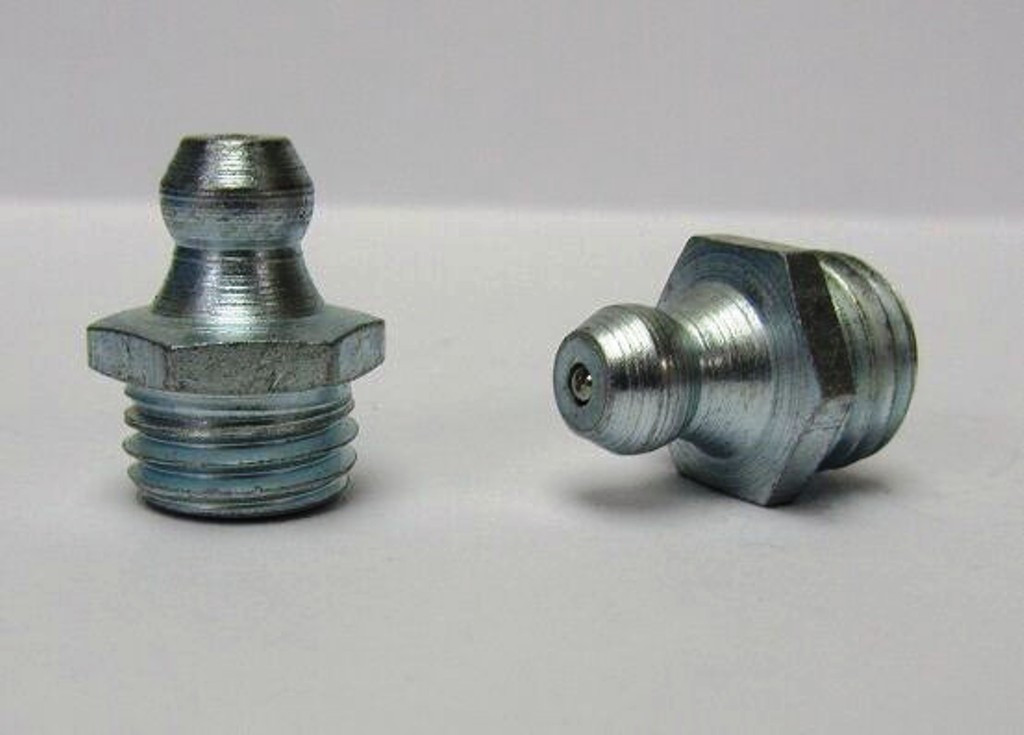

                      To get a frozen piston out you will need a metric grease zerk and a grease gun.
                      https://www.ebay.com/itm/181715388977

                        Clean here.

                              Do you know what size zerk that is?
