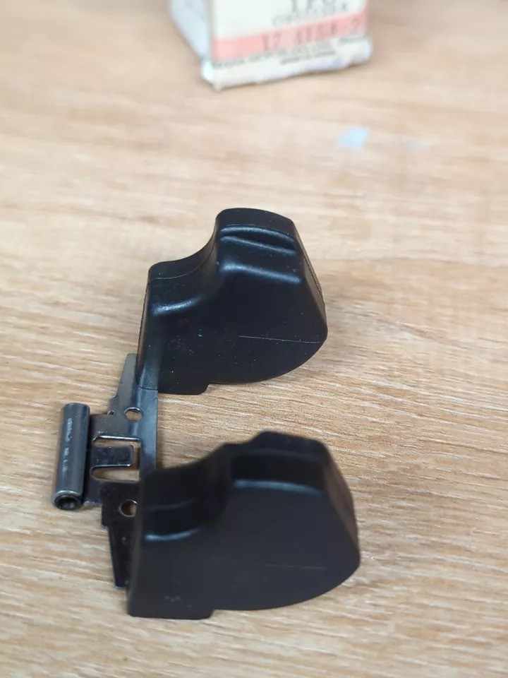

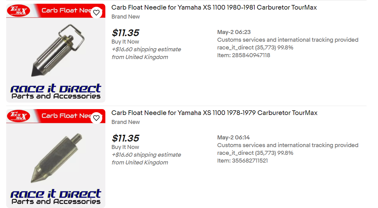

          I don't think you can swap brass and plastic floats. They have different float pins and seat. This is why you are having issues. Has this set up ever worked in the past?

            Thanks everyone for your input.I fitted the plastic floats some years ago as my brass ones were bad and information at the time said that plastic floats would fit but float height was ambiguise.I have experimented with the heights but no difference.Have them set at 23mm and the bike runs very strongly when it's going.I bought the bike as a standard with no known changes although it had been reringed at some stage.I ended up having it bored and fitted a big bore kit back in 2013.The big bore didn't affect the starting and mixture is fine.This has been a developing problem over the last several months.

                I've done plastic floats in early carbs with '82 Virago 920 viton tip needles and seats. A little bending needs to be done to the floats, but if done right, it's a good mod. I set the floats as you would on an '80 at 23mm.
