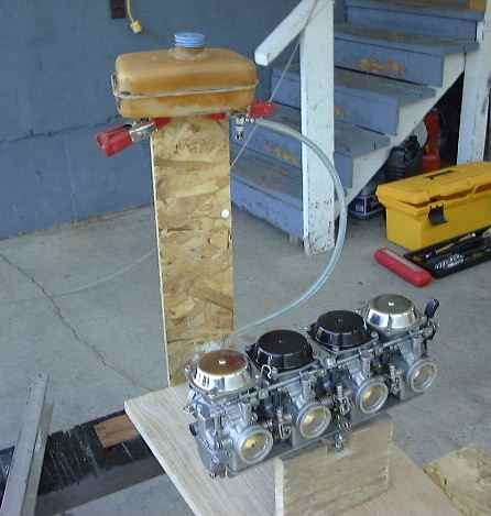

    That is, until today. How's this for a bit of bush league carpentry to make
    this job a whole lot easier?
    The tank cost me five bucks at a lawnmower repair shop. The rest was
    scraps I had laying around. Here's a view with the carbs sitting behind the
    main apparatus.

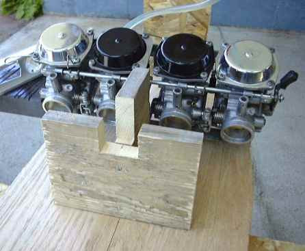

    The board going left to right holds the bank-o-carbs level side to side.
    The rear piece holds them level front to back. One of the benefits
    of this rig is you have real easy access to the bleeder screws and it is
    easy to get the tube up against a float bowl for checking.

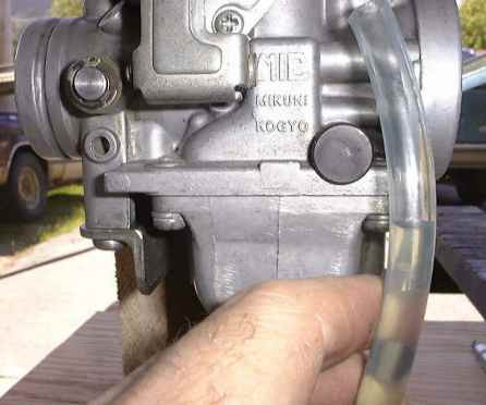

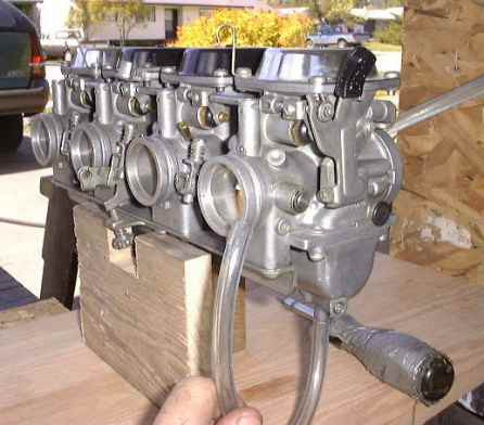

    If you have to reset a float, it is easy to tip them back over to drain the
    gas, pull off one float bowl, perform the adjustment, put it back together,
    and retest the level. And finally, an action shot....
