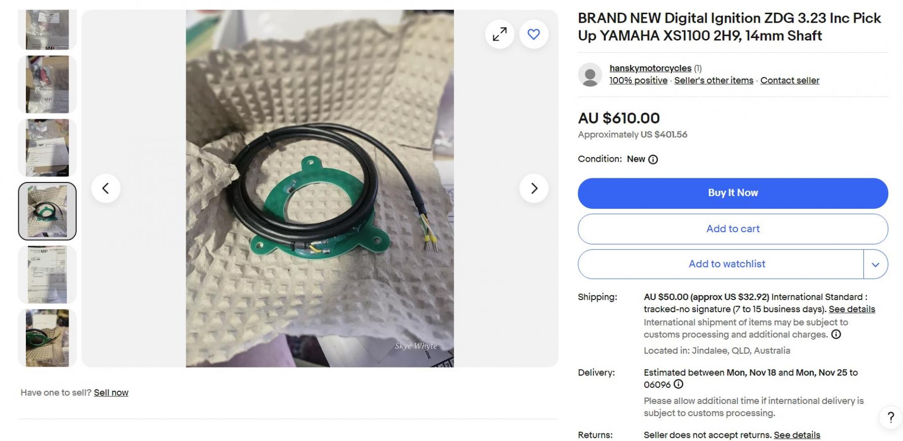

Digital XS11 Ignition
    • 2057
    https://www.ebay.com/itm/36522463181...Bk9SR4L826XjZA

    That one has been linked here before. Here's the manufacturer link:
    Digital ignition system for Yamaha XS1100, replacement for the original electronic ignition and advance unit. The vacuum advance won't be used any longer. Most models have a 15 mm shaft diameter. The 2H7 and 2H9 models have a 14 mm shaft...

      Anyone fitted one up, and if so, what benefits have you experienced?

        My problem with the looks of that is wire flex. We KNOW why the old pickup coils failed, and the wire used does not look like the "flexible wire" needed to keep things from breaking.
        I may need to look into building one of my own, that would meet MY specs for reliability.

          Ray,
          This system basically eliminates the manual vacuum advance. No moving parts so no wires moving or flexing. Z18-14-en.pdf
            • 833
            Also, the timing advance is taken care of by the TCI

                Just wanted to add a note from the site that sells it.
                Most models have a 15 mm shaft diameter. The 2H7 and 2H9 models have a 14 mm shaft, so if you have a 2H7 or 2H9 make sure you select 14 mm shaft version.
