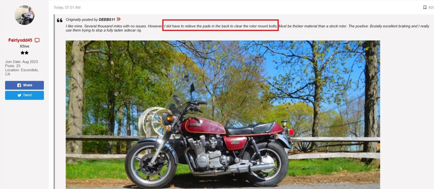

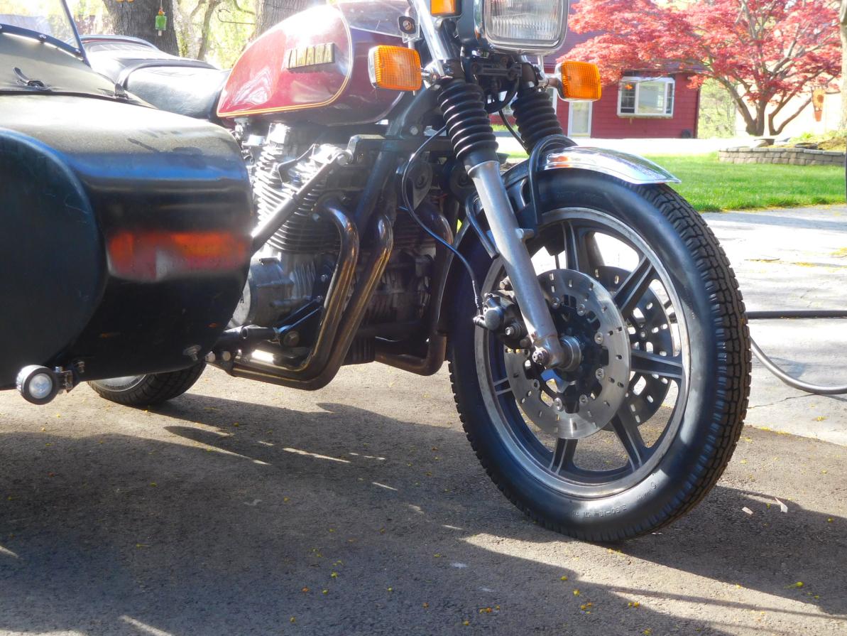

            I like mine. Several thousand miles with no issues. However, I did have to relieve the pads in the back to clear the rotor mount bolts. Must be thicker material than a stock rotor. The positive: Brutally excellent braking and I really use them trying to stop a fully laden sidecar rig.

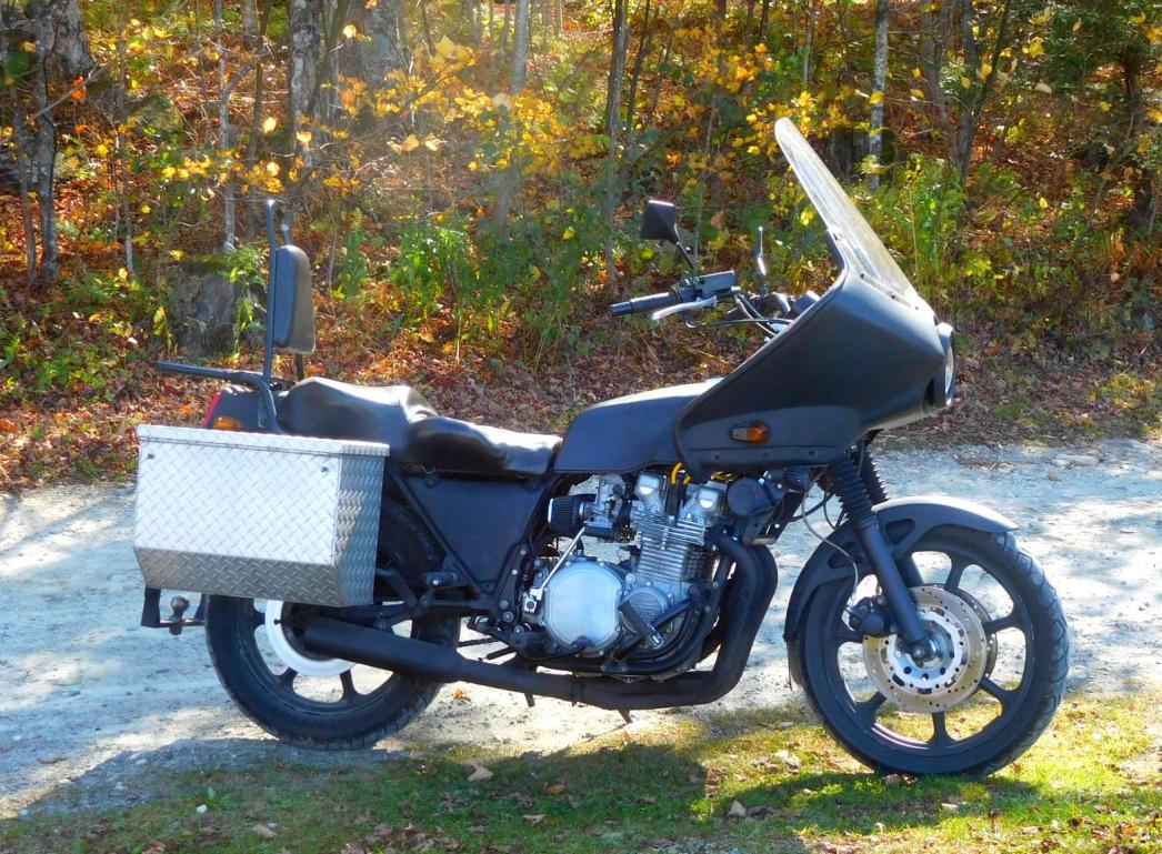

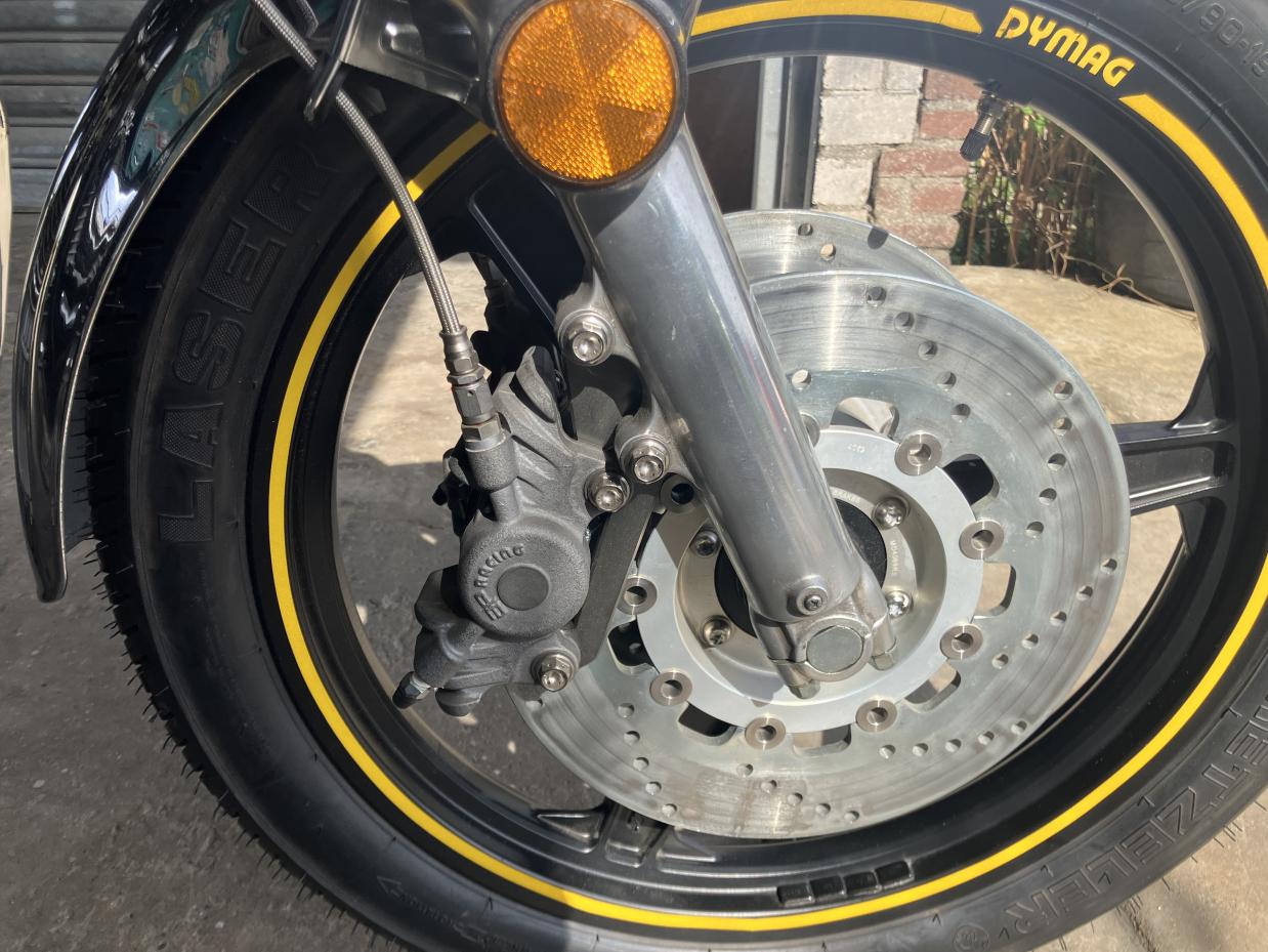

                        I know the EBC's are pricey but me and a pal of mine have been fitting them to all of our Kawasaki Z1/900's and Z1300's we owned. Even the oversized kits they sold in the past were spot-on as well.
                        Here's a pic from one of my Z1A's...

                          You can't go wrong with EBC rotors. Very high quality. I also run them on my Kwackers.
