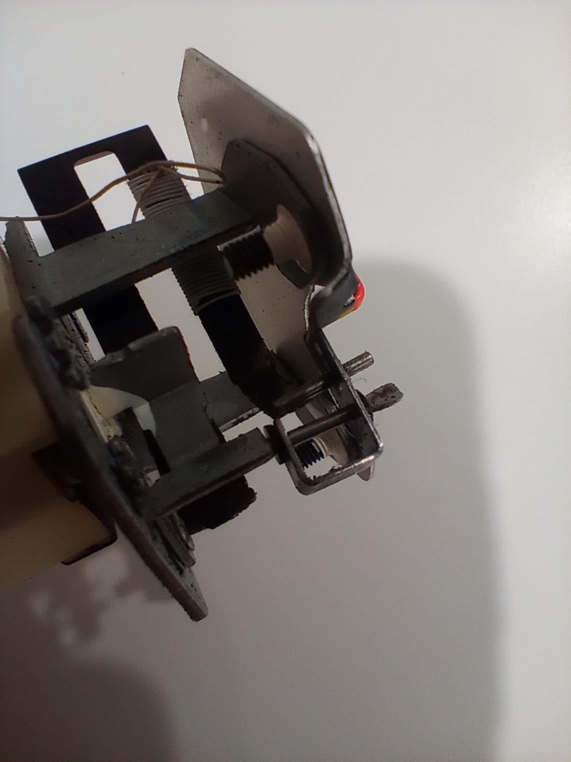

    Hi all- new to the forum & also just acquired a '79 1100E down here in New Zealand.
    Bike had been standing for around 4 years unused- basically a non runner. I have got it up & running & the first thing that jumped out at me was the fuel gauge which doesn't work. I checked out the tank sender unit with a multimeter & that is all good. Then checked the wiring up to the gauge itself which is also all good. Next obvious check was the gauge itself; stripped down the tacho unit & found that a part of the fuel gauge has become dislocated- there is also a broken strand which attaches to the coiled part. Is anyone able to guide me as to how the loose part fits onto the gauge- I'm struggling to work this out. To me it looks like there could be something missing as well- I suspect that the tacho unit has been opened prior to my ownership of the bike. Photos attached.
    Any help much appreciated

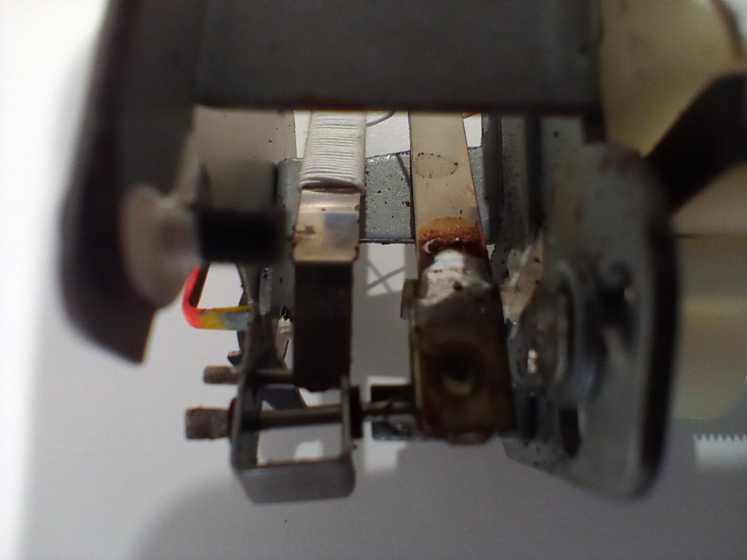

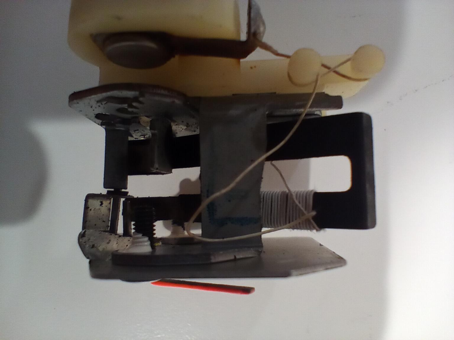

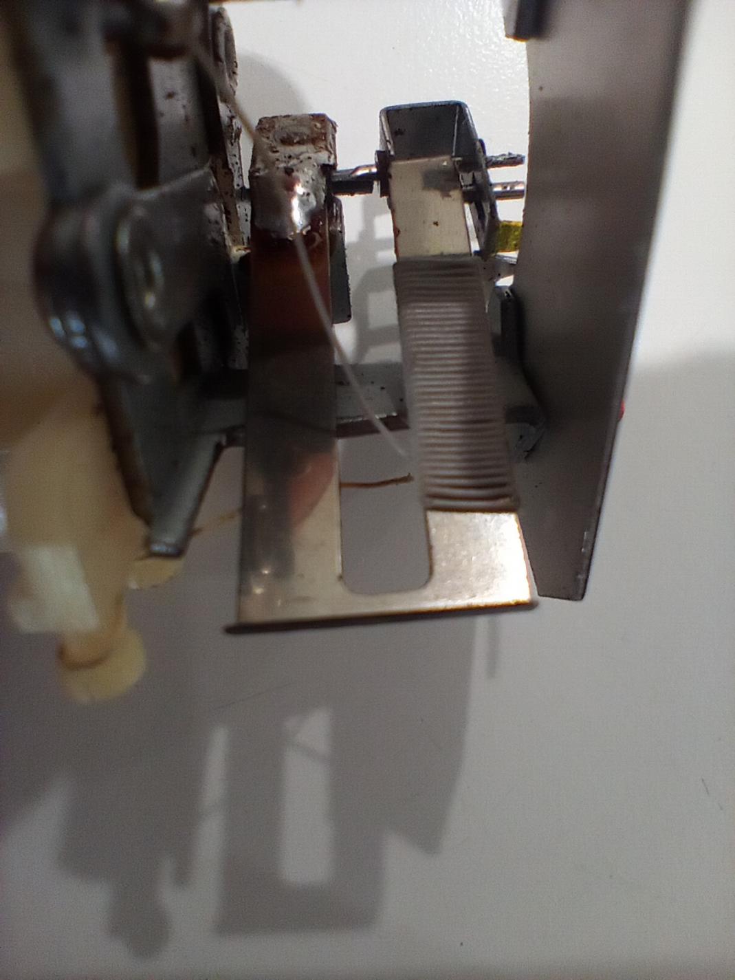

        Give me a day or two and I should have some pictures for you. I have guages here, just need the time to get one apart to take a photo or two.
          Here's some pics of one I repaired a while back...

            Now that is really helpful- many, many thanks. Clearly my unit has also snapped the tempered piece of metal like yours did- I will attempt to rejoin with solder like you've done. I just hope that I can solder the very fine strand of wire back to the wound section again. What happens to the other end of the tempered piece- does it rest against something or just stand free?

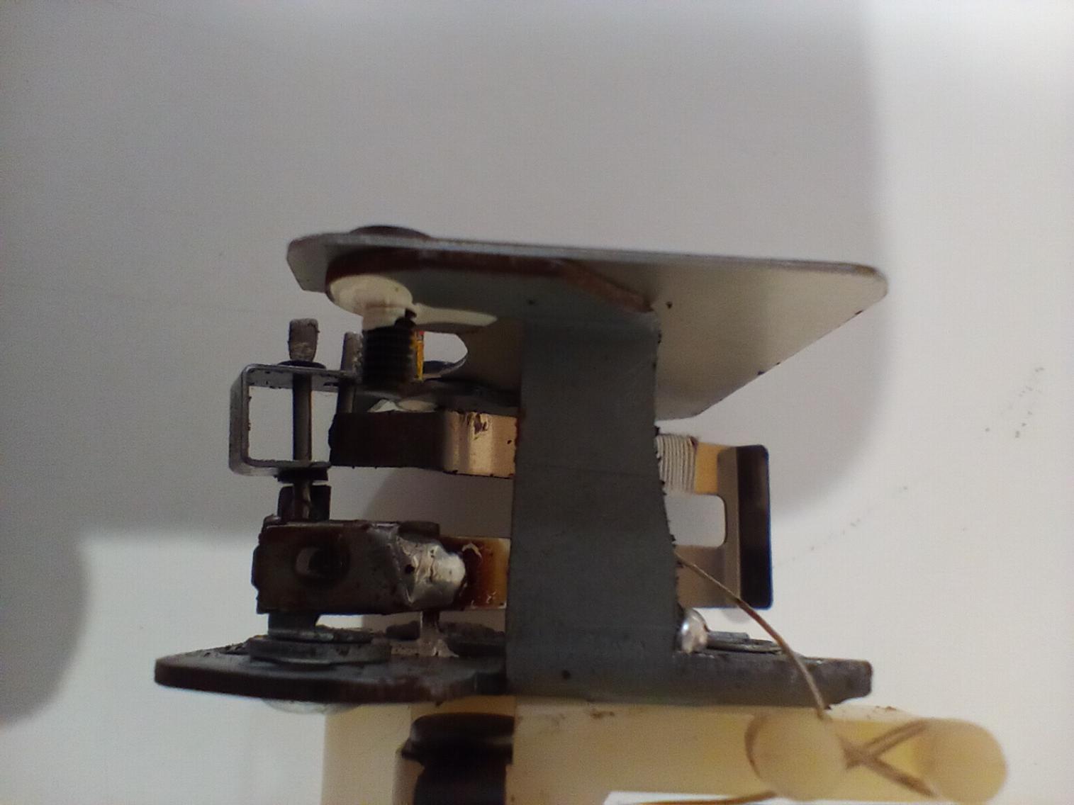

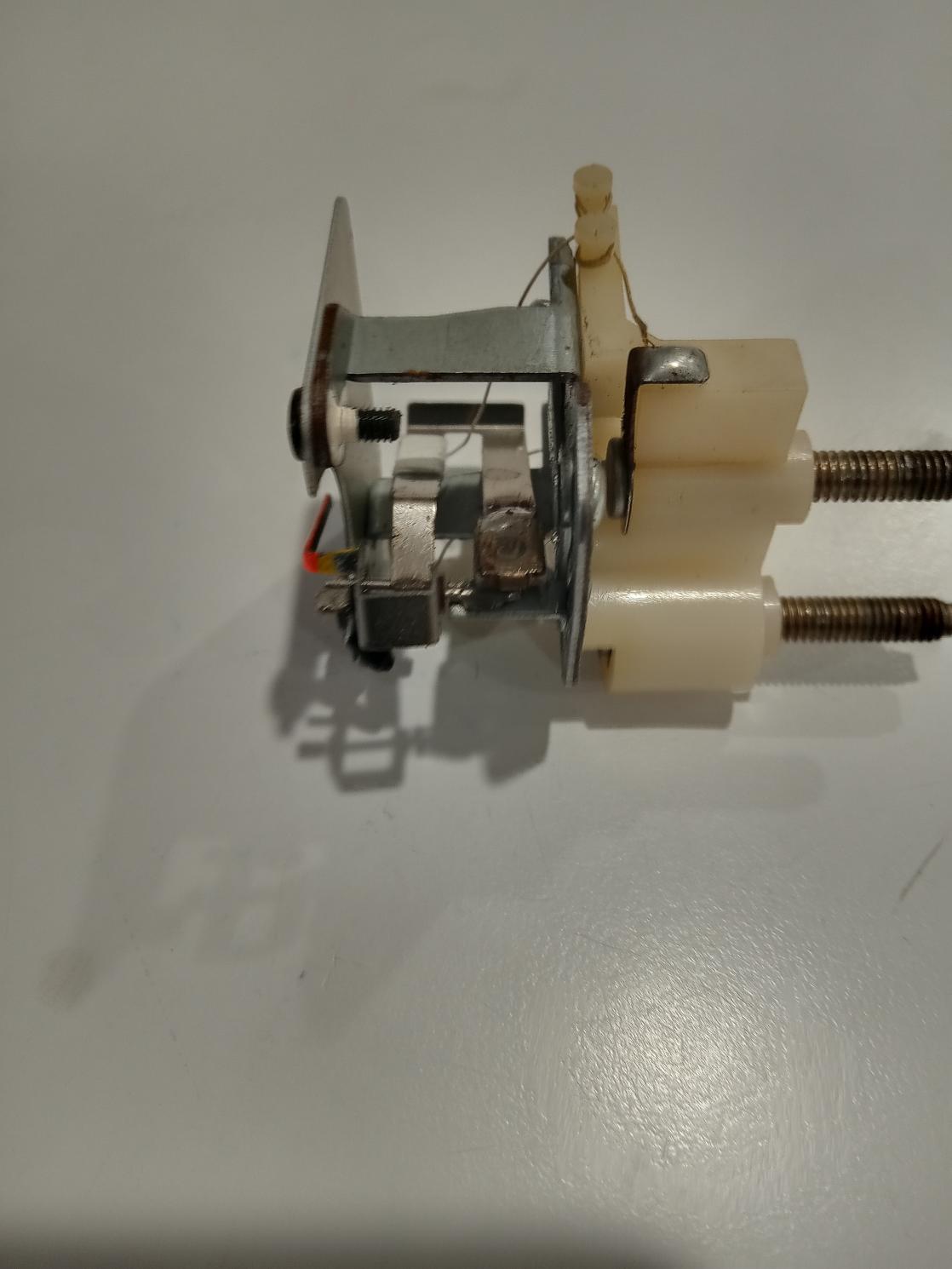

                Couple more pics...
                Click image for larger version  Name:	IMG_20240906_084900.jpg Views:	0 Size:	121.0 KB ID:	881475
                Click image for larger version  Name:	IMG_20240906_084943.jpg Views:	0 Size:	112.5 KB ID:	881476
                The other closed end of the bi-metal just floats. One leg has been soldered to repair and the other has a solid round piece spot welded to it that operates the needle itself.

                      ​​​​​​Thanks a million Phil- just what I needed to see
