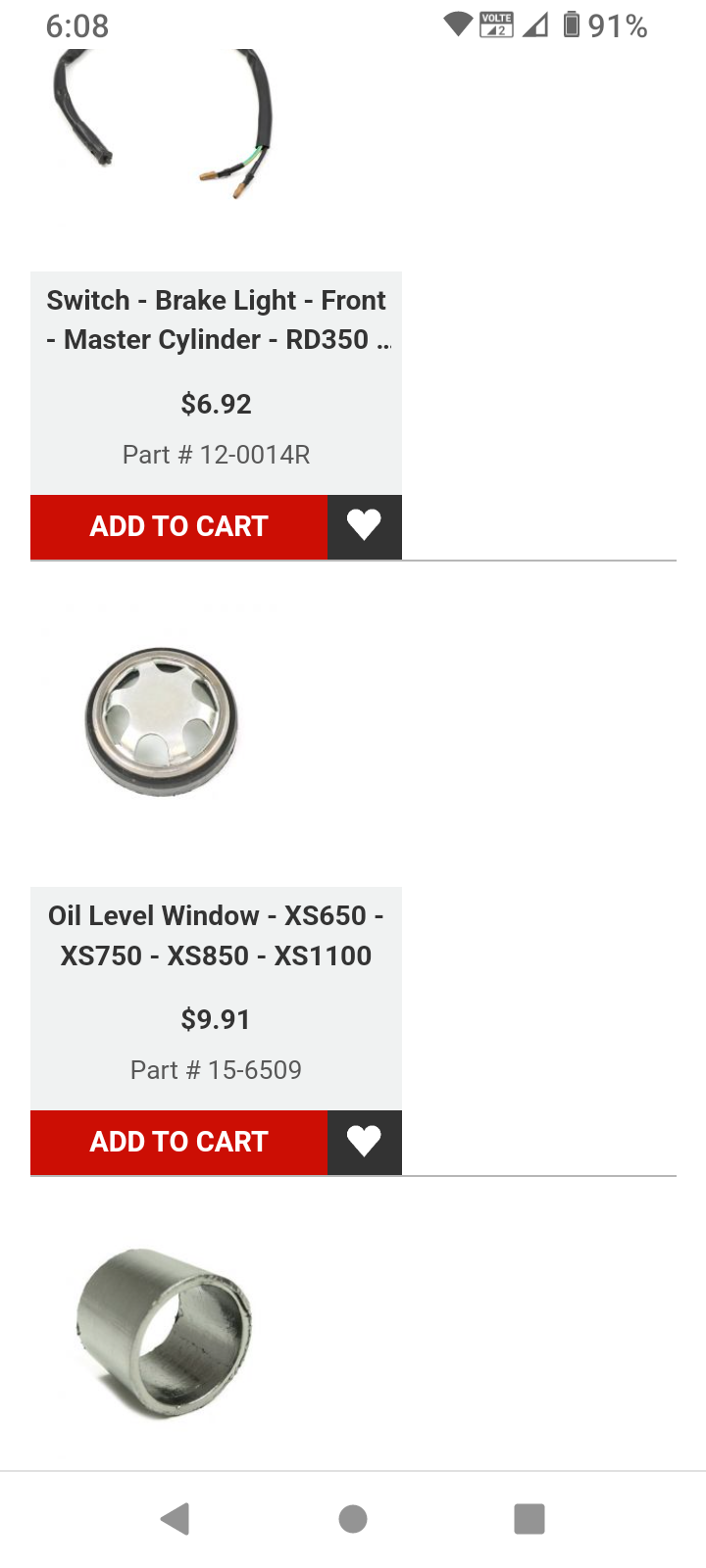

    There was a replacement available,2H7-15361-00-00 GAUGE, LEVEL. Not sure if it's still around, though. This is the early part number, and it probably changed.
      Nothing you can do really to stop it from leaking without removing the clutch cover. New one is less than $10 at MikesXS. You won't even have to drain the oil if you do the repair with the bike on the side stand.
      Click on image...
      Click image for larger version  Name:	Screenshot_20240808-180831.png Views:	0 Size:	175.3 KB ID:	881252

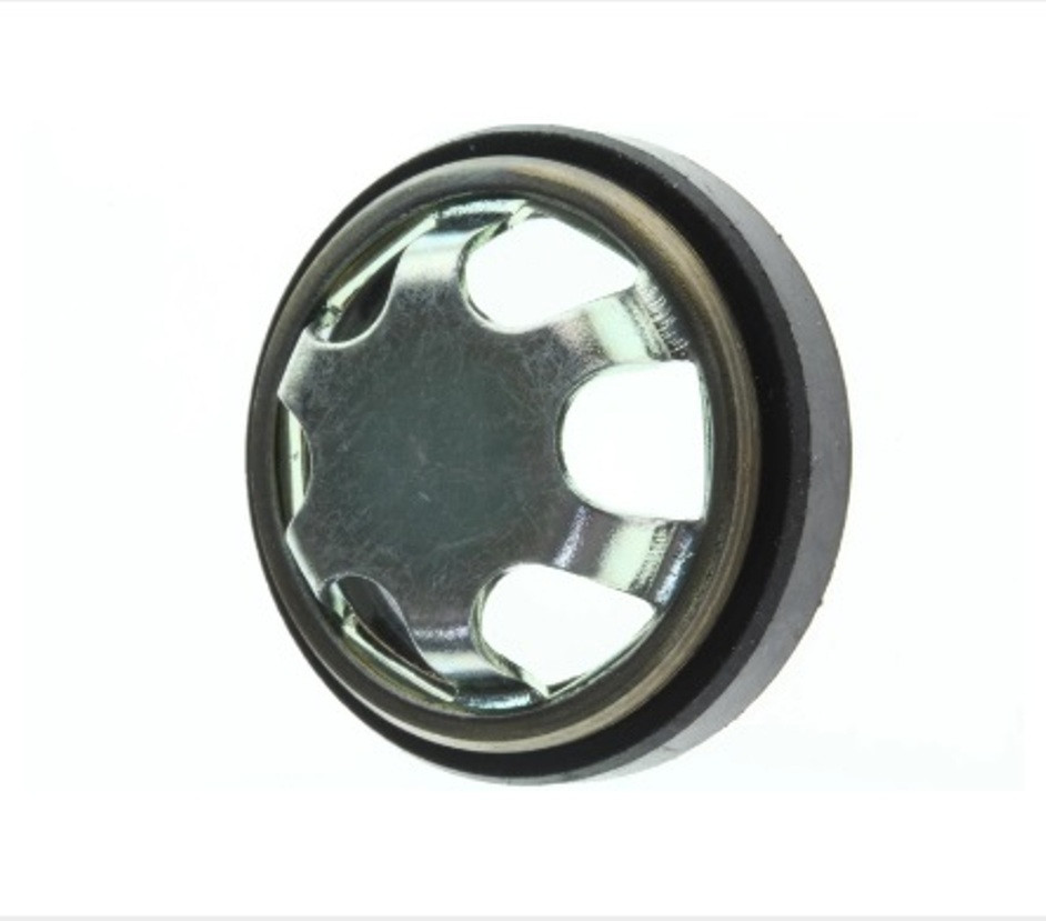

        Looks like you can heat up the cover and press it out & in with a proper socket. I like these for quick checking oil in the summer but they get cloudy and unreadable in the winter. I have to use a heat gun to clear the water vapor away just to check my oil when it gets really cold out.

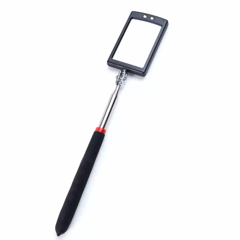

          Has anyone come across a better way to check their oil level than the sight glass? It's a real PITA trying to get mine into the center stand while fully loaded with gear and pulling a trailer!
          Deebs, there can't be much room on your sidecar rig to get down there for a look! Any suggestions?
            LAB3, very observant. I have to use an Ocean State Job Lot mirror and flashlight to see down there.
              Thanks! Something like that shouldn't be too hard to come by.
