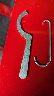

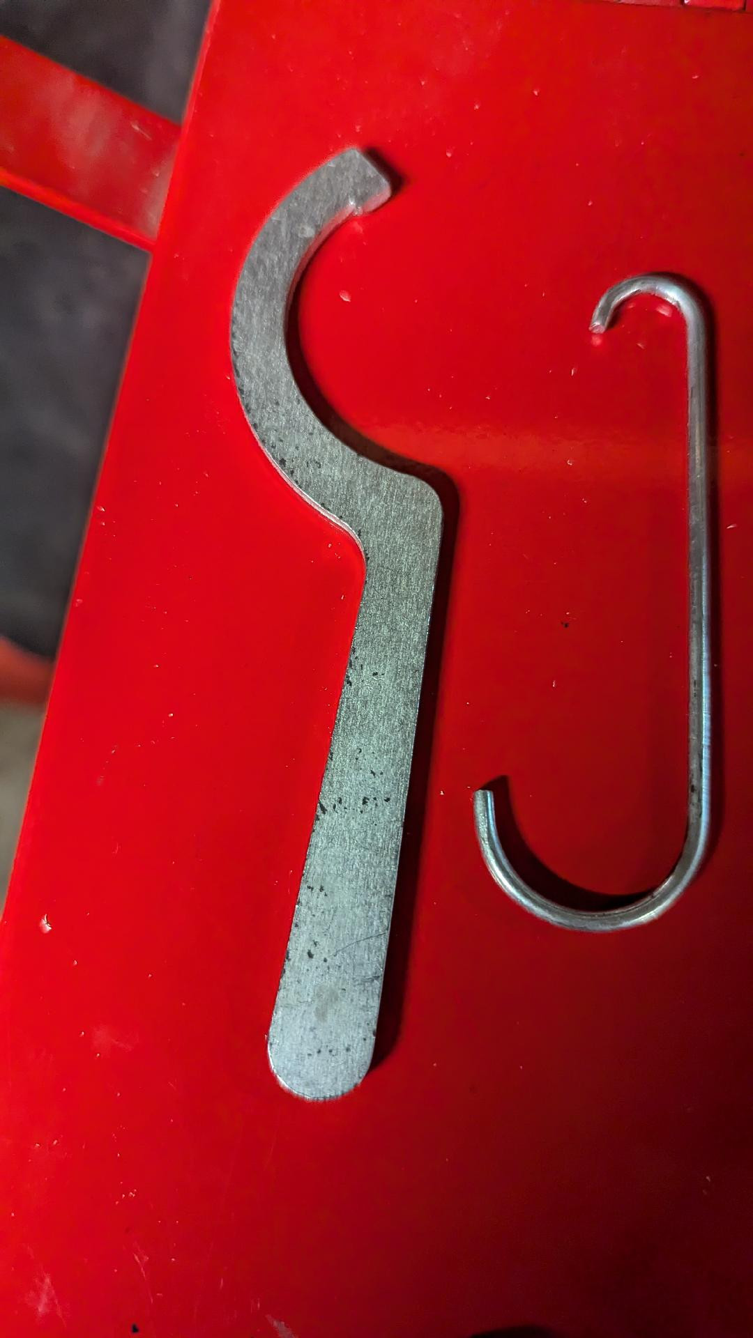

Thanks Ccitis. Only one of the kits had the shock adjusting tool that you have identified. A couple of the tool kits have the item on the right. It's a mystery to me too.Bob's Bikes:

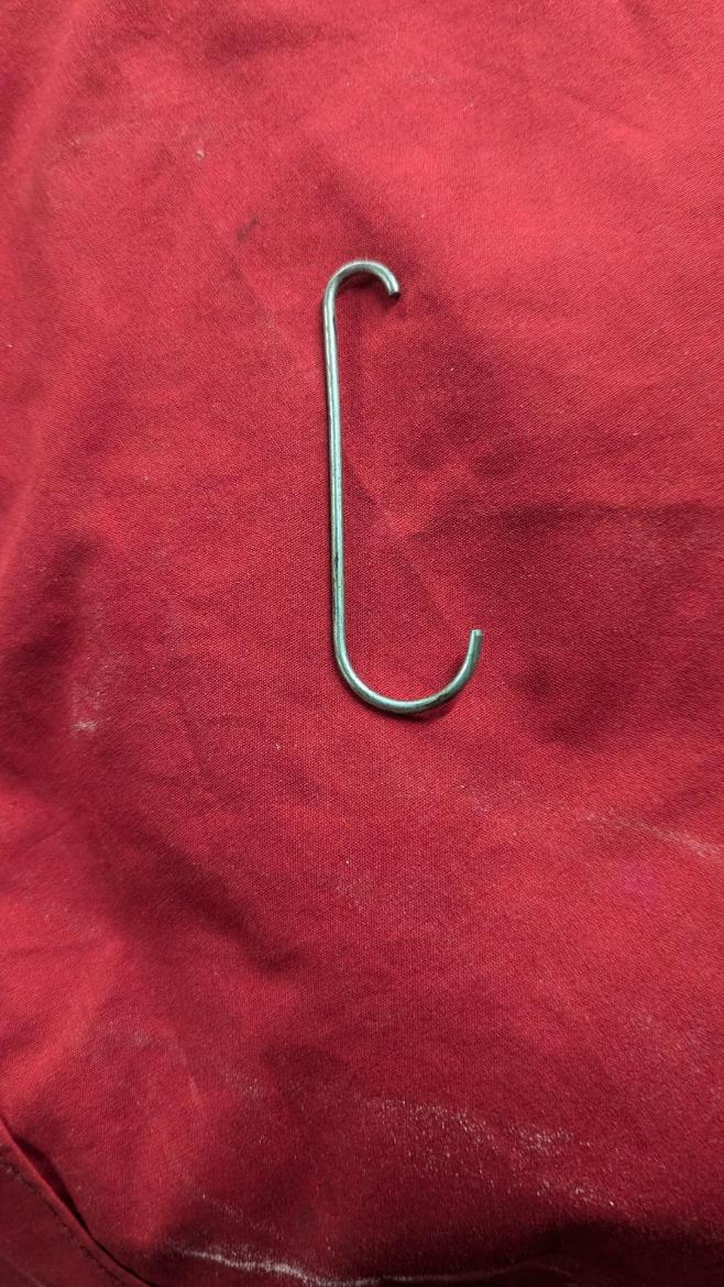

Thanks Guys,
I found that wire hook came with the special models...
but is not shown with the standard models that came with the cable and special tool for removing the rear axle.
So, at least I know it goes in the special tool kit, But what I haven't figured out is what the wire hook is used for. Not that I'll ever use it, just curious.
Any Guesses?

The shock adjustment spanner can also be used on the two ring type nuts on the steering stem.1980 XS1100G
