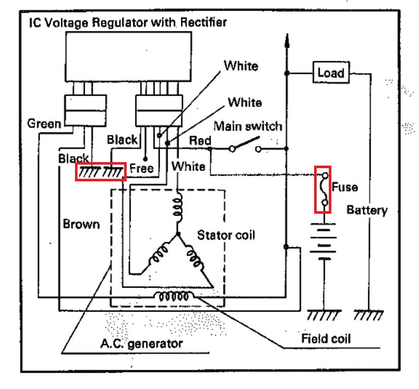

      A few easy areas to check that can cause problems.

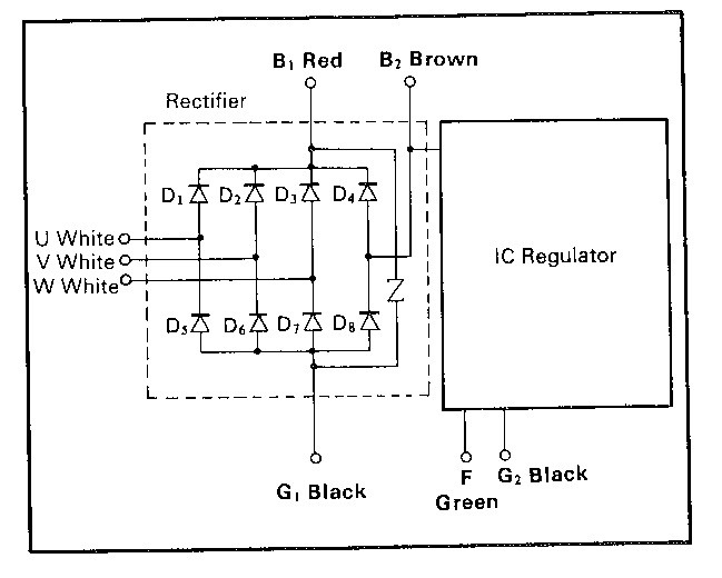

        More info:

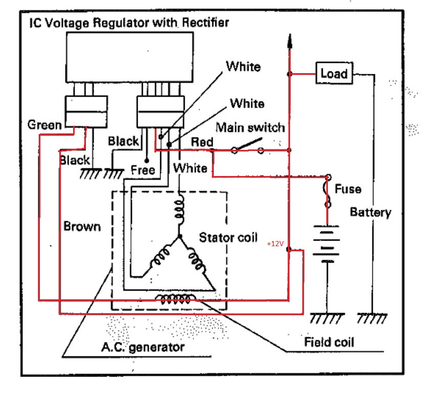

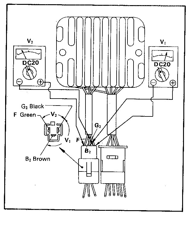

          Deebs, take a look at the wiring harness schematic and see if you see what I see. The field coil uses a positive lead from the harness (brown wire) and grounds itself through the green wire going to the R/R, I'm pretty sure what we're seeing here is is simple wiring mistake, the field isn't being excited. If that's the case there's no way the alternator can make power
            I agree that there is, more than likely, an error in wiring. Could be a component such as the regulator. Too many variables at this time. However, if you look at this diagram you can see the green wire gets its signal from the field coil. When the magnet rotates past the field it generates current which is the green wire input on the regulator. I suspect this is some sort of "enable" or "excite" portion of the regulator which only turns the unit on if it senses the motor spinning (Geezer could explain that better than me). I think the brown wire just powers the unit. The red wire is regulated output and is keeping the battery charged. The unit is grounded through the black wire (two actually).
            I work on a lot of late 70's early 80's Kawasaki's and they only have the three phase AC inputs (usually yellow), no field coil, and a ground and a 12v output (sometimes a brown wire that monitors the system voltage which might do the same thing as the field coil without all the hardware). You can measure AC on any of the three AC legs with the engine running to see if your regulator is bad. A simpler design.
Name:	Circuit brown wire.jpg

              So, I read some more. When running, the field coil generates a small voltage (about 1.7 Volts DC). This is between the green and black wire. Again, some sort of small "enable" signal when the engine spins.
              The only stator test is basically continuity. All three white legs should show continuity but must not be grounded. Same with the field coil - continuity but not grounded. No AC voltage checks. Very interesting but it makes it harder to diagnose with a volt meter.

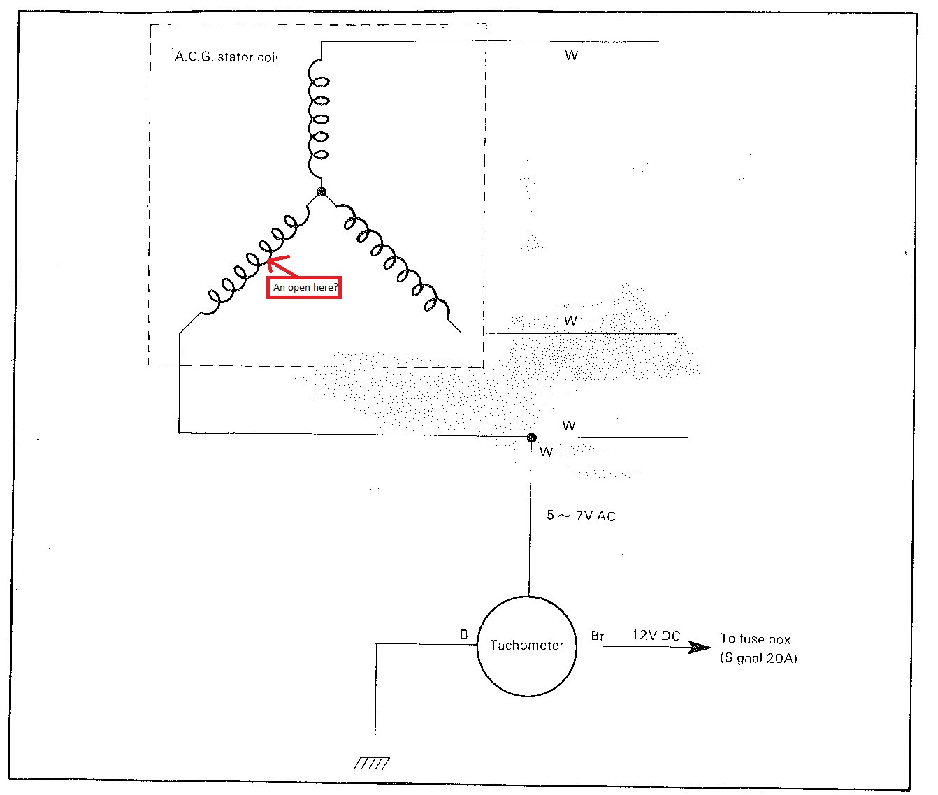

                This is a possible explanation why the tac does not work but it could also be a wire issue. Lots of testing to do. Should be able to find it.

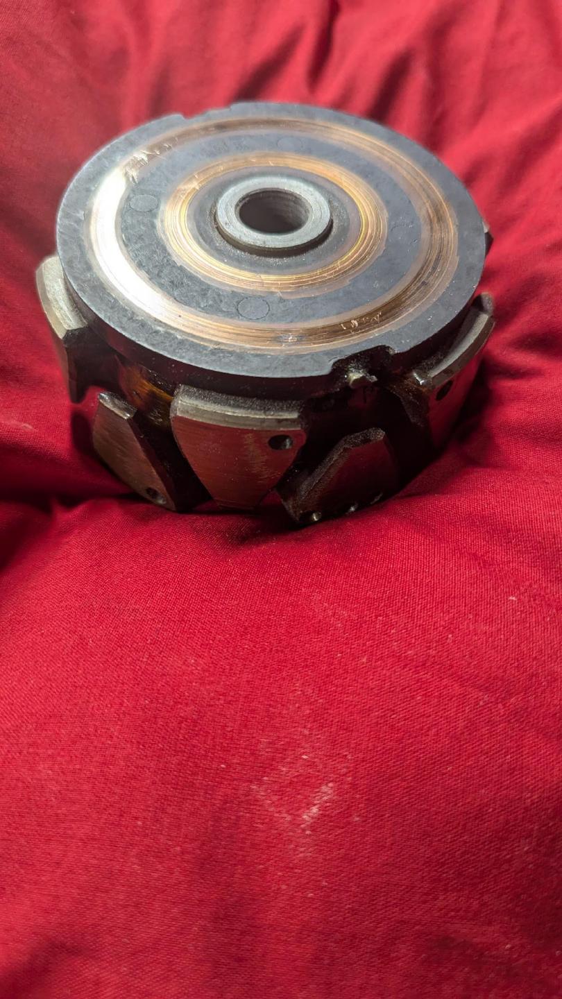

                    That's interesting. The green wire goes to ground to turn on the coil which turns magnetic. Does that mean the rotor does not actually have a magnet in it like a Kawasaki does?

                      The XS11 uses an electromagnet much the same way a car alternator does. Can't say I know FOR SURE how the Kaw works but every other bike I've owned uses permanent magnets. In a system such as the XS11 the power of the magnetic field is varied depending on how much energy the system requires, it's output is dynamic. In a permanent magnet alternator you're always making the same amount of power, RPM dependent of course. The R/R in that case must dump that unused power somewhere. The XS11 charging system IS more complex and I'm assuming costs more to build not to mention taking up more precious space on the bike BUT is far more robust and runs cooler since it only makes the power it needs negating the need to dump the unused energy back out of the system
                      The XS11 tach rather curiously counts it's revs off the output of the stator windings, it makes sense that if if the electromagnets are not creating a magnetic field then there are no pulses to count.

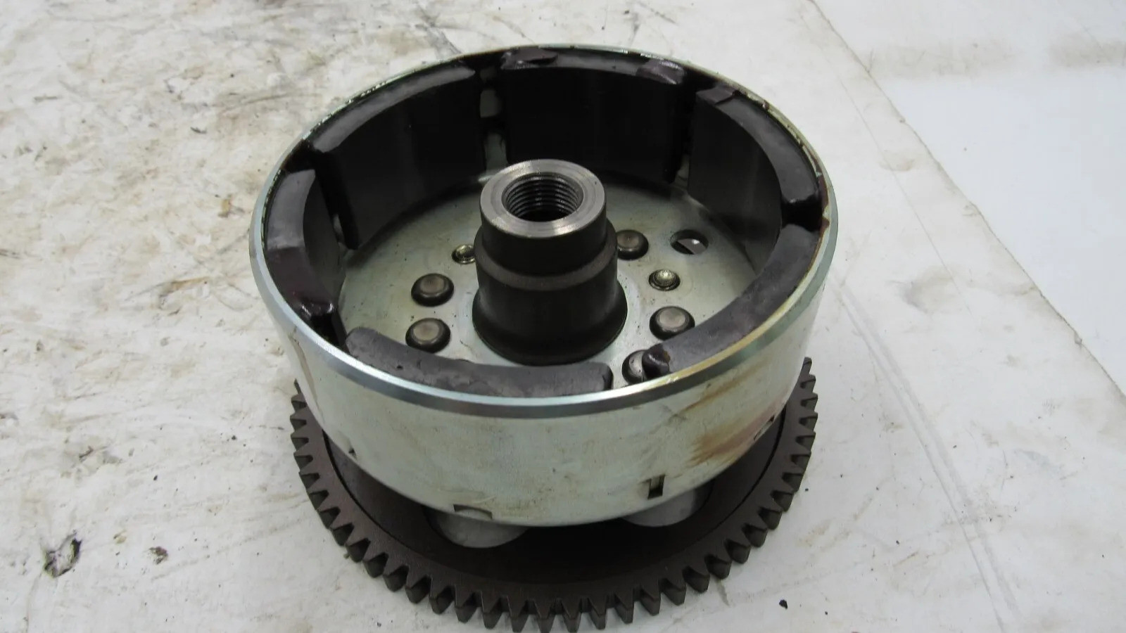

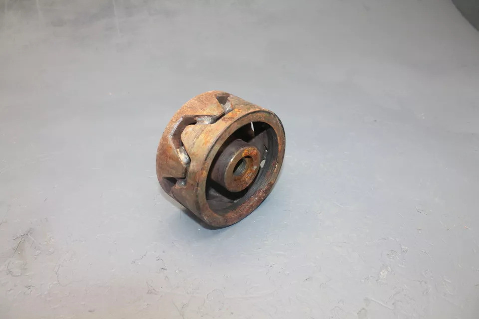

                          That's correct Deebs, No magnets Click image for larger version
                            By the way, I had a bad rotor on an xs650 which resulted in not charging. I think was a fairly common failure on the 650s. I believe they used inadequate windings. But I haven't seen an xs1100 rotor go bad.
