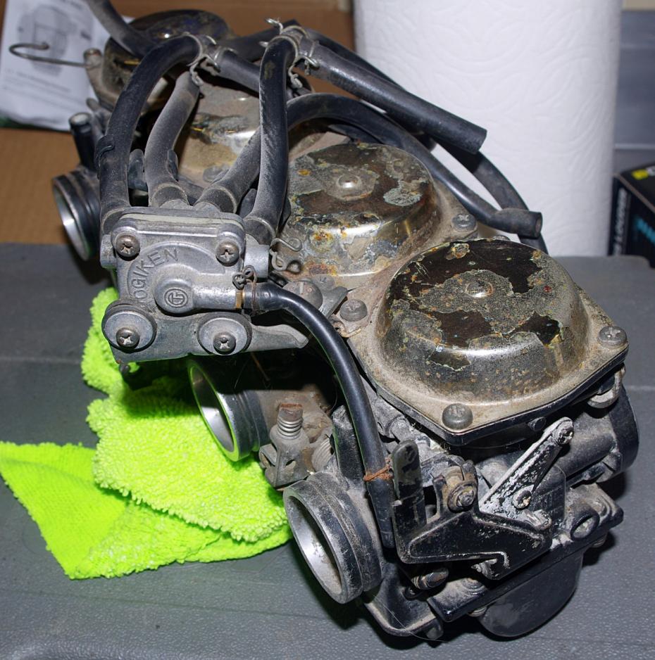

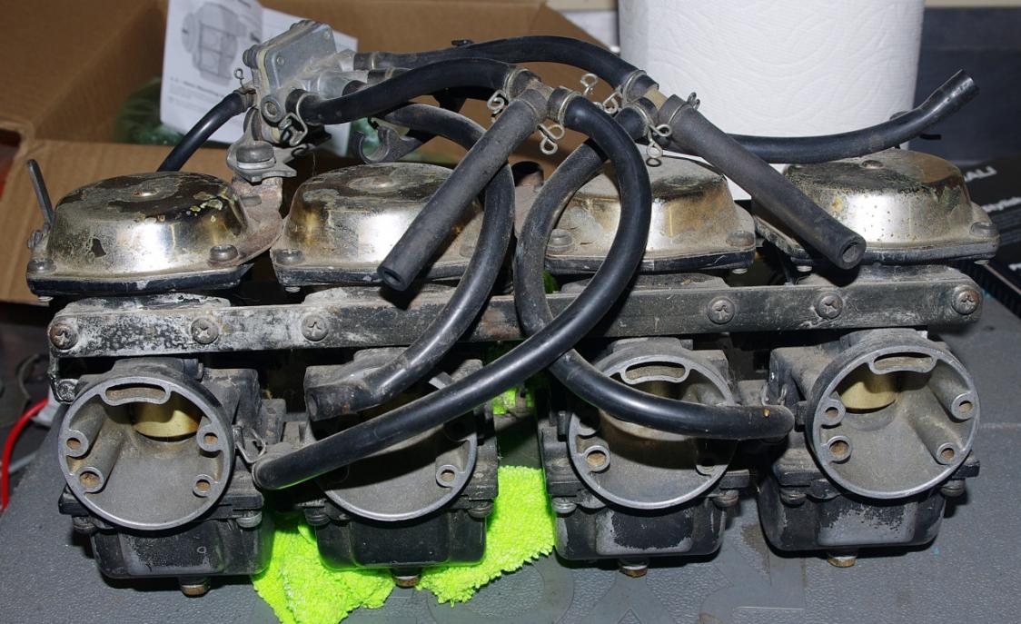

        Let me try this. It's a MNS carb set, stock, with the octy in the stock location. Click image for larger version  Name:	Carb2r.JPG Views:	0 Size:	142.1 KB ID:	880341 Click image for larger version  Name:	Carb3r.JPG Views:	0 Size:	131.3 KB ID:	880342Note that the MNS has the mount bracket for the octy! The Specials have one of the three brackets for the carbs that does have the mount position on it.

          PERFECT! Thanks so much! I actually have one of those curved brackets in a random parts batch I got off eBay! Didn't even think about using that.

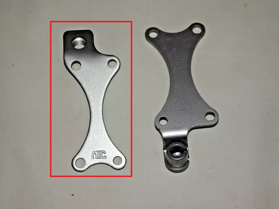

              You will need this bracket as shown in Rays picture.
              https://www.ebay.com/itm/27646429388...Condition=3000

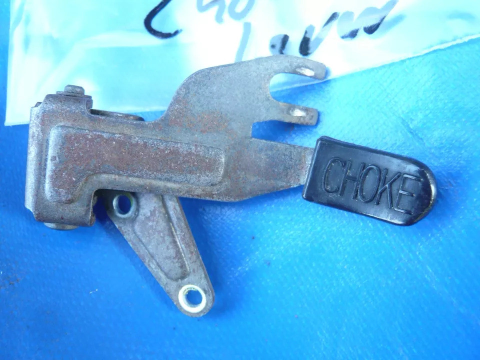

                  Ah yeah the bracket I had was just another throttle cable holder. Thanks for the eBay link, I ordered that bracket, all I have left to do with the carbs now is weld on a choke lever, then they can go back on the bike!
                    Not sure if this will fit your carbs.
                    https://www.ebay.com/itm/32475922227...Bk9SR_ryjMOIZA

                      It looks the same, but I can weld up my broken one for free :P
                        Free is good.
                          Like me? "I have a TIG welder and I'm not afraid to use it!"
