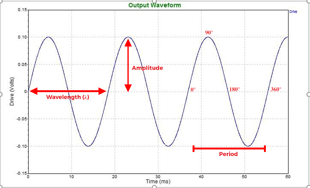

            Yeah, I had thought that as well. I'm imagining the battery adds stability.
              • 2069
              It absolutely adds stability. Positive and negative are the reference points of the signal wave. If they are off or unstable (changing) the coordinates will be off.
