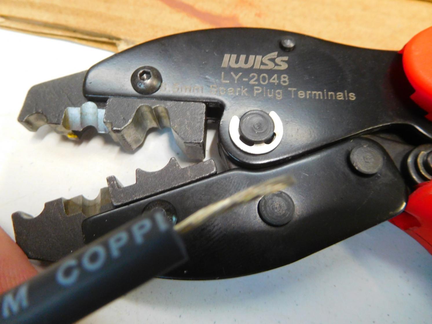

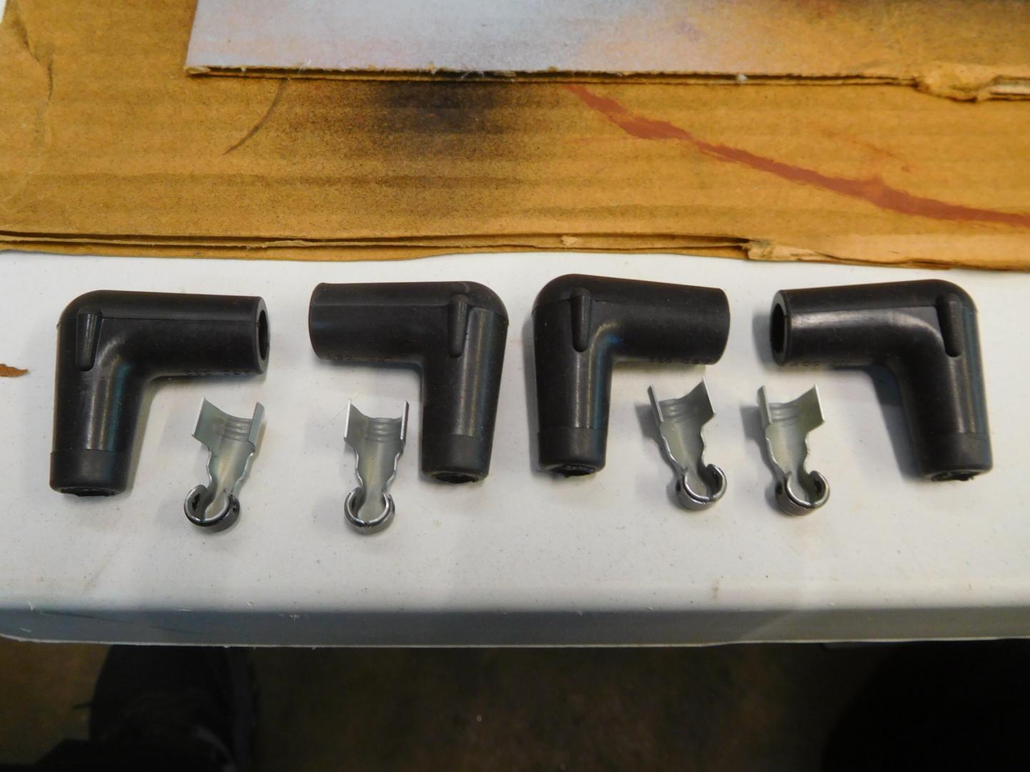

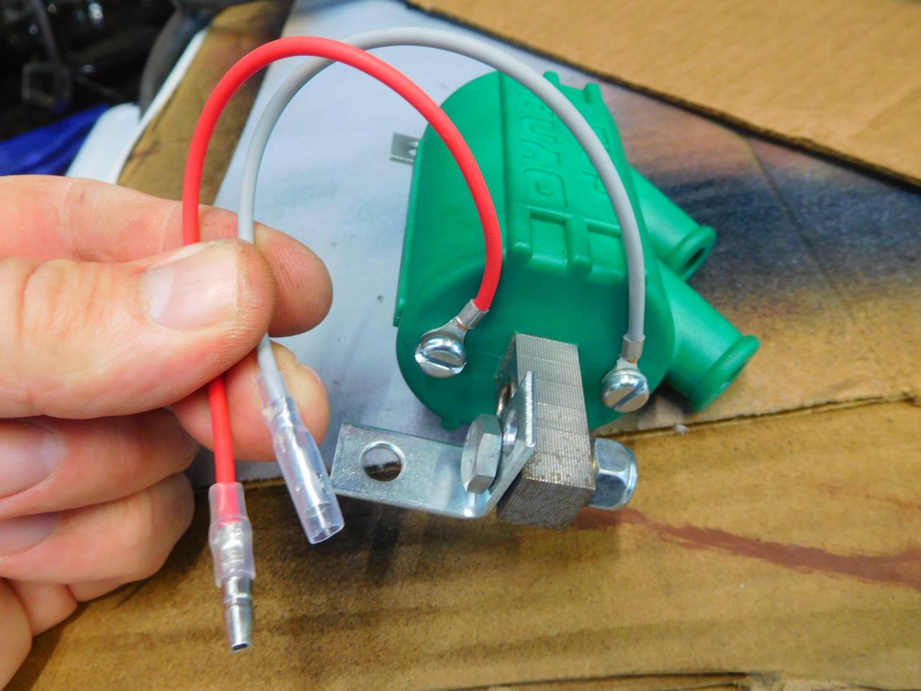

                          Just for reference, I run Dyna 3 ohm coils with non resistive caps and plugs. Tach is smooth.
ID:	879803 Click image for larger version
ID:	879804 Click image for larger version
